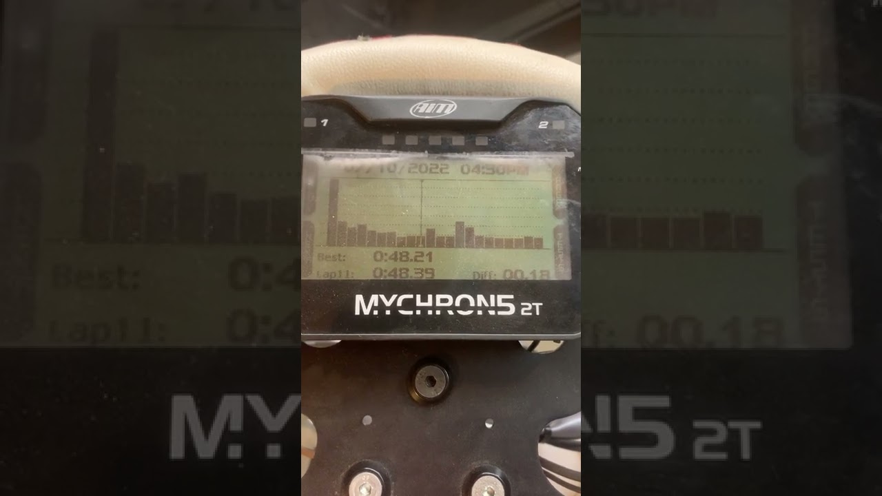

A couple other data points to consider:
  • my quickest lap was on lap 20/23
  • I was lapping within a tenth of my quickest lap beginning on lap 9
  • Lap times were very consistent aside from laps 15 and 16…another kart slowed on lap 15 causing me to have to go into the marbles exiting the last corner. This basically grenaded two laps at once, as it took me four corners to scrub the crap off my tires
Here’s a look at my Mychron from the main:
EDIT: here’s a quick scroll through the lap times:
Cmon man, 8/100th spread? Can you tighten that up a bit? :relaxed:
@Bimodal_Rocket - the problem wasn’t consistency, it’s that I was consistently SLOW :joy:
You are as quick as Norberg adjusted for age, weight, height and skill. Most likely. One way to look at it.
