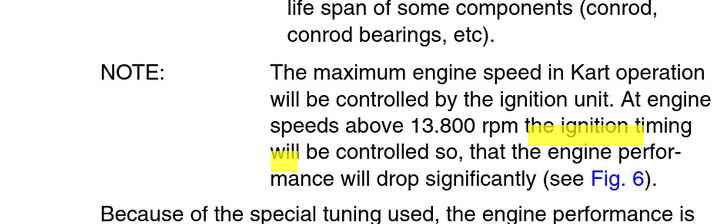

There’s no rev limiter on a Rotax. It just falls flat on its face past 13800 RPM.

I thought the Rotax had a soft-limiter? On the prevo at least
