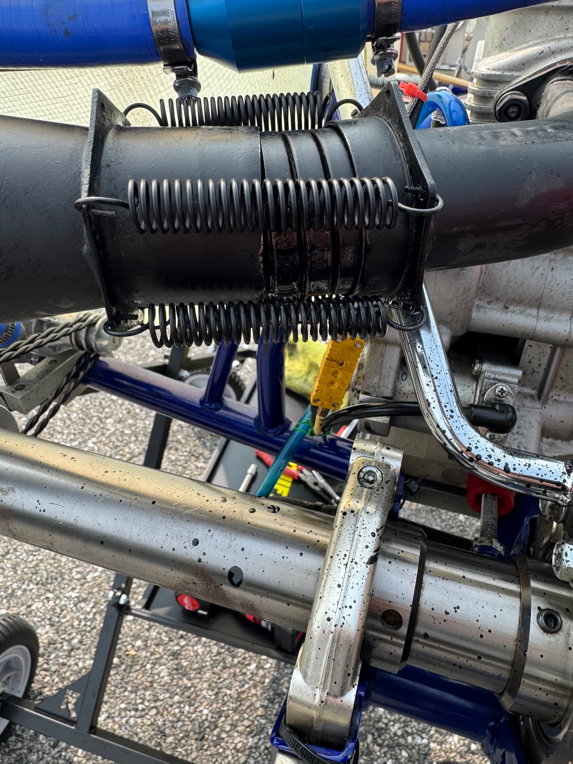

Fuel/Oil dripping out of X30 old-style exhaust flex (n00b kart owner)
Kart owner n00b here. X30 old style. Engine had top end rebuilt just before I got it. First time running as owner / own mechanic. I’ve tuned EFIs before, but never carbs. MyChron is 1T and I had it monitoring water for first shakedown runs.

I had it running on the stand for about 5 min on and off dialing in the idle screw. Then we noticed the spew. I pulled the spark plug and it was wet.
I was concerned I’d be spewing onto the track and fellow drivers, so I asked a few experienced X30 guys who graciously took time to look at it. They told me my engine was fine, that this is somewhat expected at idle, to get some flex insulation to keep it contained, but wipe it down and then just run it.
On track, not smoking. Ran great on top, a little throttle delay out of some corners, so I think low speed needs to be leaned, at least.

Totally normal, especially when just idling on the stand. It is a race engine, it was to scream at high RPM, and should be tuned for that. The excess oil will burn off when you’re under load. It’s fine to let it run at low RPM on the stand to warm it up, you just have some excess oil from the exhaust then. Not going to hurt anything, other than make a little mess.
Wrap the flex area and that’ll solve like 99% of the oil spewing. But yeah, without that wrapped it’d going to coat the whole back of the kart, and that’s pretty typical.
And note that as a race engine, it shouldn’t really be set up to idle without some throttle input. It might a little; every engine is a bit different, but generally it should need a bit of throttle to stay running. Idle isn’t a concern, mixture at 16k RPM is the the main thing to consider.

The goop coming out is pretty normal as a lot of raw fuel (with oil of course) escapes out the exhaust port at idle and small load.
Once the engine is in its operating range, the expansion chamber in the pipe helps keep this charge in the cylinder more effectively.
Same with the spark plug, they are very cold plugs (NGK 9,10 and sometimes 11) and will foul easily if the engine is not run hard enough to get them into self-cleaning temperature range. Roughly 500C
