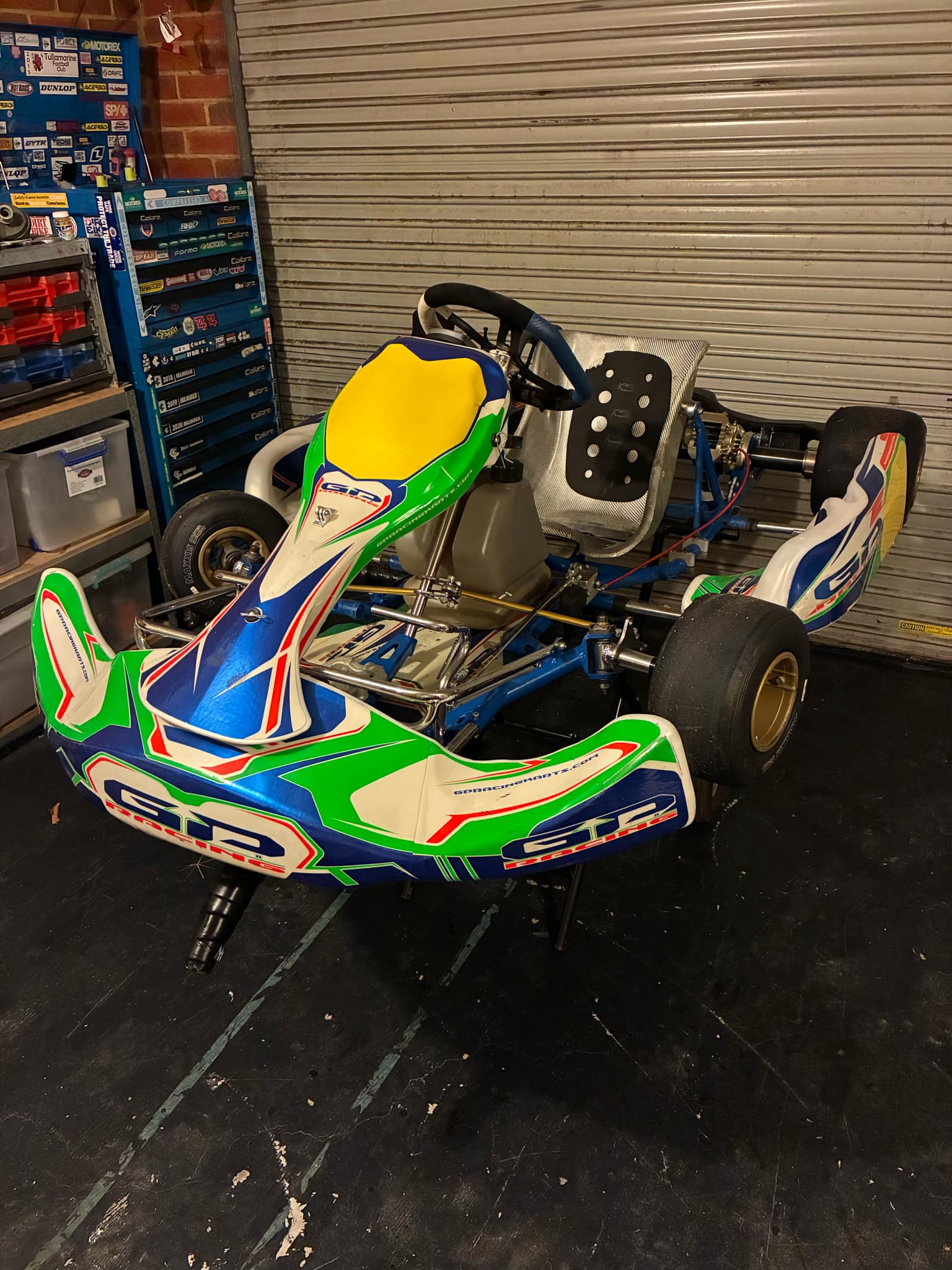

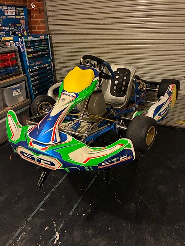

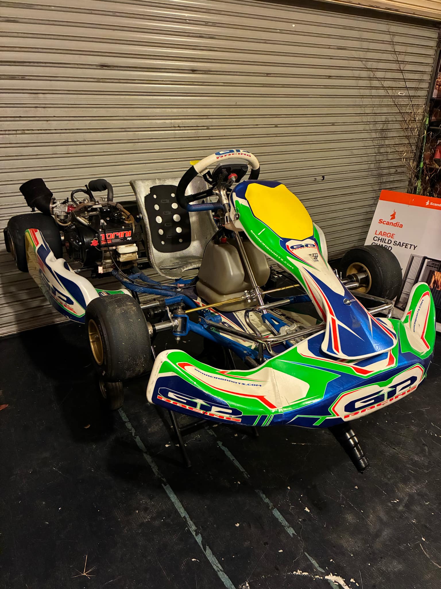

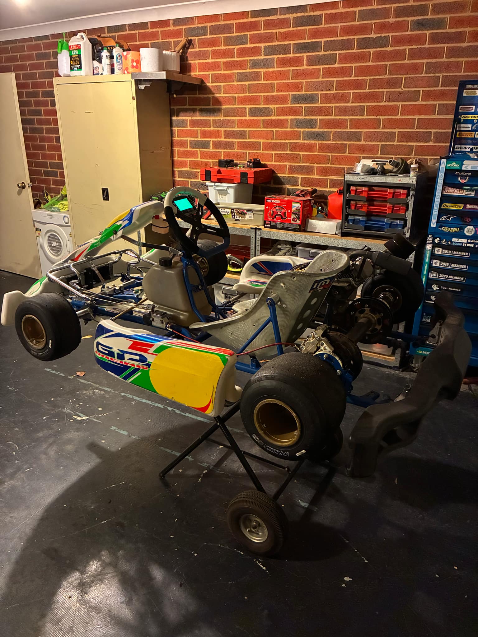

I’m looking at purchasing a local GP Racing kart here in Australia but are struggling find information online about it. I tried contacting GP Racing karts directly but have had no reply as yet.
Are they a good kart? I’m told but can’t confirm that they are made by CRG and share parts with them? Are parts readily available for them?
If anyone could give me any information about it, it would be much appreciated.

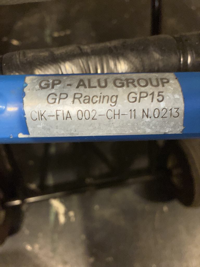

I race with GP Karts USA. The GP chassis is manufactured at CRG, and shares nearly all of the same components. The GP15 pictured is the same design as the current homologation. This chassis pictured is a few years old, as evidenced by the bodywork and rear cassettes.
As with any used chassis, I would try to learn as much about the condition of the chassis as possible.
Says GP15 right there on the homologation tag.
Thanks. I was trying to find out the age of the kart along with tubing size and axle size etc.
There doesn’t seem to be many GP Racing karts here in Australia and I didn’t want to buy something I wasn’t going to be able to get parts for if I damaged something.
Should be an all 30mm chassis, and the axle is 50mm. The standard axle is usually marked “H” which is the same as the CRG M20…don’t even get me started on the CRG axle nomenclature :joy:
