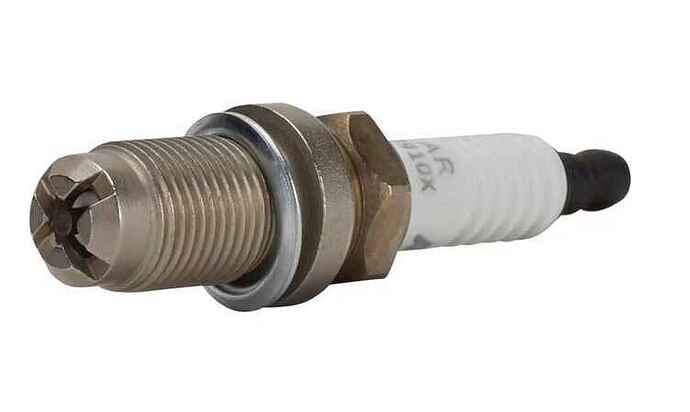

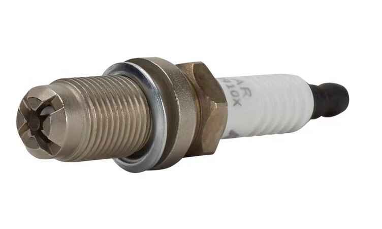

You dont want to use the onboard tach anyway. The driver can set a max RPM read out on their tach and then you would never know if they were cheating. I used to set mine at 6000 back in my nefarious days. To tech properly, you hook up your own tach and then rev the engine up. At national events in the past, this was done on the stand post-race. It should be spot checked pre-race too.
Off in the weeds:
The pre-race check is important because the rev limiter was often cheated by reducing spark plug gap so much that it would spark even when it was supposed to be limited by the coil. This would allow you to rev up past the rev limiter. The problem with only checking post race is that often times through the course of the race ,the spark plug gap would burn up and open up enough to cause the limiter to work again. Then, voila, you pass post race tech.
That’s interesting to know about the spark plug gap. I have never had it checked per-race.
I’m a big supporter of tech inspections. We work very hard to keep competitive on a reasonable budget and anything done to keep it from becoming a full blown battle of the wallets is important to me.
I’m more than happy to buy a new head gasket 3 or 4 times a year.
If your club is using the Briggs ruleset, there is no gap in the plug. They switched to a new plug a few years back because of this cheating.
If you don’t think it can be done on this plug, I got some ocean front property in Arizona for you. The switch to this plug had nothing to do with the gap trick. It had to do with the resistor style trick of the older plug.
It’s actually easier to do on this plug and often accidentally happens when they get damaged in shipping/handling. I’ve put a few new ones in that rev to the moon.
To be clear, I am not condoning this behavior. I’m saying tech person can check plugs before and after to prevent cheating.
