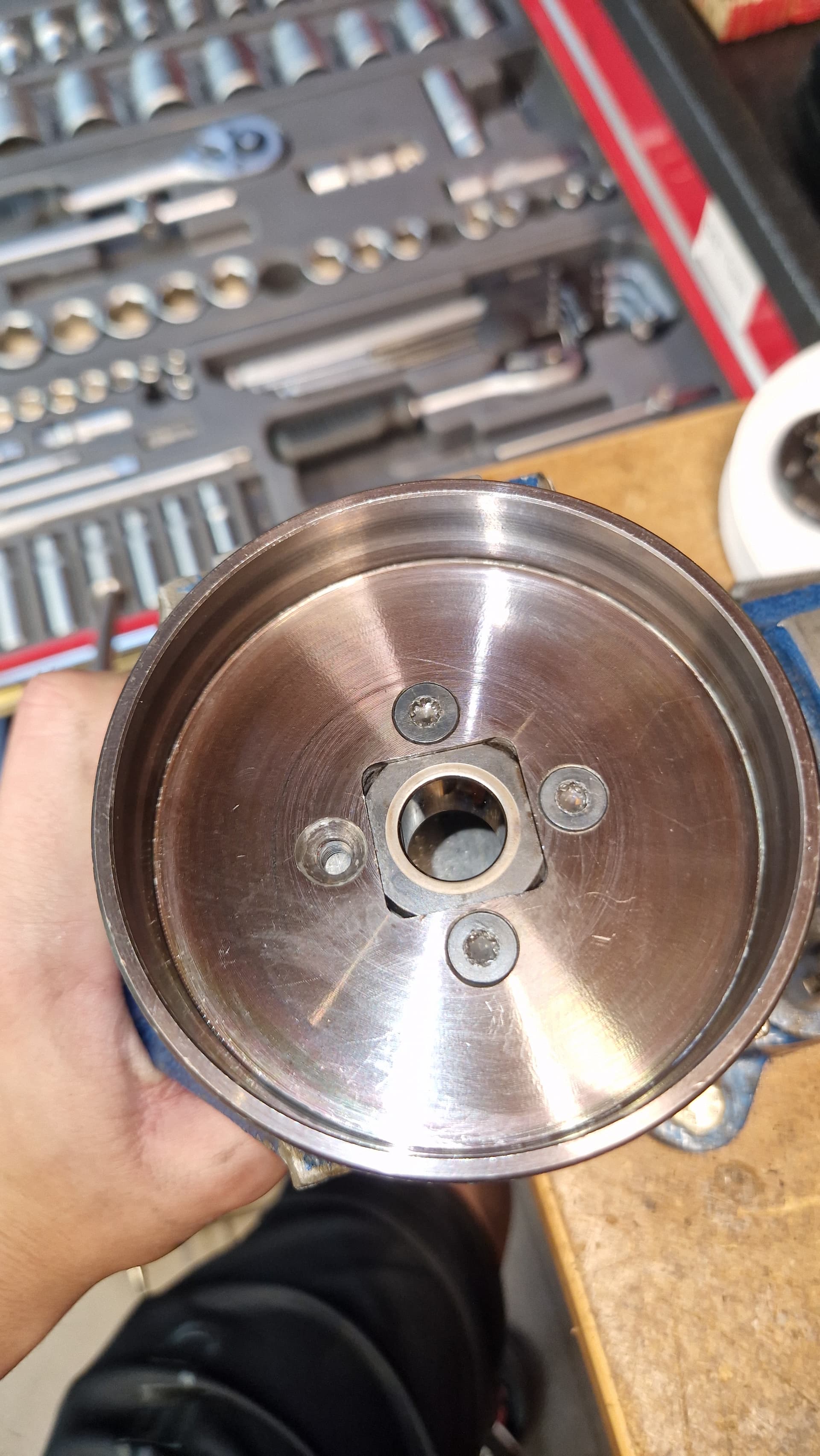

Well another problem, some donkey destroyed the torx pn the front sprocket…
How do i get it out?
Safe way without ruining everything
With a stud extractor (cobalt drill to pilot). Carefully.
Is there any other way? I need to be done by tmrw and i dont have a stud extruder
There are a couple of different ways. You could drill out the heads and hope there is enough of the bolt remaining to grab with pliers and unscrew them. I recommend putting a torch to the sprocket side of the screws to help release any thread locker that was likely used. Another option after torching them is to use a small chisel coming in at as shallow an angle as possible on one side of the exposed hole and try to rotate the screw out.
This guys has some good techniques:
ok so the bit is a t25 i heated it up, and took a old t25 and hammerd it in the torx took the ugga dugga and it came loose, Im sending the customer a good pait of used screws just bc

A mechanical impact screw-driver is a useful tool in this situation.
As you hit the driver with a hammer to create the torque, you simultaneously force the driver bit hard into the screw as well, lessening chances of slippage
Just drill them out, if they aren’t loose after the torque is gone there will be enough thread to grab with pliers. Drill size isn’t critical, just drill through the counter sunk part and it will come off.
