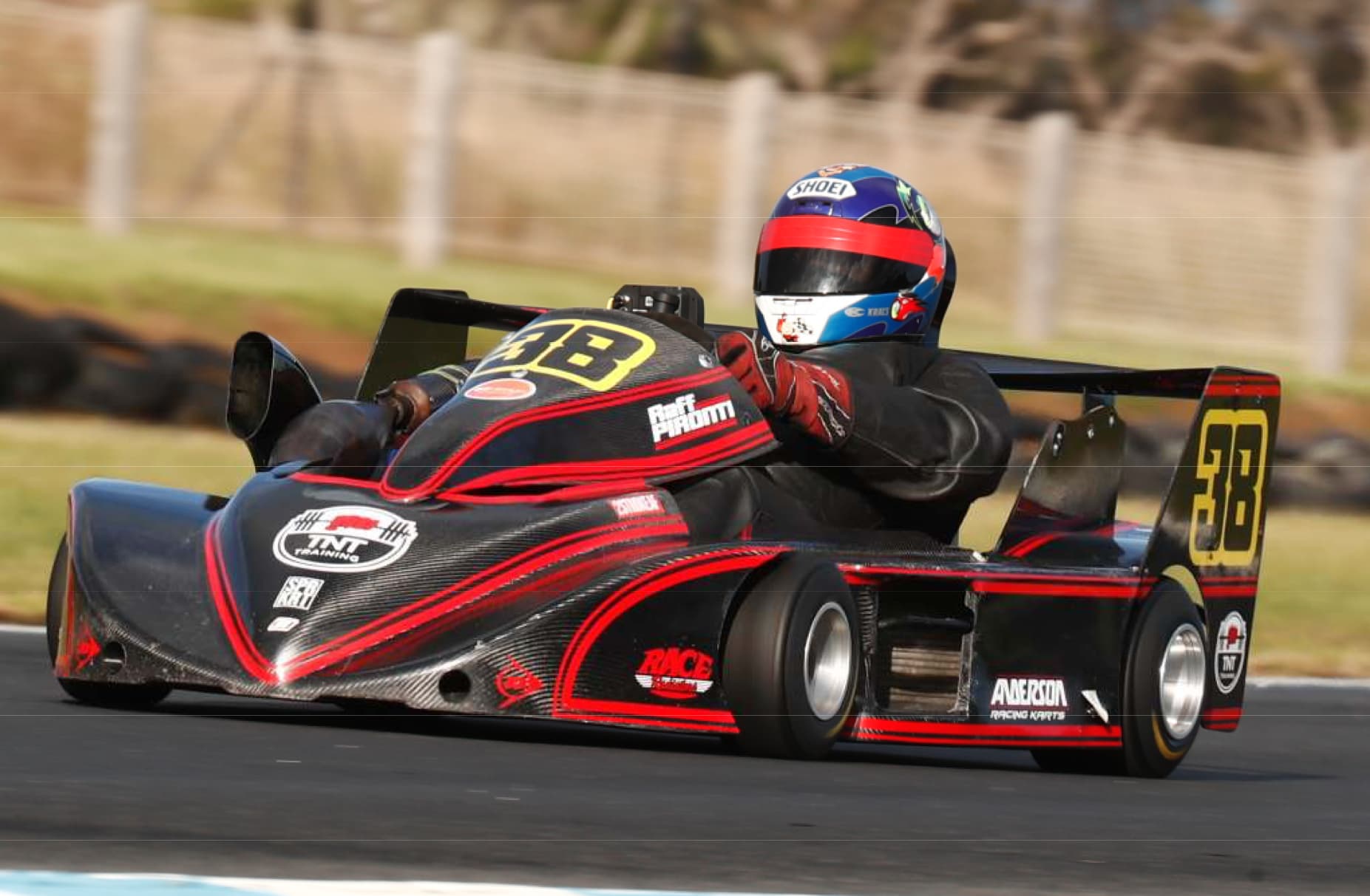

One of my Superkart colleagues in his 250 (I think this is his International rather than National, but he has both). They still in general use a mechanical stick shift but there are some examples of electronic paddles (which are allowed under our open class rules, just rare). Six inch tyres, not five. When I’m doing just over 110 mph down the main straight at Phillip Island in my Stock Honda and these guys go past me as if I’m standing still, it does give you some read on just how insane they are (kart and driver). As for their cornering abilities, another world.
