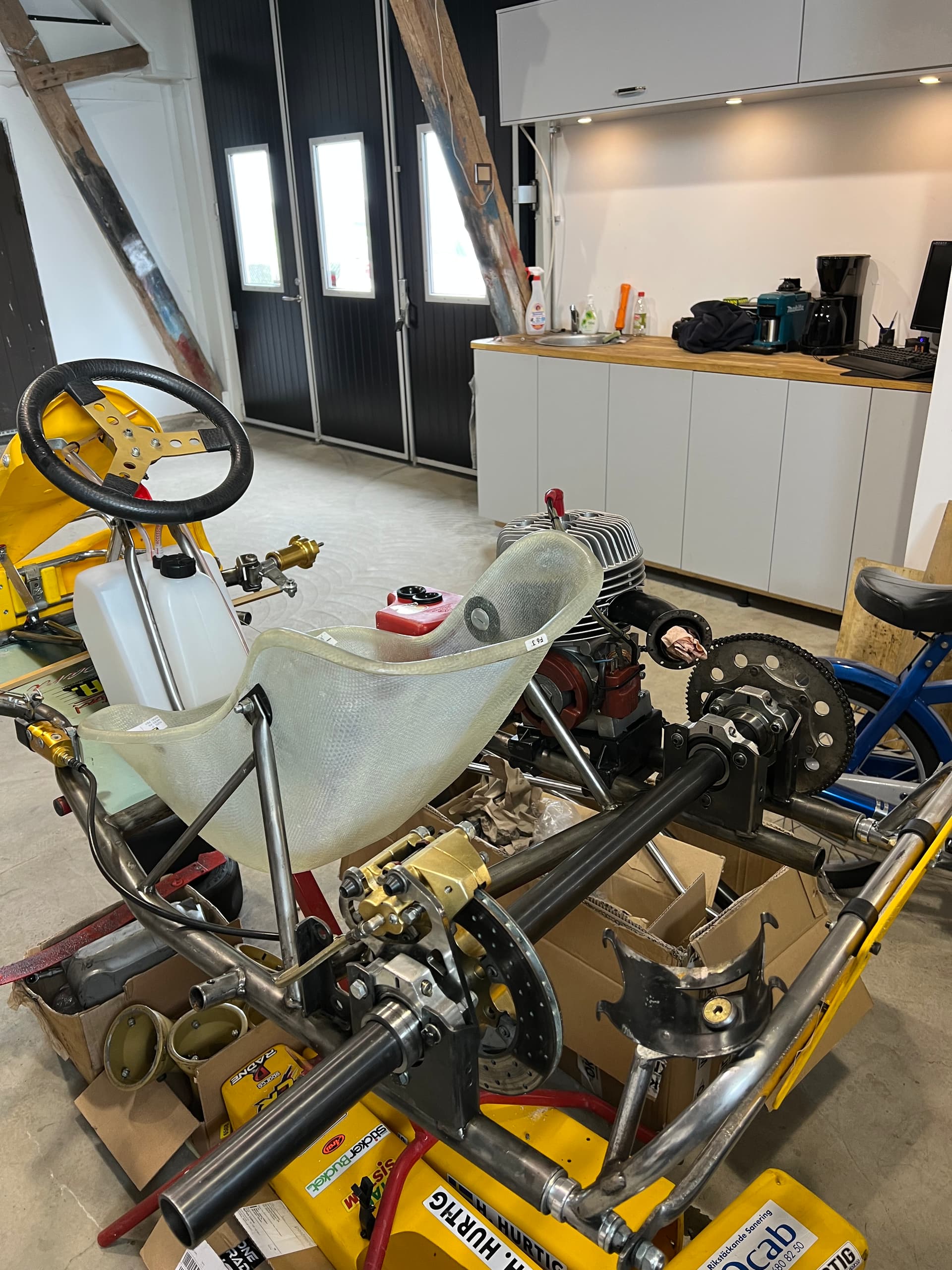

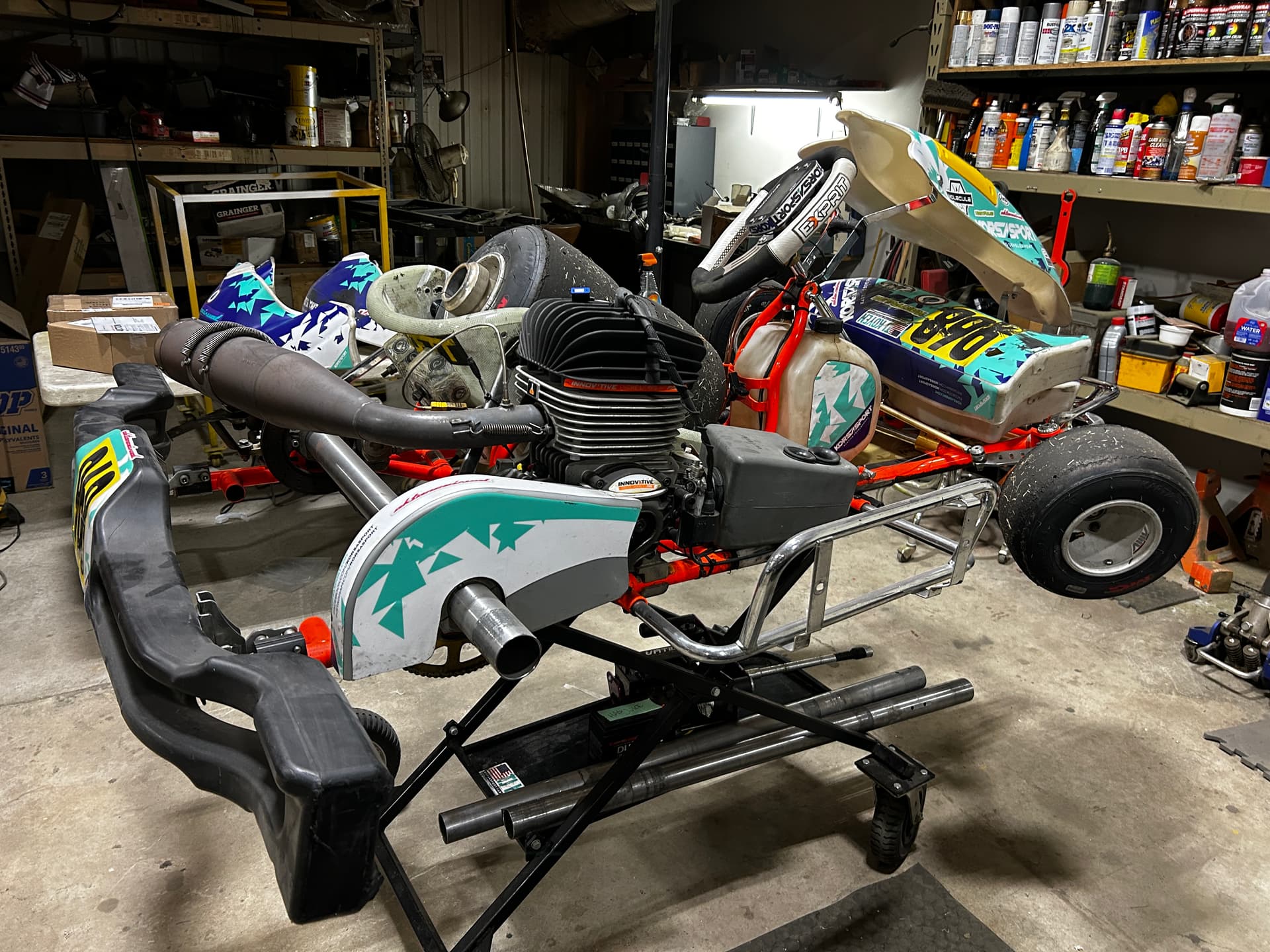

Stripped to the frame, cleaned everything, sanity checked on the table, and going back together.
You must go through a lot of lock nuts :stuck_out_tongue_winking_eye:
Red is clearly the choice for chassis powder coat. This Pops.
I raid my local ACE hardware every time I do a teardown and grab every box of M6 and M8 locknuts they have!
Yea, this color looks so good brand new! It’s just near impossible to keep clean and good-looking for long. Any rock chip, nick, or scratch is very obvious.
Metrics Unlimited sells them by the box of 100 for far less!

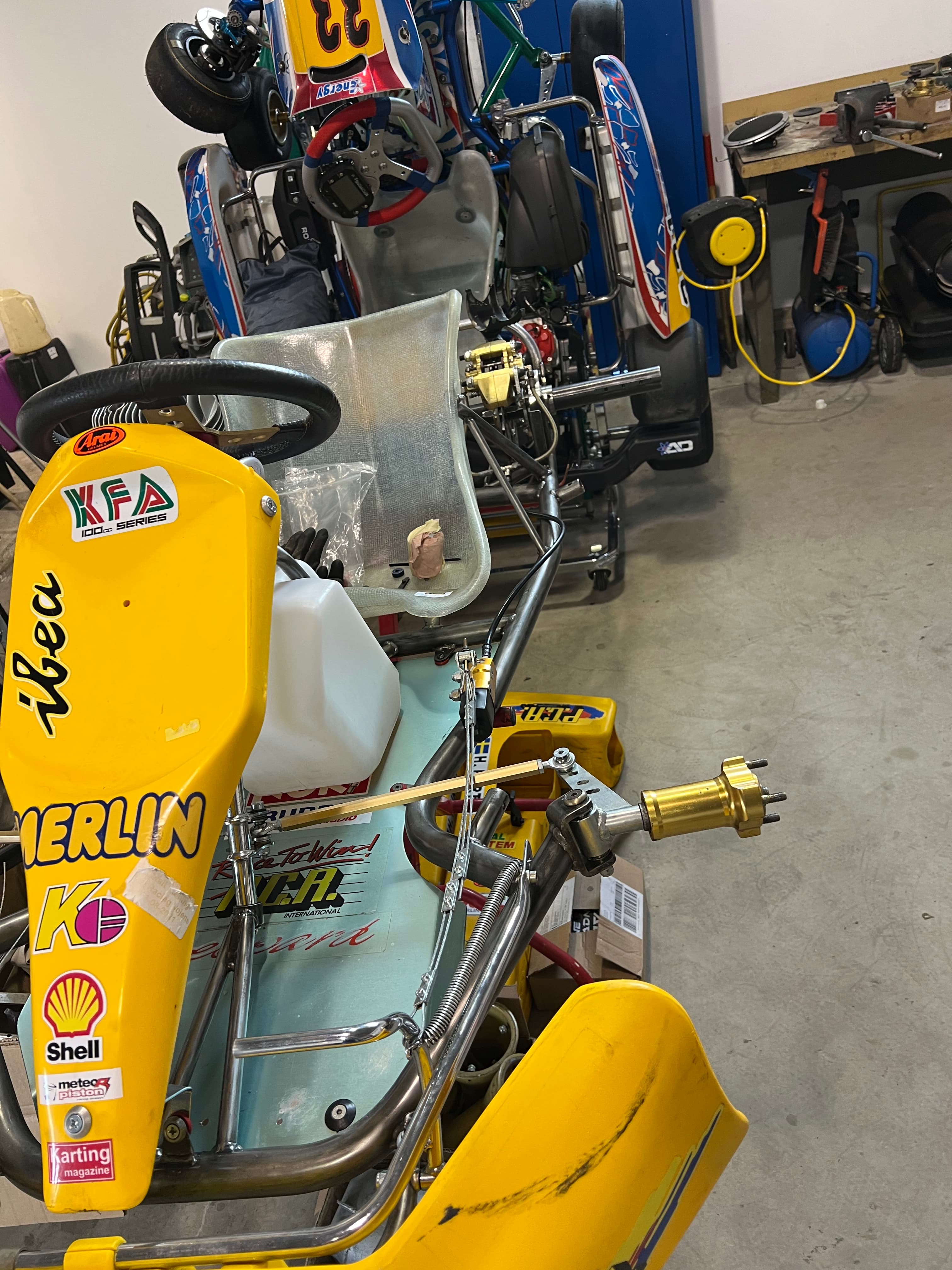

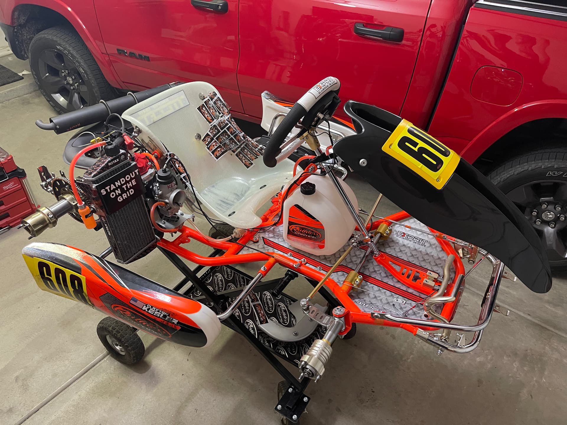

Complete and ready for a shakedown.
Very cool. Is floorpan a sticker?
Yep just the standard Exprit one.

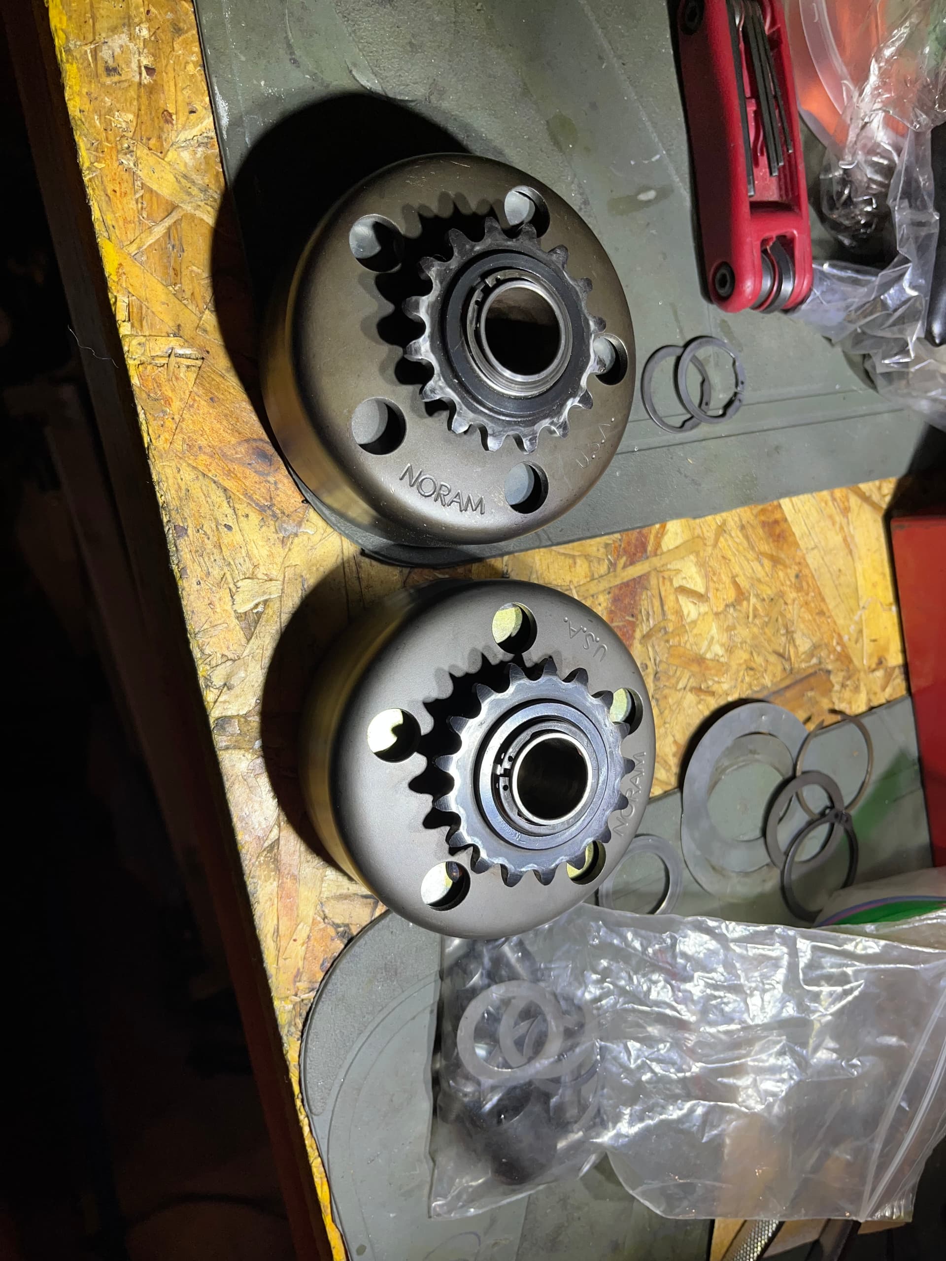

Put together a couple of clutches. One with a 16T driver, the other 17T. Getting ready for Sunday at NCMP.

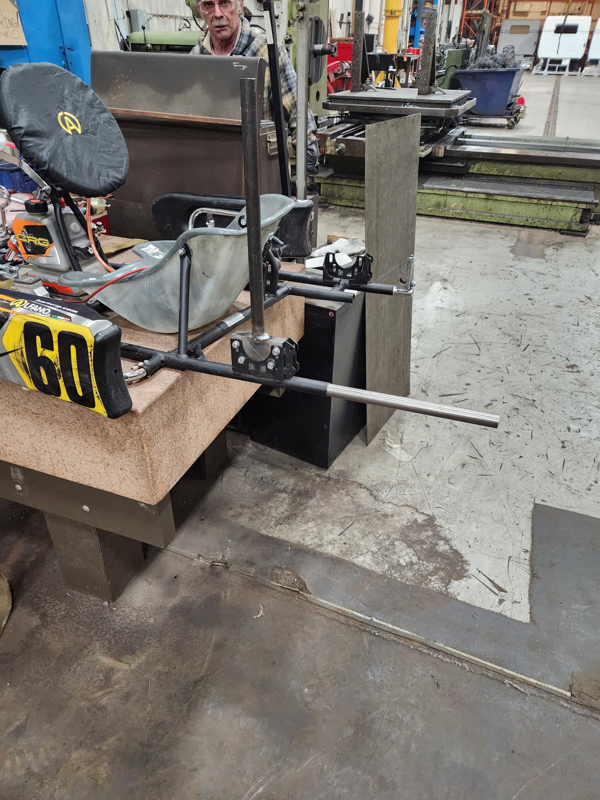

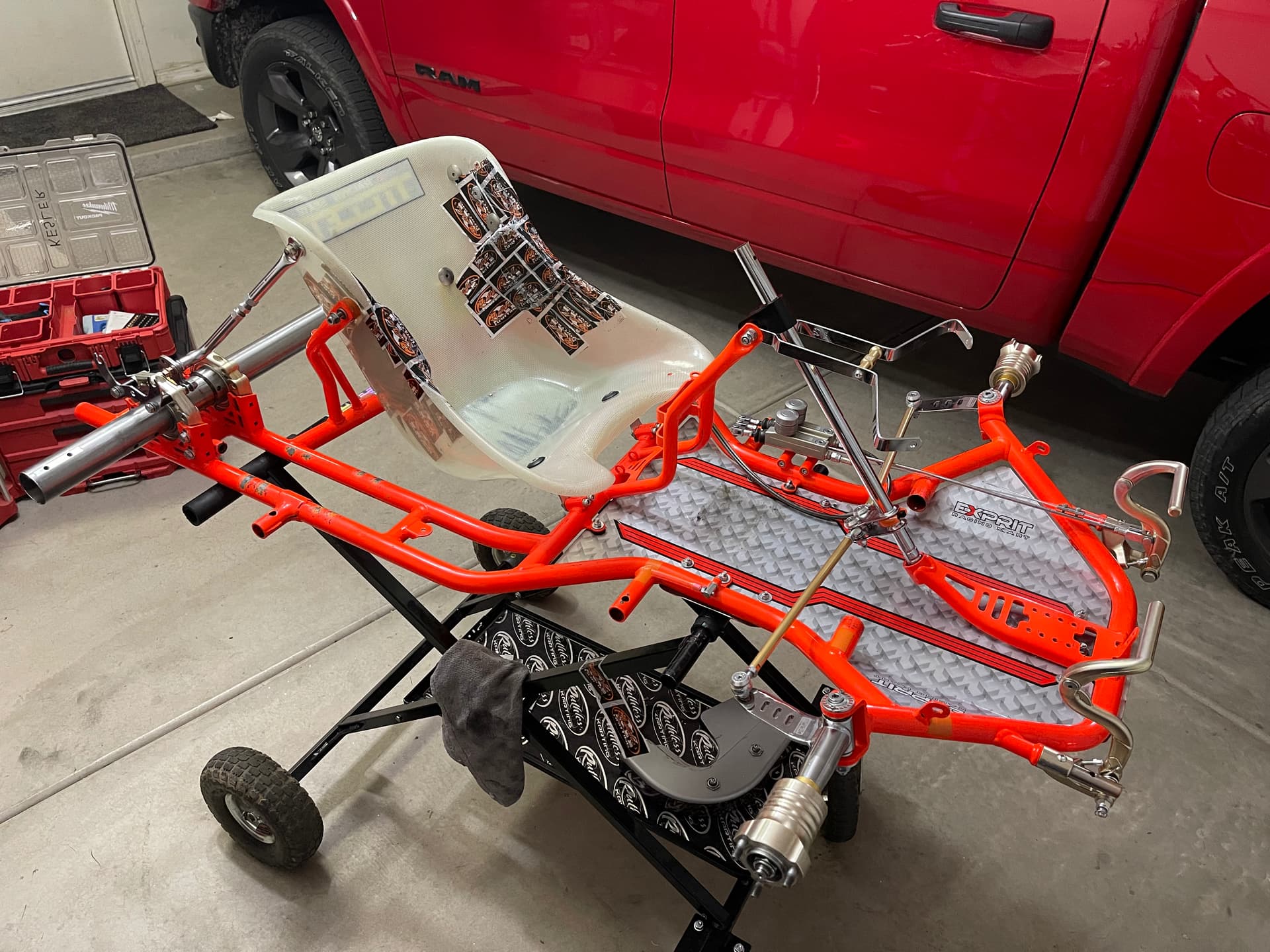

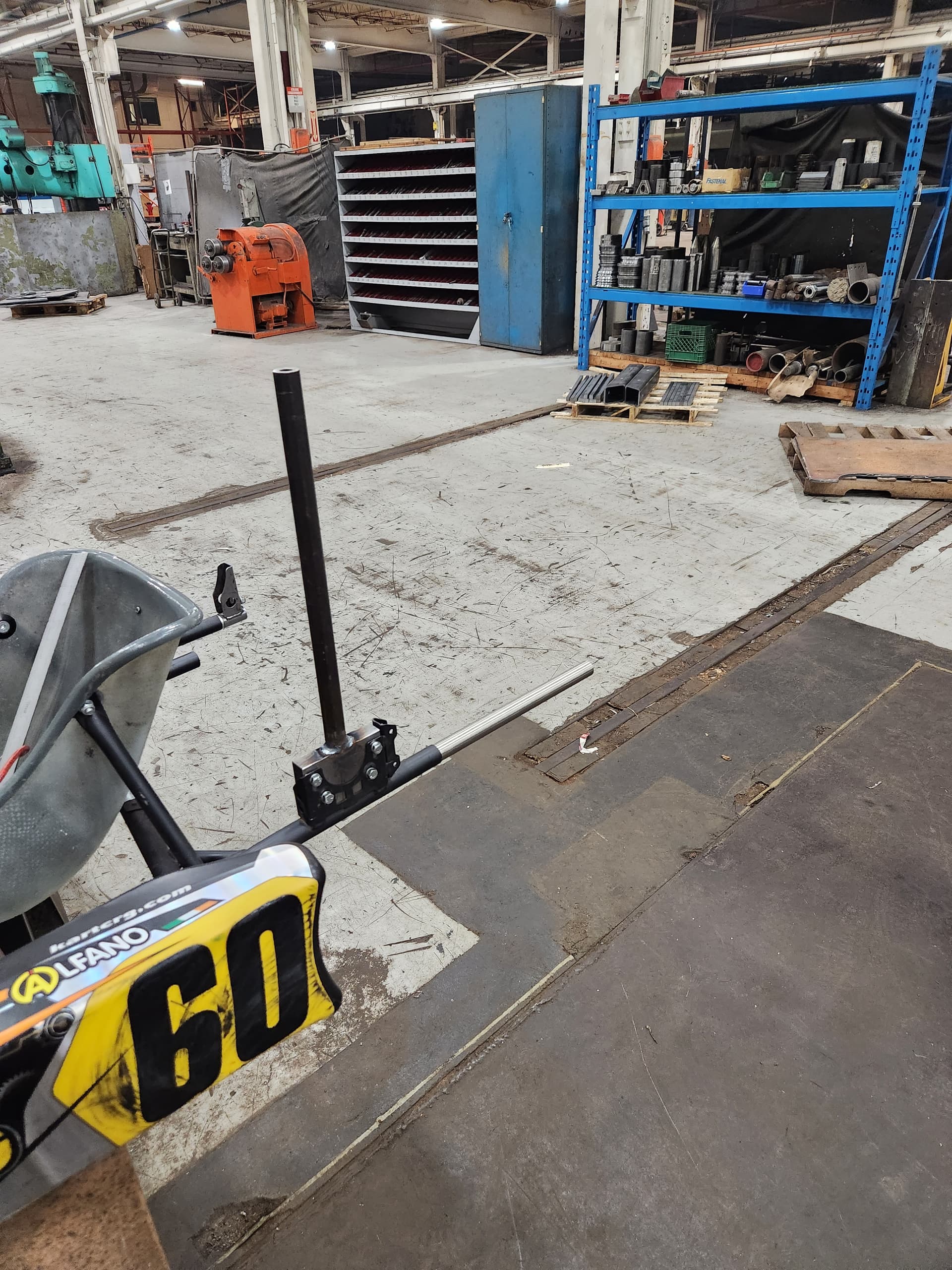

Made up a couple of custom tools to help tweak the frame straight. Wasnt out a ton, but more than i was comfortable selling it. Put it on my surface plate and it was damn near bang on.

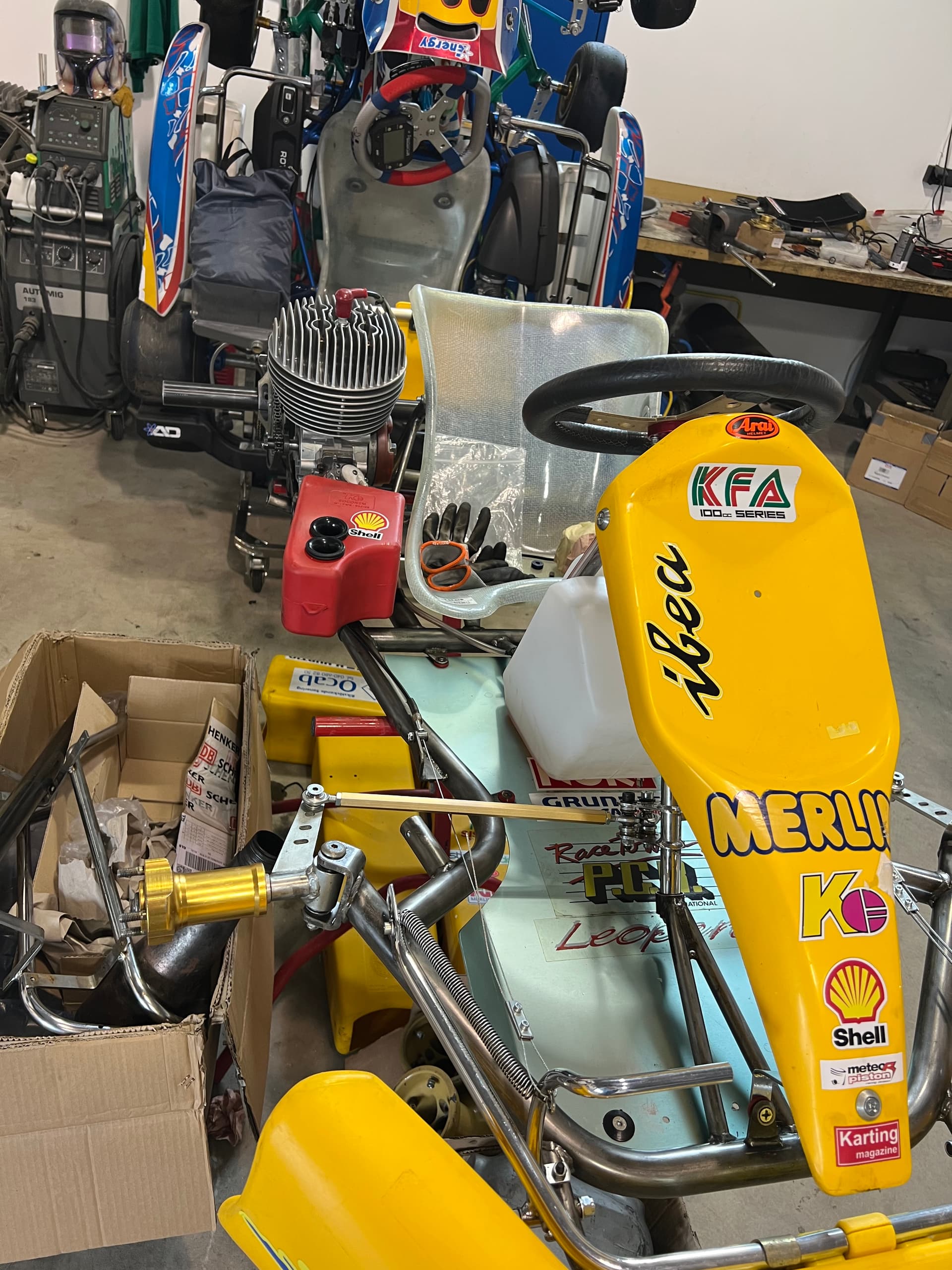

Fitting a jecko seat! Those things look very nice!
But the price whent up some, I remember I get it around 160 euros 2 years before. And now it seem something like 230…

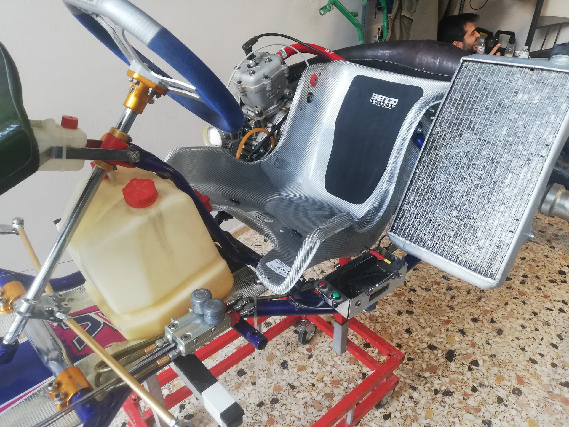

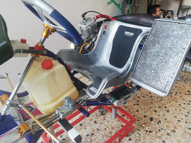

I’m in the progress of assembly my PCR/Minarelli combo. Very easy process compared to my KZ😁
Today I got the seat in and lots of other bits done, need to bleed brake system, put some fairing on and adjust exhaust to fit.

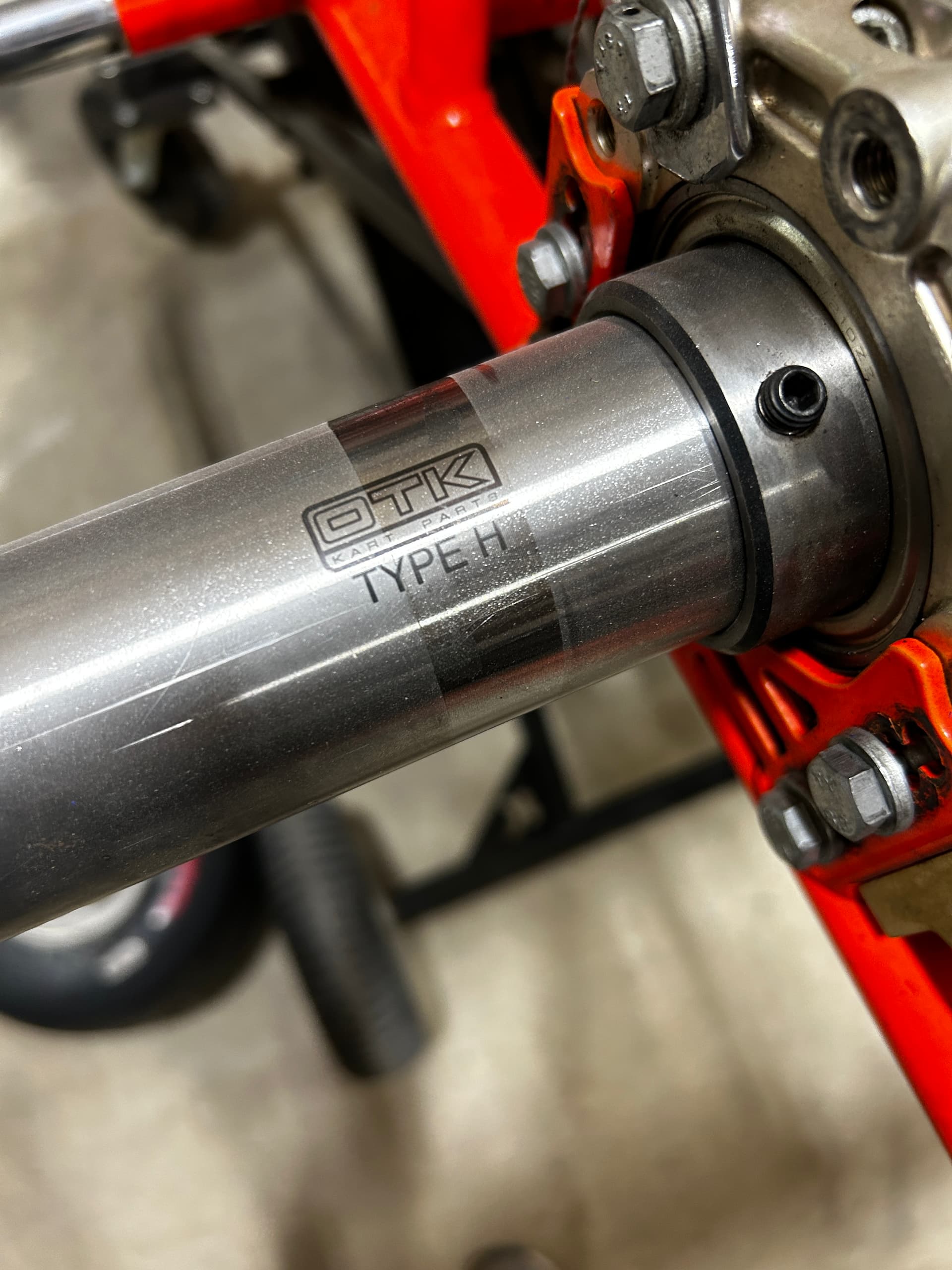

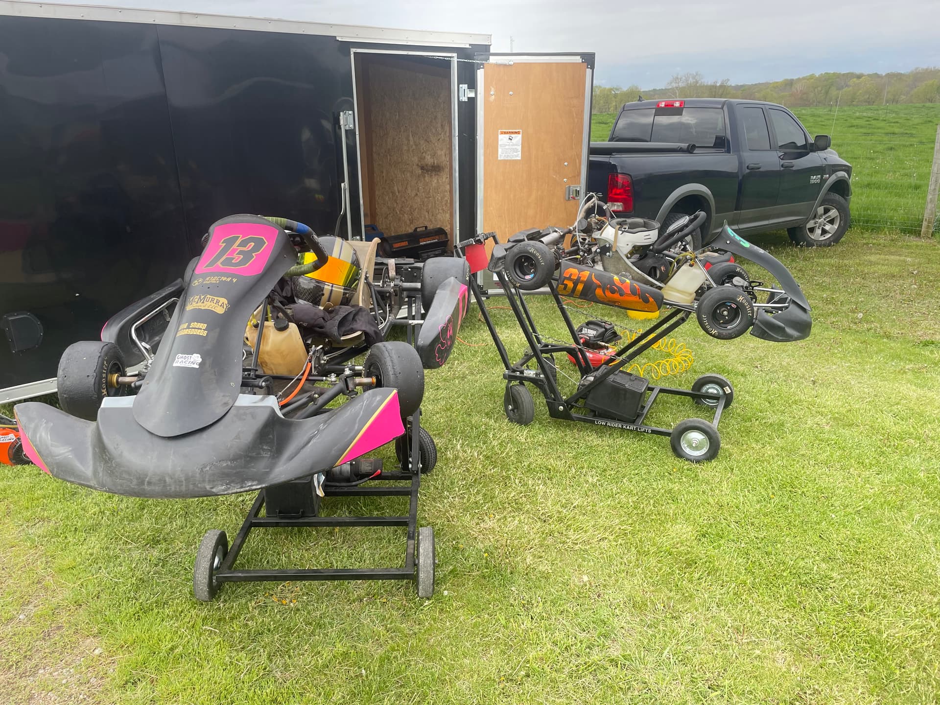

Getting the dust cleaned off, removing the grime I didn’t clean after my last outing last year, and taking off the national-high-grip setup to go get my first laps on the new surface at Badger tomorrow.
Not the ideal axle for a completely newly paved track…
Is type H a high grip axel or a low grip axel? Soft, hard?
Hard axle for high grip situations.
I was going to throw a Q (soft) in but I only have a bent N (medium), so that’ll have to do for now.
