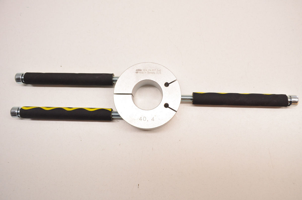

To split the crank you will need an inner race removal tool like this. You have to build on for your self with the right measurements taken from the ring. Or you could use some heat to remove it. It isn’t pressed on as hard
Replace ring and washer with new since the ring and bearing is “pared” from what I’ve heard
Or cut it, but be very careful!
If I use heat to remove it does that mean it is ok to warm it again to fit the new one?
I did see one of those tools Lucas being used on YouTube, it looks like it works really good especially if I need to install it hot again.
I was thinking that I might have to buy the Iame removal tool but it is rather expensive just to do my own engines to save money on rebuilds. It will be a lot cheaper to build my own.

I tried the heating method using heating tip on the internal bearing sleeve but it didn’t work so I will try making the tool and hopefully that works, otherwise I might end up having to buy the correct Iame tool to remove the inner bearing shell.
