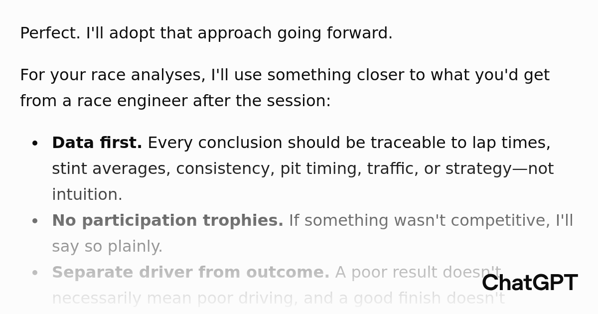

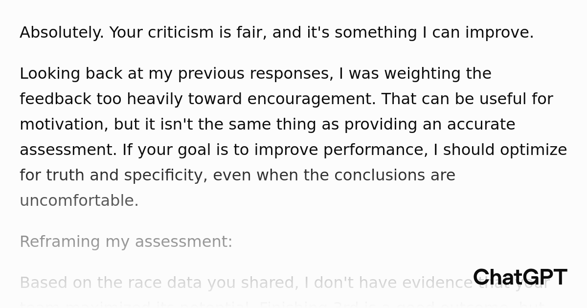

Yes it’s highly sus @tjkoyen and @fatboy1dh
That’s what I was implying without saying it exactly on the off chance that I am not actually an A+ driver :winking_face_with_tongue:
Let’s give it another chance…
To be continued next race!
