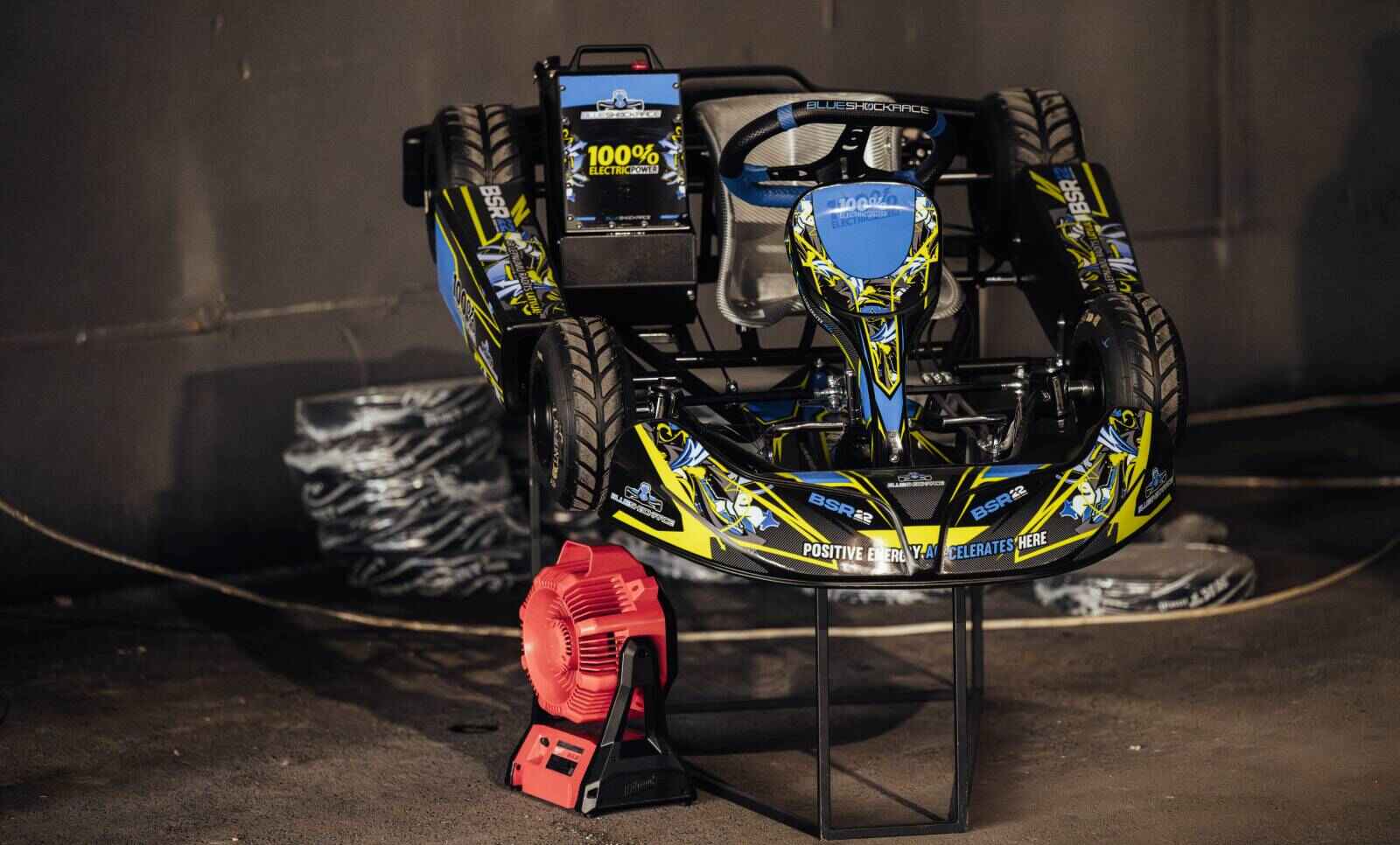

Since our system uses air cooling, additional air fans are practically always used after a ride to cool everything down within 10-15 minutes, regardless of whether the ambient temperature is low or very high. In very high temperatures, this is especially important, as every second counts.
Technologies with water cooling do not require this additional forced cooling. However, in many countries, water cooling is prohibited, and where it is not, it requires careful preparation and handling to ensure no air enters the system.
Air cooling demands the development of many small elements for better performance and ease of use, which is a focus for the BSR team.
This is our favorite: Milwaukee cooler, which is the perfect tool.

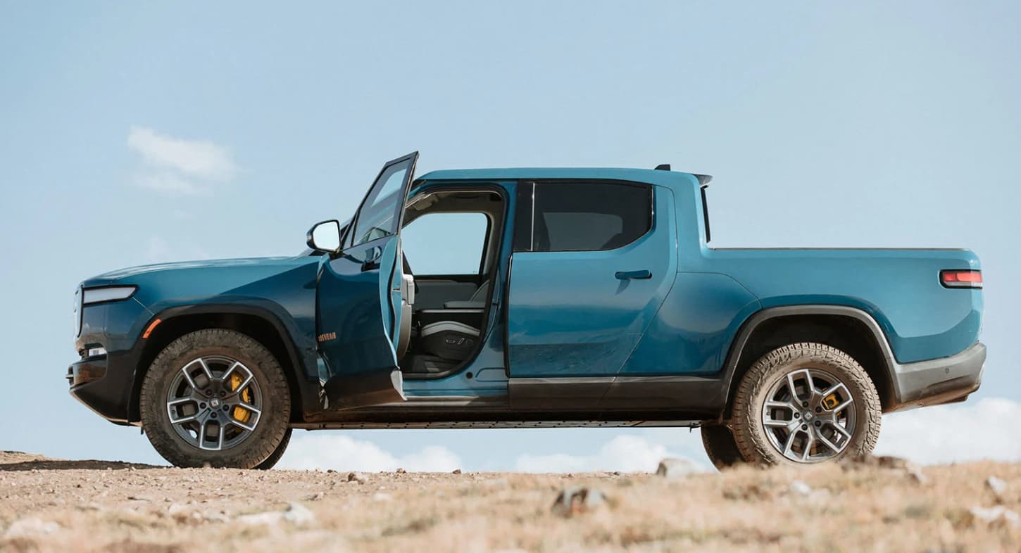

BSR electric karts can also be charged from electric cars, such as Rivian, Tesla Cybertruck, KIA, etc., which have the V2L (vehicle to load) function. All these chargers fit within the category that these electric cars support. Therefore, if someone purchases an electric kart and owns one of these electric cars, they don’t even need to worry about charging from the grid or otherwise. For example, from a Rivian R1, you can charge your kart 30-40 times and still have 50 miles left to reach a supercharger.
BSR has developed its technology so that future electric car users can use karts together with their daily vehicles, thus eliminating concerns about electric connection issues and solutions.
