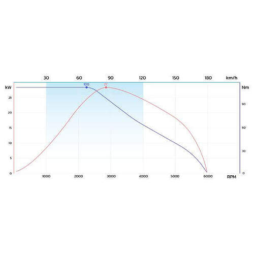

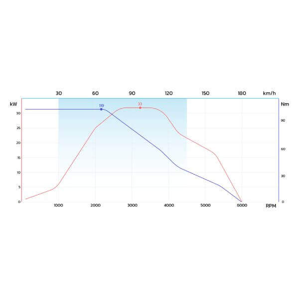

Here, you can see the power curves for the BSR-X4 and BSR-X5 on the dyno, showing both horsepower and torque. From zero up to X RPM, there’s a significant amount of power and torque, which allows for quite a bit of flexibility on the track to improvise as desired. However, once the power starts to drop, there’s an exponential increase in air resistance, meaning that top speed and RPM quickly hit a limit due to wind resistance, resulting in little to no further acceleration.
As a result, fine-tuning RPM for better results has minimal impact. Of course, this doesn’t mean any sprocket size will work; it has to be precise. Moving just one tooth up or down quickly shifts out of the ideal range, which is immediately reflected in lap times or an overtaxed engine, leading to unnecessary overheating.
