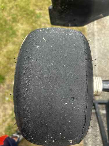

Negative camber - per @Paul_Montopoli’s request I tested lots of negative camber. I turned the top pill 90 degrees. The tire wear did not change much, surprisingly, we still were using most of the front tire and it didn’t really feel like it gave up much on turn-in. But it released off the corner better and felt faster through fast corners. Data shows better apex speed in fast corners with slightly lower entry speed in slow corners (but better acceleration on exit) and overall faster. Negative camber probably would help more on a faster more flowing track. Maybe you want less negative camber on a twister track. It reduces the scrub in the front end and is a noticeable change for corner exit. Found another 0.2 with this change.
Shows how much negative I was running and the associated tire wear.
