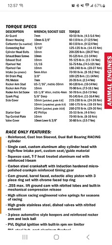

I think it is odd how Briggs lists the torque specs for the head bolts:
They say 200-220 lb-in but then 20-27 Nm. What makes me question this spec range is that 20 Nm is 177 in-lbs and 27 Nm is 239 in-Lbs. Why would they give such a different range spec in Nm? Seems like it would have been easy to just list the Nm range as 22.5 - 25 Nm which would be much closer to the in-lb spec they give.
Reading around, it seems most recommend torquing the head bolts to 200 in-lbs. Does that track with everyone’s experience here?
Don’t overthink it.
200 lb-in and send it.
I don’t think I am over thinking it. I just typically try to use metric units as much as possible and was surprised to see that the range was so significantly different. That is all. :slight_smile:
Roger that, 200 in-lbs it is!

Absolutely crazy (and frustrating lol). But what is so weird to me is that the Nm ranges for other torque specs, including ones that don’t really matter that much, are accurate. For example, the blower housing and carb to manifold ranges match the specified in-lb range.
