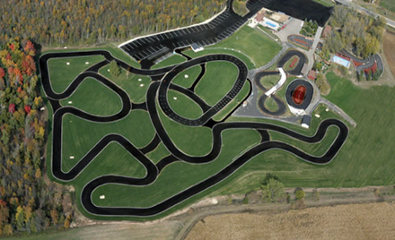

There are definitely corners out there where using some out-of-the-box techniques can help you get through the corner without lifting. The one that springs to mind is the tree line corner at Shawano. Top left corner of the photo, 90 degree corner that runs along the trees: Image result for usair shawano
In most karts, this corner is alllllllllmost flat-out. However, if you really chuck your body into the kart and start turning in a little early, you can get through there without lifting.
1:28 in this video: https://www.youtube.com/watch?v=yECrf12TMqo&t=59s
So maybe in a very fast corner this is applicable, but you wouldn’t be braking in a corner like that anyway.
TJ is correct. I’ve watched a lot of video on this particular track. This corner is so close to being flat. Even the tag guys are barely lifting and that’s just to get the go kart rotated into the corner. I would assume it also saves tires as I have heard that this particular track is hard on tires. I wish the track it was still raced at. The scope approach works well with practice. It is used by F1 guys, so I know it works.

TJ: this is exactly the kind of corner that lends itself to what I’m describing, except that the kerb looks too severe. I don’t think you’d be able to lift your inside wheels over that.
