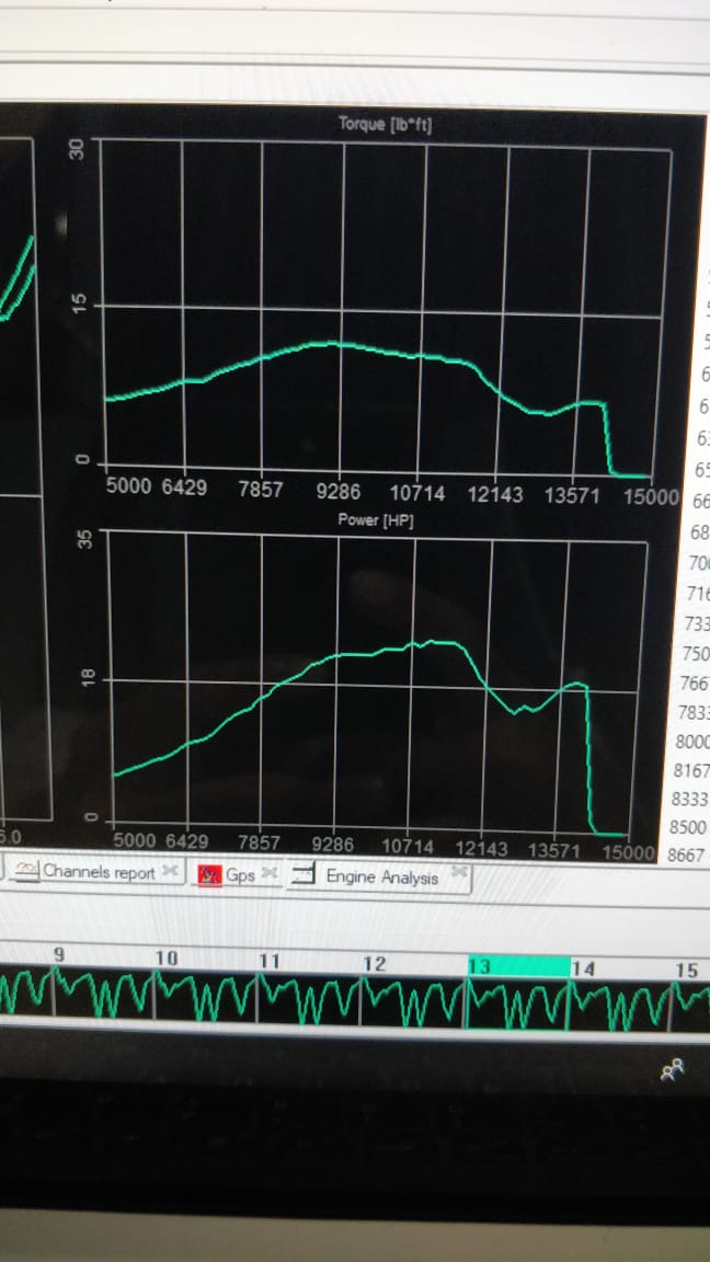

Hi guys, thanks for all the tips and feedback. I just managed to get some data from one of the faster guys but his data is running that track in the opposite direction, I don’t have any data that way yet but I was able to do some analysis. He was on 12*86 and averaging 13200 max revs, I am really starting to think my engine is letting me down. I used the engine rpm analysis feature on race studio and it’s showing from around 10000-13000 rpm he has 3 sometimes more hp over me. Is this a feature that can be used to compare two engines? See attached photos IMG-20180827-WA0018IMG-20180827-WA0015

No gearing isn’t the same but it ought not affect the calculated hp and tq since it looks at rpm and speed. Basically this guy is geared way longer than I am, he’s not even hitting the second power bump after 13500rpm while I am geared way shorter and revving to 14100rpm…I should be quicker off the slow corners as well as benefitting from the second torque/power bump at 13500+ yet I’m still slower. I know my chassis has part to play but based on the above and the engine rpm power/torque analysis on race studio, I’m leaning to believing my engine might be letting me down as well
Hi, gearing does play a part as 2 strokes power in affected by the rotational acceleration of the engine. As the engine can sometimes not sit at desired RPM long for the pipe(heat) and timing to sync properly. So without identical gearing and weight it may be a bit misleading.

Marin, I’ll soon get data in the same direction so we can compare then but I also have some data of my kart with 3 teeth longer gearing and the engine RPM analysis is more or less the same…my engine makes around 23hp peak. The other guy is making 25hp consistently.

RPM’s are used to calculate HP. IMO, if you are not using the same gearing as the engine you are comparing your engine to, the data is going to be skewed. Other elements involved here are aero and mechanical drag. To obtain better information, you have to use a dyno or test both engines on the same chassis with the same driver.
I understand, but I looked at data of my kart with two different gearing setups and the analysis wasn’t very different, near identical in fact. The other engine does show a significant hump around 11000rpm while my engine sort of plateaus
