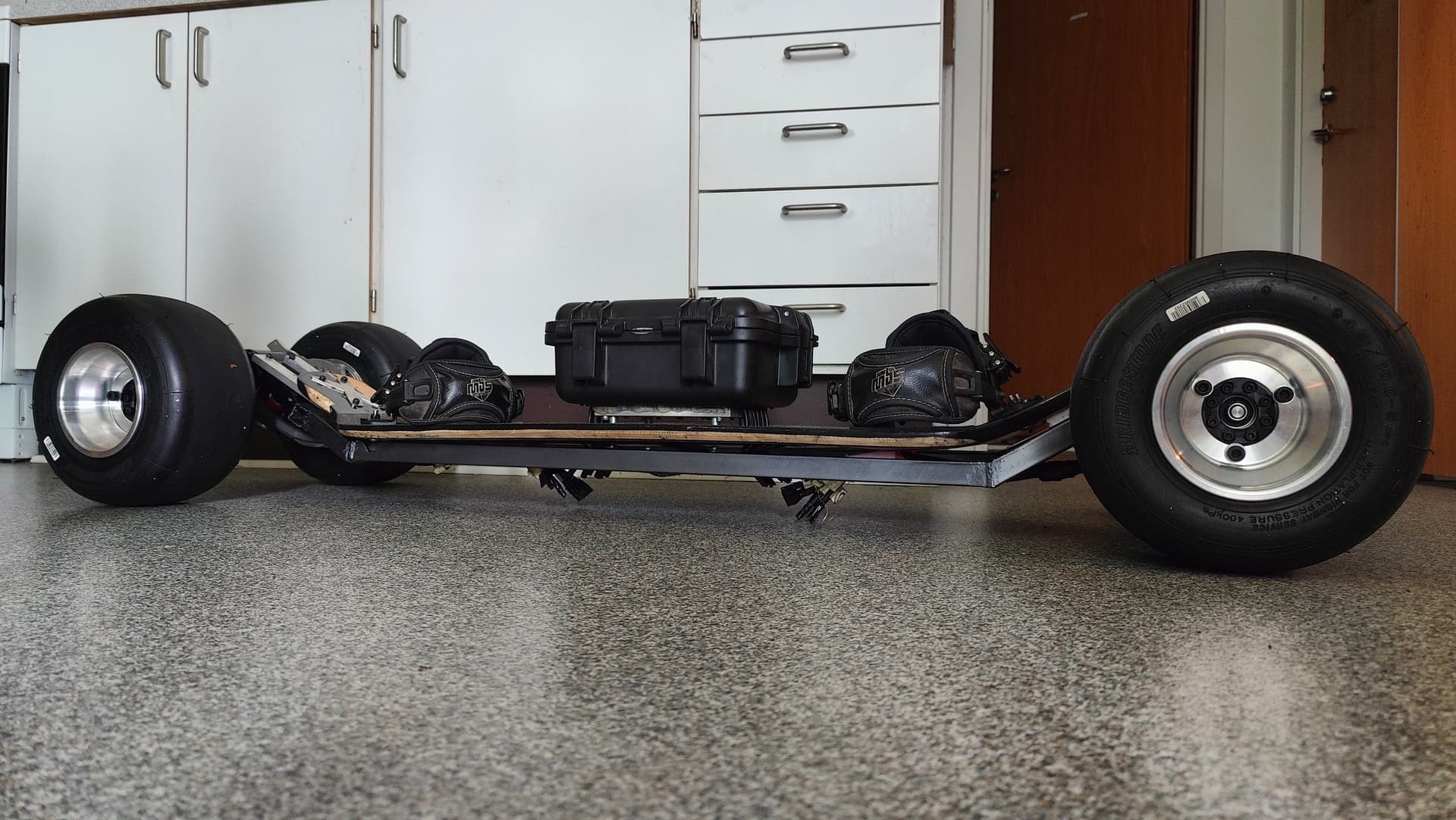

Took longer than expected, but now I have the tires setup on my board, on my old chassis which I modified to fit these. Figured I want to try the tires first before finalising the design of the new chassis I was working on.
These are the Bridgestone YPB tires, manufactured 5 years ago… They didn’t harden up too much by feel though. I had two sessions on them so far, and some very weird findings.

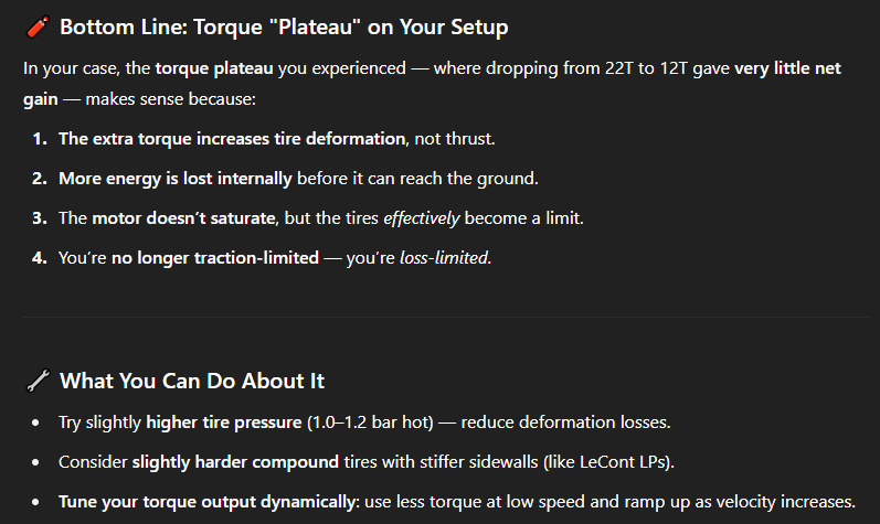

Given such a weird phenomenon I decided to give chatgpt a ton of context about the setup, what I am doing exactly, which tire it is, etc. Then gave it this very weird preliminary result and asked it to explain it. This is what it came back with:
It thinks if I reach around that 0.5G point in acceleration, then the extra torque I apply to the wheel, just heats up the tire instead of moving the vehicle forward, and this effect is so extreme that it has already plateaud out, meaning if I were to put even more torque into it, it would still only accelerate 0.5G. I really can’t wrap my head around how I could be heating the tires with over a 1000W loss per tire from the extra torque the 12T pinion creates instead of the 22T pinion. The wheels are not slipping that’s for sure though. Is this really a phenomenon? I am technically using front tires that aren’t designed for longitudinal grip transfer I get that. But 0.5G is pretty mediocre especially for my setup…

I suspect the answer from ChapGPT was horrible. The real answer is that you are probably making the same hp across a broad rpm band, so moving up the rpm band with a higher ratio won’t actually give more torque. The whole “higher rpm, more torque” heavily relies on the input torque being constant. If the input torque falls with increased rpm (as is normal with electric motors), you lose input torque by the same rate you gain mechanical advantage, netting zero change.
The whole “extra torque increases deformation, not thrust” would imply that wrinkle-wall tires on a Top Fuel Dragster are bad.

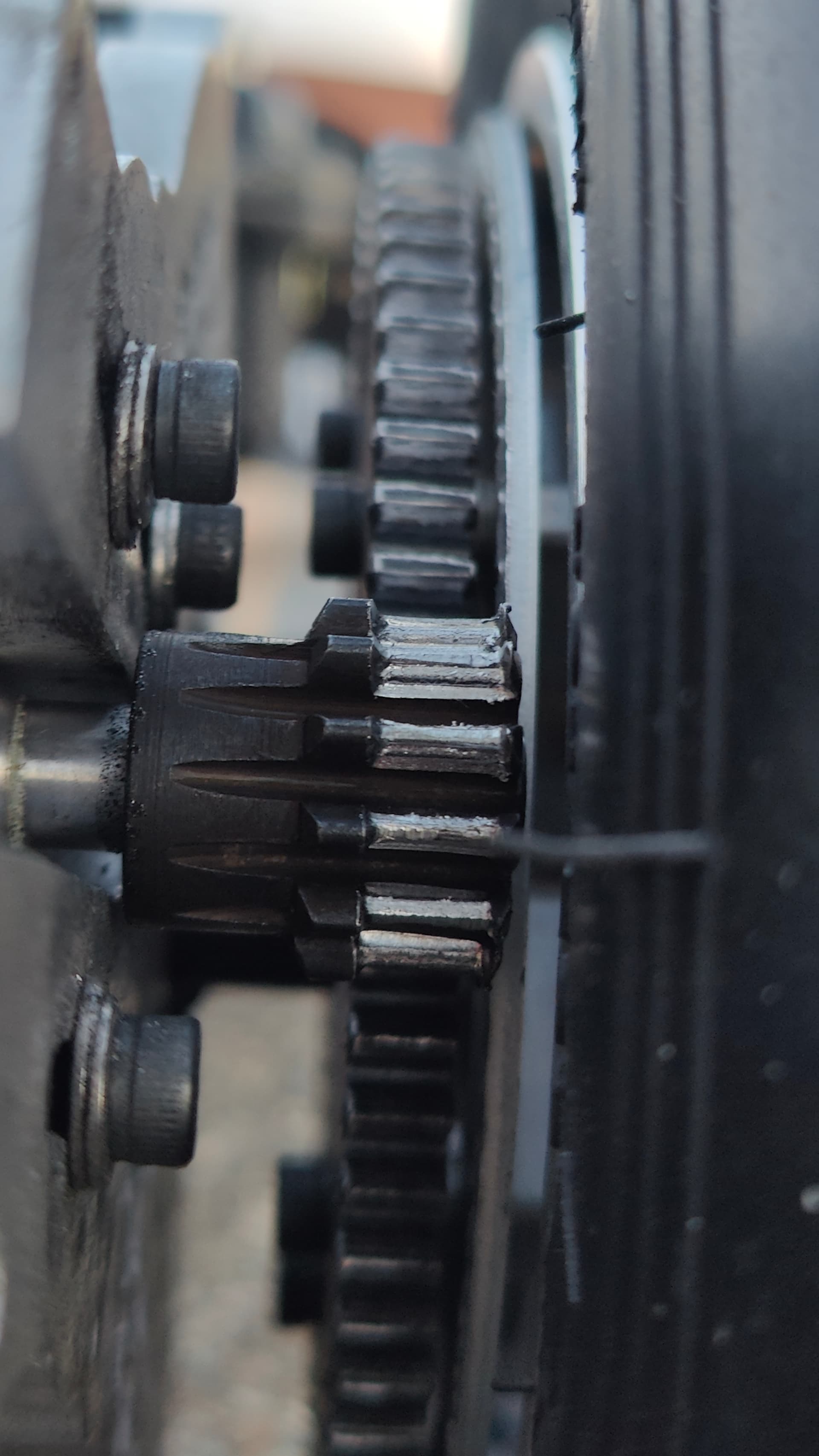

Turns out that my gears were the primary cause of the weirdness, but a set of brand new tires on a second set of rims is very high on my list of todos! I’ll keep you all updated on how those go. But regarding estabilishing a basepoint, these 5 year old tires were good enough to hold 1st place in qualifying before I crashed out at last weekend’s indoor race, where we had an insanely strong lineup of competitors. I dropped down to 4th after my crash. The way qualifying works in this series, is that there’s free ride on the track before the race itself, and your best lap there is your qualifying time. So by crashing I eventually missed half of the riding time to qualify. I’m sure a fresh set would be much better though still.
Well, some power still goes into thrust, just over a certain point more power starts going into heating up the tire itself is what chatgpt said. I did some calculations and this lost energy would’ve meant 1C temperature increase from the acceleration and braking over the straight, which doesn’t like crazy either.
The lack of torque was actually from 0 or close to 0 speeds where I wouldn’t have reached the battery current limits therefore the power was still increasing linearly with speed. Turns out most of the power difference between the two setups was actually issues in my gearing, I had too much force per teeth and the non lubricated gears just couldn’t take it without grinding and heating. In our hobby it’s perfectly normal and super common to run dry gears, so I didn’t really expect dry gears to not work for this setup - but with the larger diameter tires, I need more force over the teeth than other setups. My new (good quality) gears which I did lubricate delivered way more torque compared to dry gears. Although since I only got the chance to run them indoor, I don’t have racebox gps and gyro data so just going by feel.

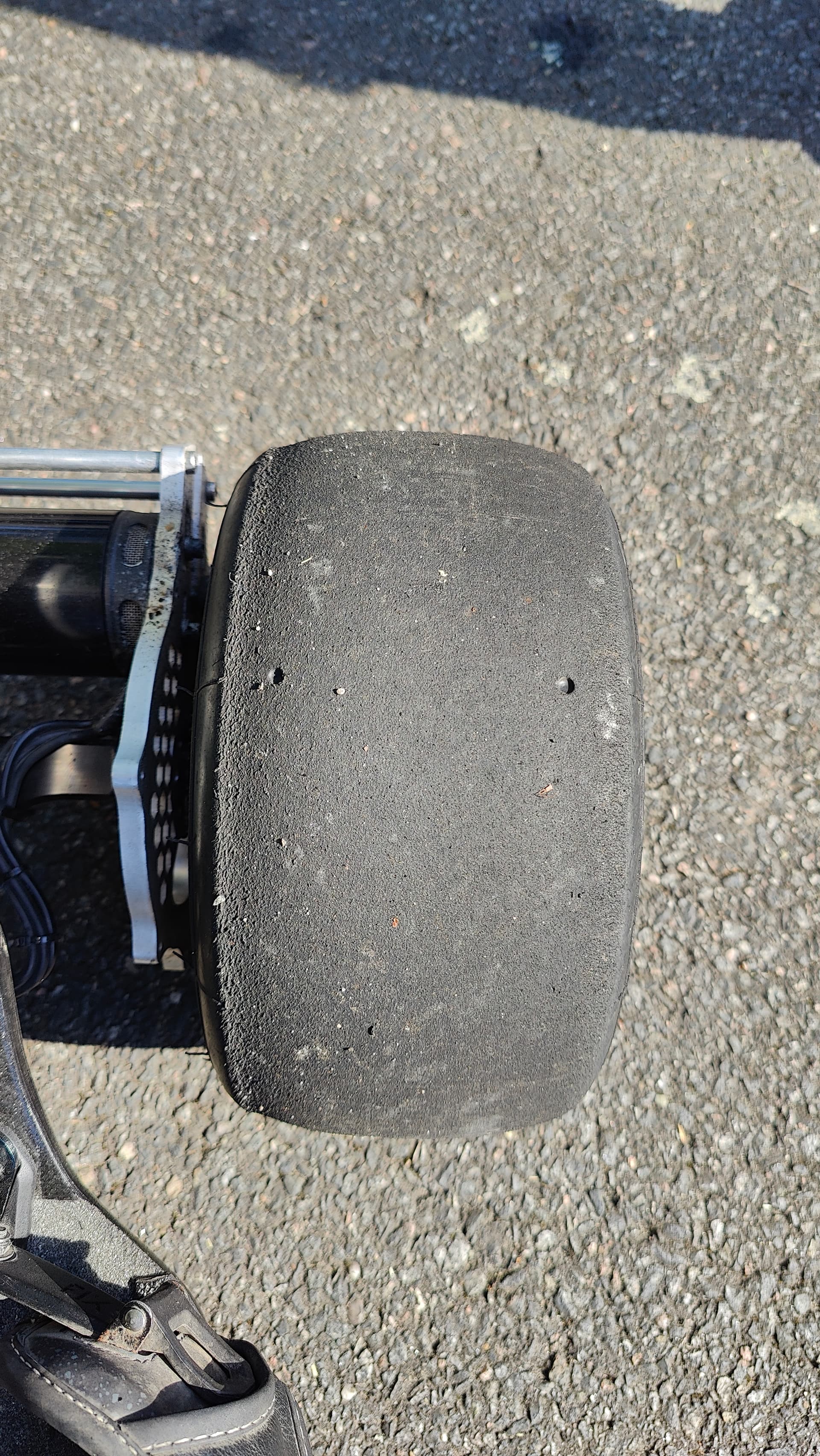

If the inside tire is doing most of the work, you may consider adding some positive camber on all four wheels. Then you could likely run a lower tire pressure as well, which would likely help you get some more grip for when you accelerate.

Here’s how my tires wore after the last weekend’s race. I think I went a bit too low on pressure… more wear next to the sidewall than I’d like. But ride feel felt good on track and I even could go over rumble strips no problem (which is not possible on esk8 tires). But anyways here it is:
I think a little positive camber would work great. The inside of the tire definitely wore the most. Need to ask my truck maker if it would be theoretically possible for him to make a set with the positive camber. No idea what angle to ask for though, or if it’s even possible for him to make.
