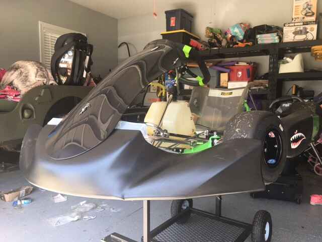

Forgot to mention the new front aero, that was the first time I ran it. Its suppose to be wider than normal for the wider folks. Don’t know if it works, but it sure looks cool. :rofl:
In the track picture you can tell I run a neon green strip under the front fairing, so if I poke my noise out, hopefully it can be seen. Again, I try to be cautious and not cause a wreck. I am still in that feeling of more survival vs. completion.
