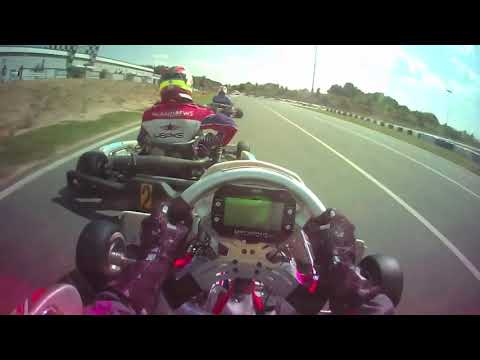

At least here at GoPro/Trackhouse, drafting is HUGE during a race. While I have only practiced so far, I have noticed times can drop by a second or so when drafting the full lap. This can influence your gearing strategy: drafting=higher top speed needs. With qualifying, drafting doesn’t seem as prevalent, so speeds can be lower, so you can gear more for torque than top speed. At my current gearing, I spend 200’ on the limiter, so if I was drafting, I’d probably have to drop another tooth or two to keep in the draft.
Here’s some on-board from Trackhouse where I was geared a few teeth lower than most people, totally giving up my acceleration off the hairpin, but blowing people away on the straights. Perfect example of gearing for specific characteristics of a track.
