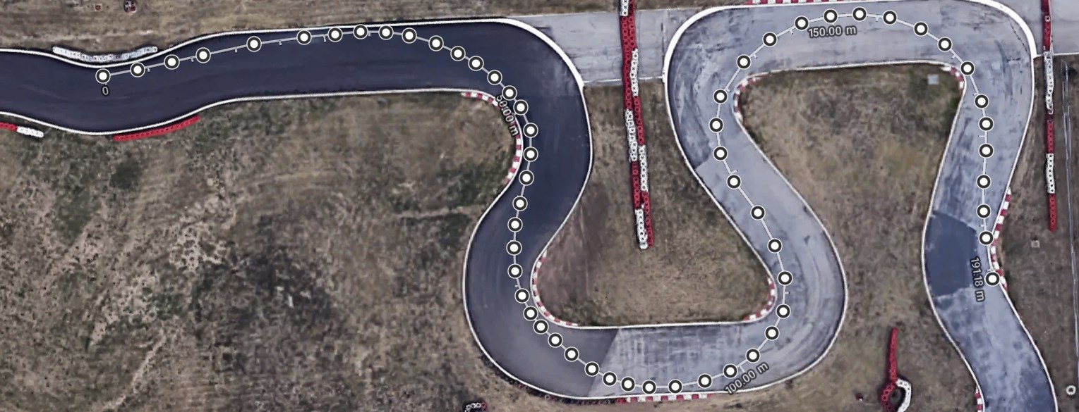

Can you draw me your current line from 7-13. I will try to illustrate lift timing as I suspect it would go, possibly.

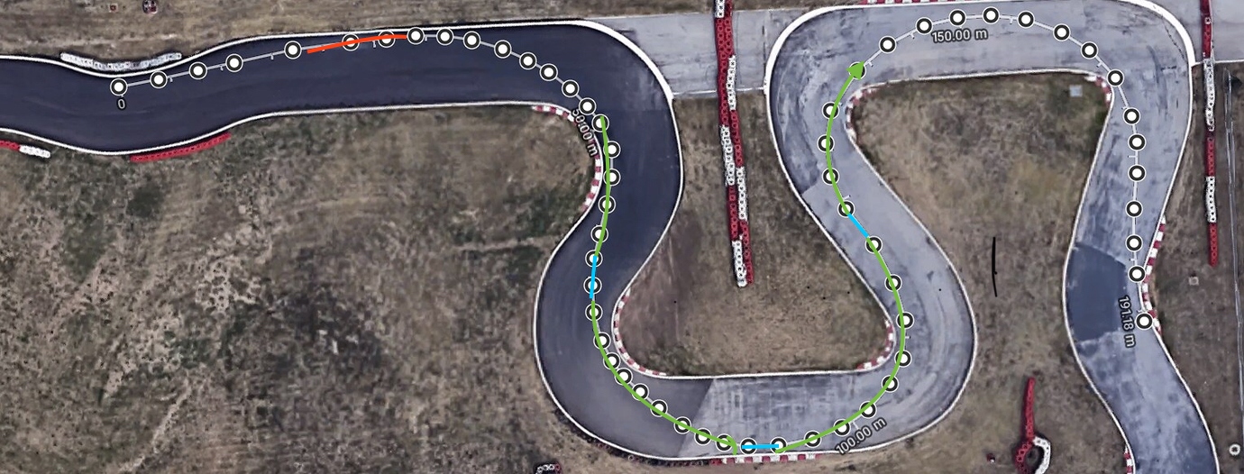

Here is the line I would drive now:
In real situation, transition from 9-10 isn“t as sharp, much rounder I think, that is only correction.

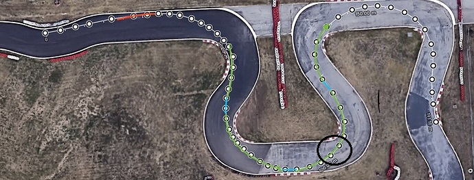

I could see a lift to turn before 9 as you come out of 8 to rotate. I could see a lift either at the bottom of the 9-10 (as illustrated) or possibly move the lift up slightly to be before 10 rather than in the middle. That would be a lift, turn, lift turn, probably. The second lift may or may not be needed or maybe just partial.
But, it’s this area, 8-12, where you introduce extraneous footwork. I’m not entirely sure where the little rotational pauses will be exactly. This is sort of a general guess. I see you doing multiple pedal inputs usually in between 9-10. Try to have just 1.
Looking at this…The bottom lift is more of a tempo thing than a rotation thing and maybe it’s just a mild throttle reduction before feeding it in up on way to 10 apex. Not sure but this is where you seem to lift most and it’s mainly for speed reduction?
Edit: specifically I see you pedaling furiously between 9-10, when you are trying to moderate speed for the upcoming 10 turn in.
So, think about the 9-10 piece. Is it a pause just prior to the bottom turn between 9-10 followed by squeeze in throttle through 10, quick rotational lift into 11?
Or, is It constant/mildly increasing throttle from 9 exit, hold the bottom turn with no lift, and lift only to rotate 11?
Or, something else?
I don’t know. But, mess around with variations until you find the one that flows rythmically and allows you to drive through the complex as balanced and powerfully as you can.
If I remember correctly, I am lifting during the right apex at 8 and maybe one lift during left apex at 9. I do quick lift-gas-lift-gas to remove understeer and to keep my speed as constant as possible through 8 as it is very hard to do like 50-70% gas as pedal is overly sensitive on most karts. That would be ideal, as you mentioned. Now to turn 9. I think this is giving me a headache. I maintain the 8 but I floor out of the 9. I am fine, I don“t understeer or anyhow lose control/speed but it makes a problem into 10. Maybe I should lift somewhere around where you mentioned just to keep the kart stable and maintain the approach speed. Now that problem that I just mentioned is too much speed into 10. Always too much speed. I lift somewhere around here, like most of us do.
St
I will go backwards around the track on both video and in my head, and try to find a logical way to go through this the track with least speed loss. But it will mostly come to this section. I got like 4 months, I should figure it out by that time hehe.
You are right, biggest lift is at 10 (better said before 10). Comes to what I just mentioned, too much speed. Really unsure how to go through the section 10-11-12. Although I drive it fairly well, I never know exactly what should be the right line (remember seeing me doing a very tight line and sometimes very wide). I do know that for, let“s say, turns 1-3. The problem that I will try to solve is when to power out and what is the actual perfect line through the section. After I figure that out,I should realize do I need more or less speed into 10 and I can correct that quite easily I believe. Until then, I don“t even know when should I lift and how much into 10. For now, I lift around that 100.00m mark on the picture and it is mainly for speed reduction.
I would classify all of this under this section :grimacing: I basically know what I am doing but not sure if it is the best thing to do. Although it most certainly does not look like the best thing that can be done as I am 0.7s of the track record, so there is margin to the top. By the way, the guy working there, set something like 47.9s…I am really stunned lol. No idea what is he doing but it works…

Ok. I am not sure about anything and you are the pilot so take all this as it’s intended… food for thought. It’s probably incorrect since it’s me imagining this complex from what I have seen of you doing it.
I have no idea how it ā€œfeelsā€ to lean into a turn on your track. I have no idea how your tires and chassis behave.
I can only imagine what I would try to do there based on what I have seen you do.
I would imagine I’d approach this the same as you. Left edge but swing it in from 7.
I would be getting back on gas immediately at turn in and attempt to throttle through 8.
I’d likely then likely have to lift either partially or totally to rotate 9. Again, back on and accel through apex and out to 10.
Carrying throttle to the bottom, assuming I can turn the kart up into 10 without a lift, I’d do so and again try to accelerate up though 10. A quick lift (after 10 before 11) rotate, acceleration through the rest all the way out.
If that bottom turn between 9-10 isn’t able to be carried with throttle, maybe there is a lift or reduction as you come to the ā€œapexā€ of the bottom turn which would allow you to turn up and through 10.
In this case I’d think that likely a post 10 lift would be necessary to get around for 11. That or maybe you can ā€œbumpā€ the kart around a bit on the exit kerb you described.
I think your line through all this is fine. It’s just tempo and timing. Just try to find where the lifts don’t hinder accelerating through a turn.
Then, when you find where the lifts do work for you, then try to lift less until the lifts disappear into the proper footwork. That will come as the transitions start becoming fluid.
