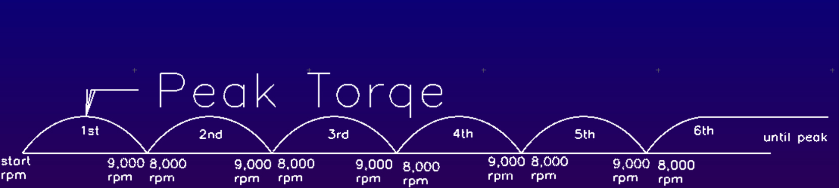

This drawing is something I would try. Your peak torque may not be at the same RPM as I have illustrated, That’s something you’ll have to work on, but the concept is pretty clear, I think. Maximum torque to the rear axle means, maximum HP at the rear axle.
Am I missing something or are you literally not reading the content being posted? What does shifting have to do with anything?
