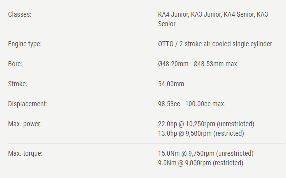

Its not a true Dyno Chart, but you might be able to interpolate a similar curve based on the X30 by shifting the graph down to match peaks.
Using:
X30 has thicker lines.
I would bet IAME’s engineers designed the engine with similar specs on porting only scaled down for the 100cc class. If so, that would mean the KA starts making Power around the 8,000 mark and peaks out on Torque at 9,750 and Hp at 11,250. Secondly, you could aim your gearing to not drop below 8,750 coming off the slowest corner to maximize exit power and acceleration.
Now this is just theory and based on some assumptions (we all know about those
). Maybe @tjkoyen could weigh in more with all of the experience he has with the KA.
