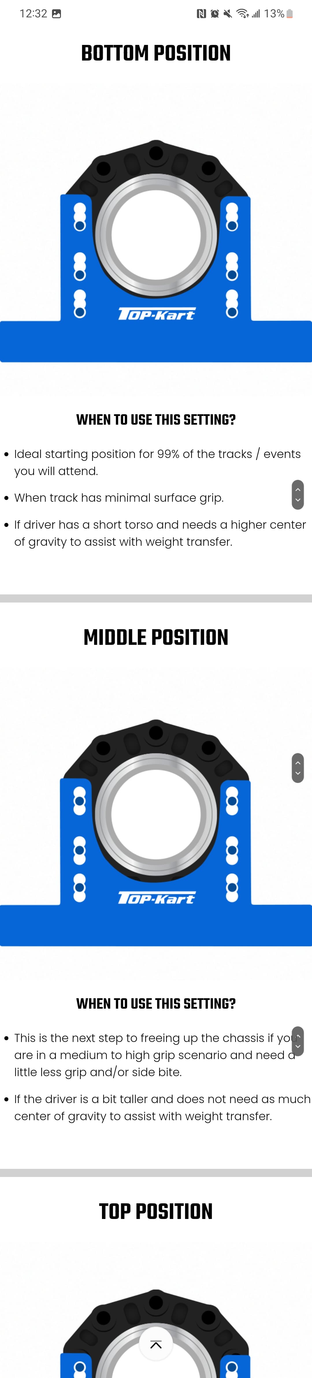

I’d also think that at your height/weight, frame high, axle low is probably the opposite direction I’d go unless it was about 40 degrees out. Or raining. You are loading that outside rear awful hard and just may well be cooking the outside rear on a long run. Assuming your earlier in the day runs are shorter practice/qual sessions and your final session is a considerably longer final?

You may be correct about the ride height, I just assumed it would be fine for 99% of the time but the track gets pretty grippy for a club track.

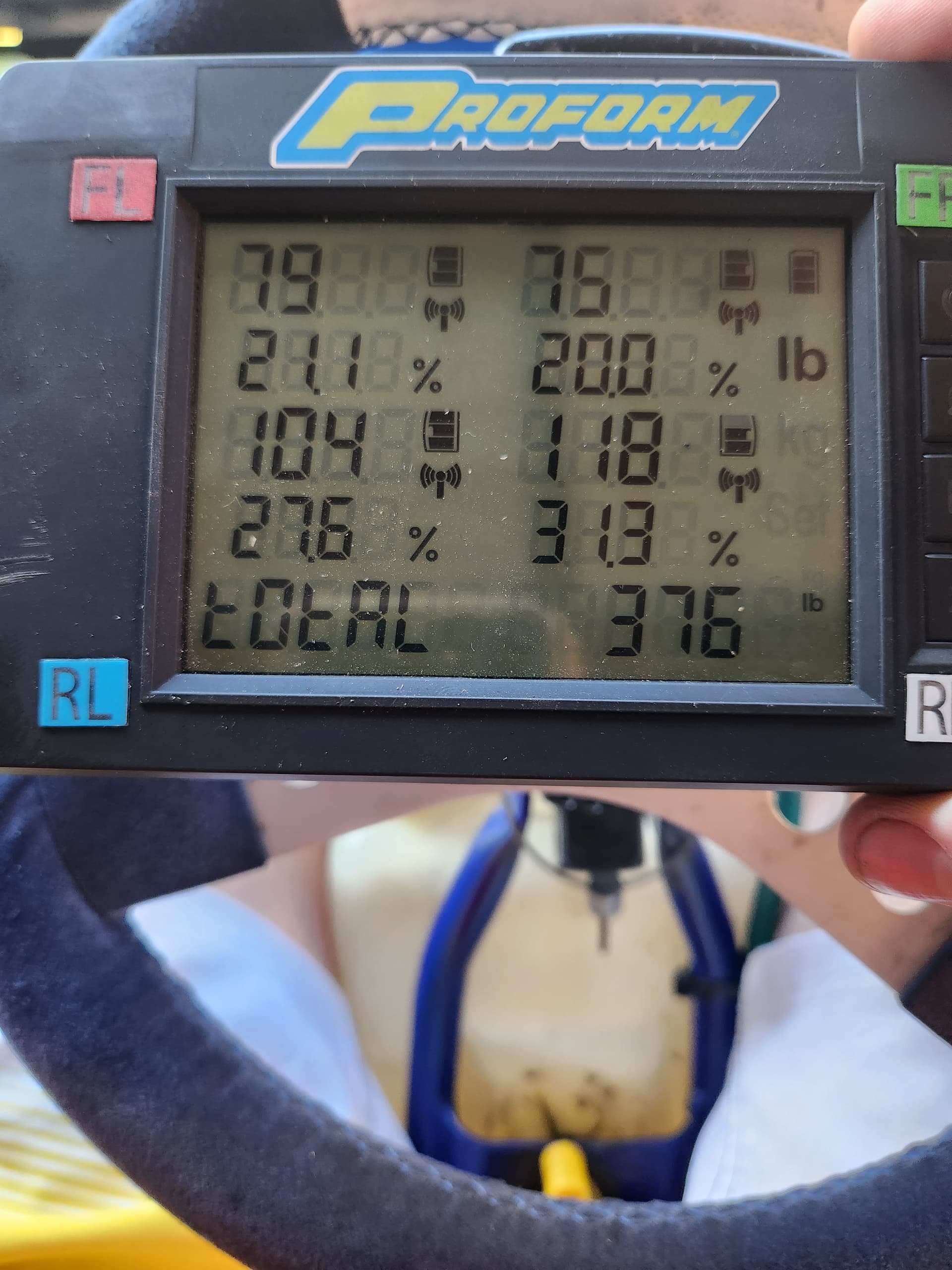

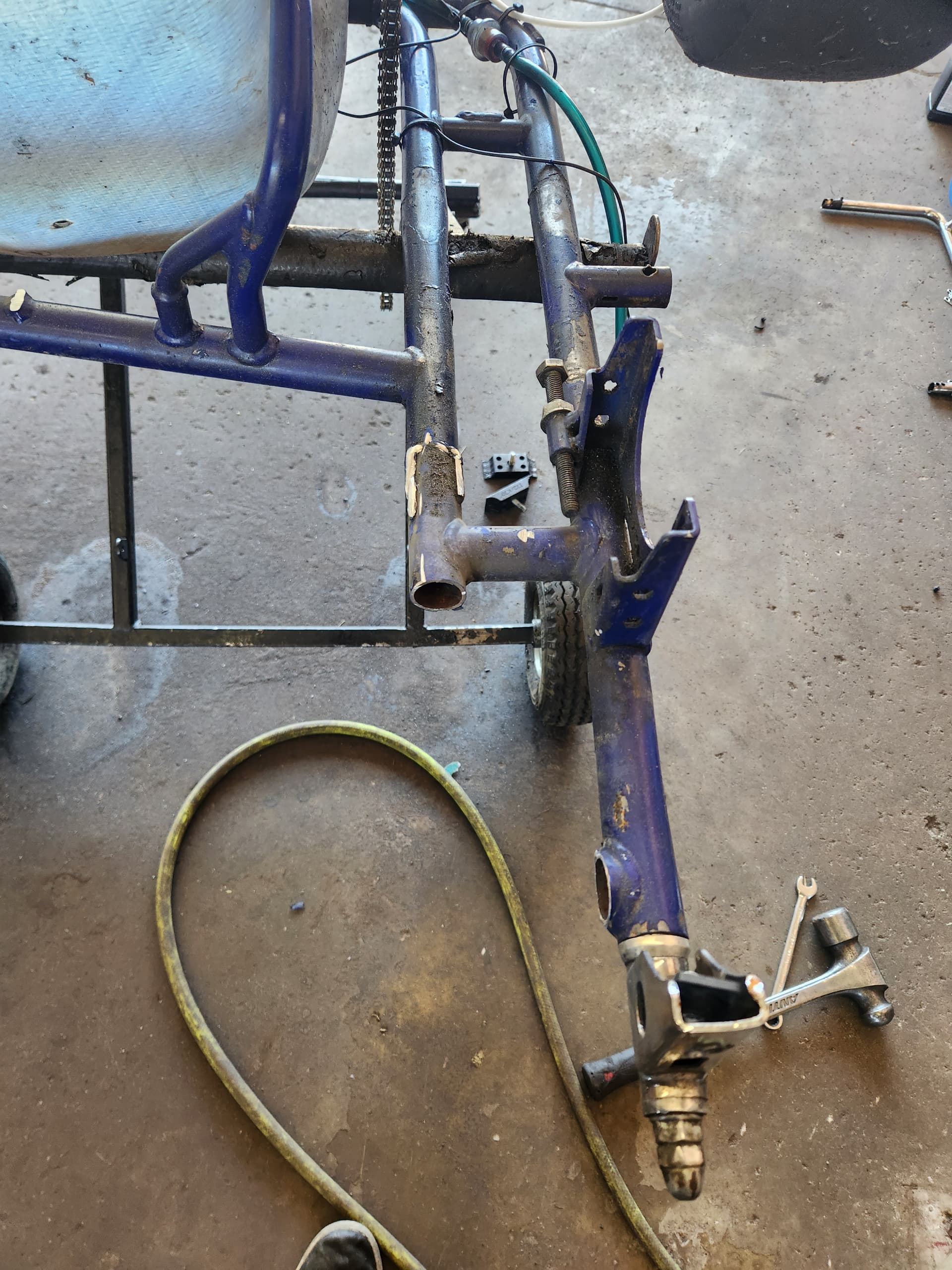

Alright y’all I did the thing
Before

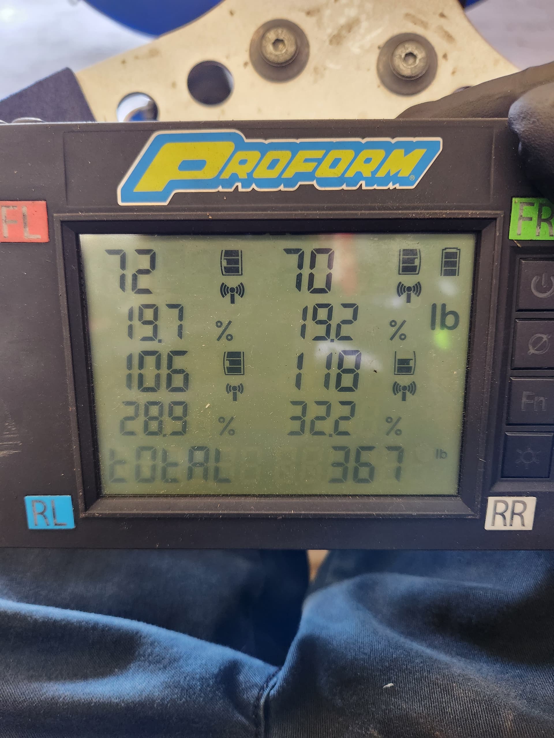

After: with seat moved forward and a little over a half tank of fuel. I might use less fuel and put a small weight on the front.
Going to send it tomorrow at a track I’ve driven a shifter kart at but I have never raced there.

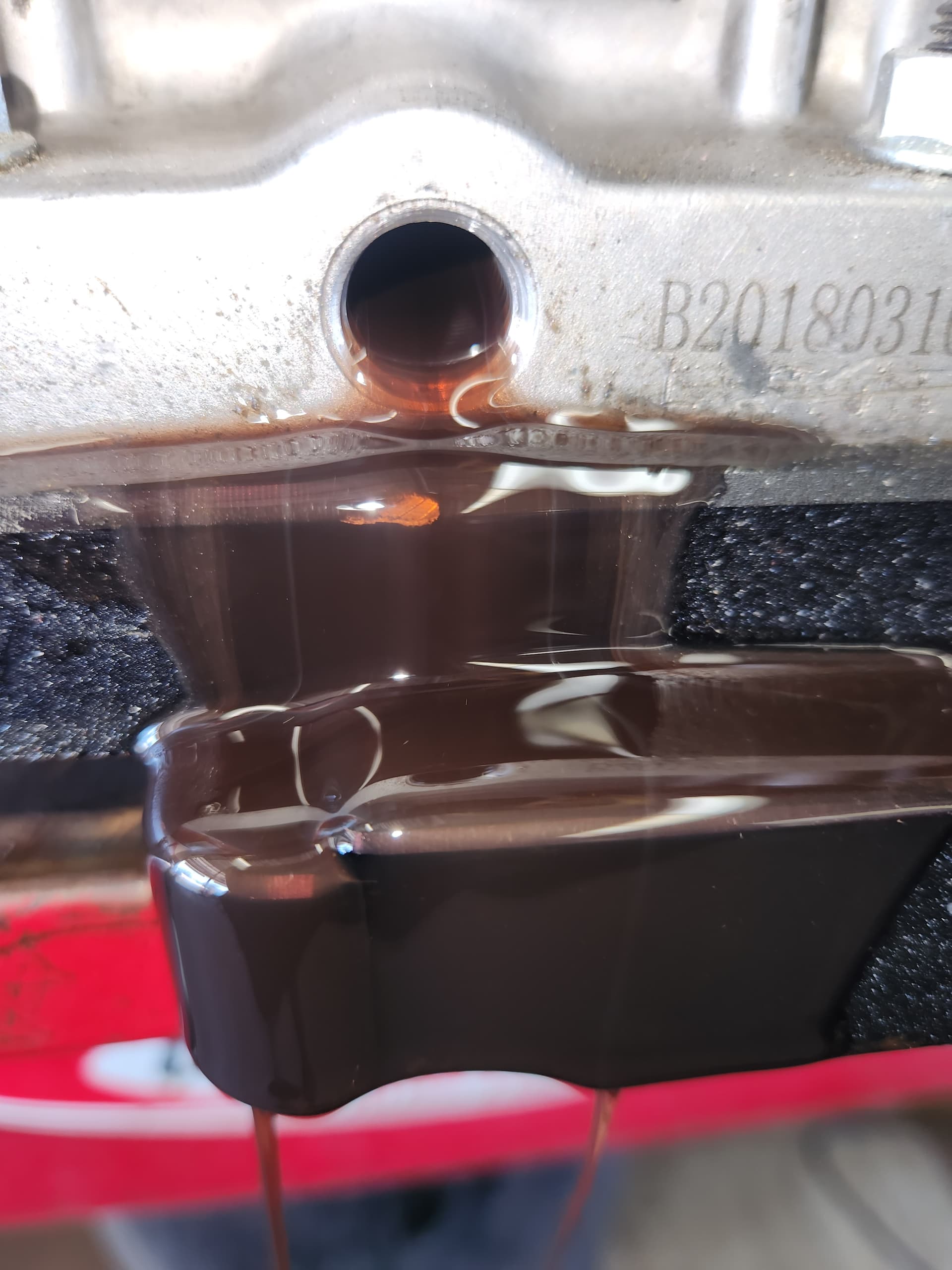

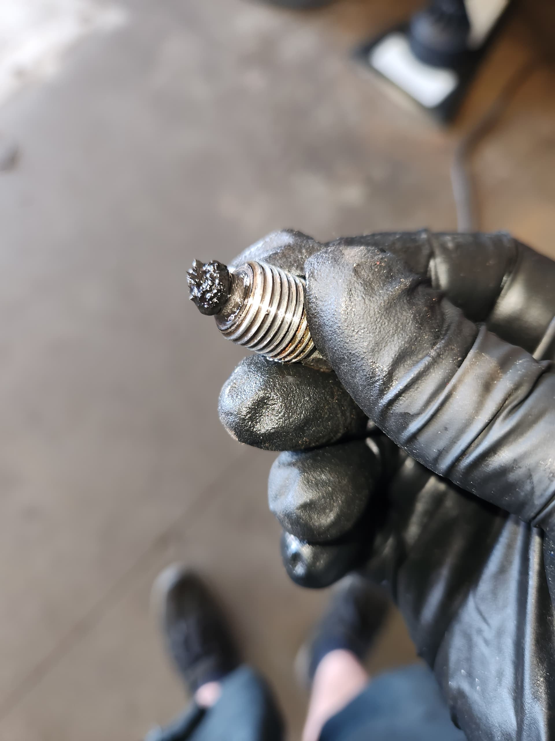

Metallic oil probably not good
That’s what I’m talking about. :grin:
Not ideal, but i have seen worse. Change it after 1st practice tomorrow and show us how bad it is.
