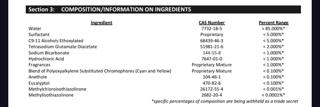

From the MSDS. There are a couple things in there bad for rubber. If you’re mounting tires for a weekend and using them up, I don’t think it matters.

There is definitely a big difference between spraying a tiny bit on the bead surface and it evaporating in 60 seconds vs. Soaking the contact surface and wrapping it in plastic wrap. Even if it doesn’t end up affecting the performance the intent to do so was still there….
