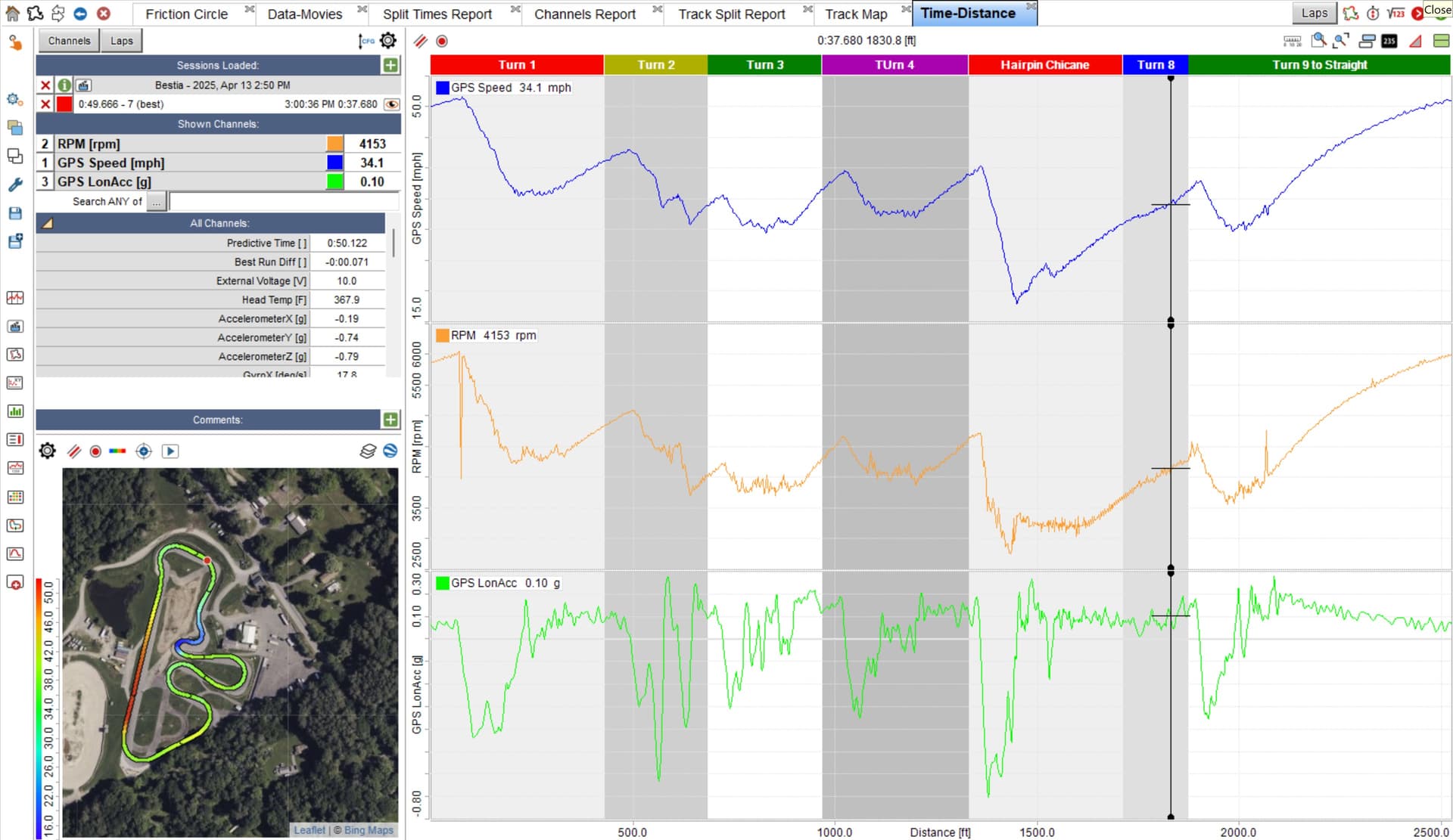

This one is a pretty standard time distance showing speed, rpm, and long G. I like Long G to show my (poor) brake work.

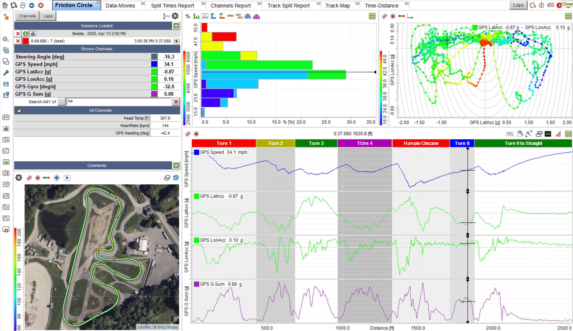

I like a view similar to this showing the friction circle top right colored by speed, historgram of speeds colored by RPM next to it, and the standard time distance below. The track map is colored by clutch slip (RPM/speed).

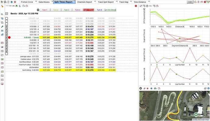

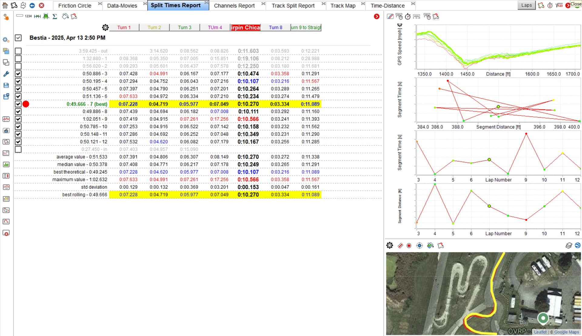

The segment report - shows I was consistent but certainly at a plateau. I was 2 seconds off the class leader, so I was driving to a comfort level.
