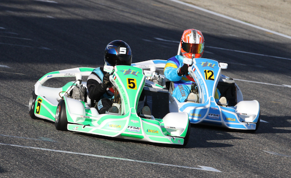

Speaking of aero. Here are some karts from France with bodywork.
“We have these in France, X30 175cc super shifter with a full carbone chassis”
Yep they use this in France (2s slower than a kz and small bit on carbon like the floor tray, everything else is fiberglass, 6inches tyres)
It’s a very very small class in France, maybe 20 drivers max because is slower than a kz, ugly AF and expensive
