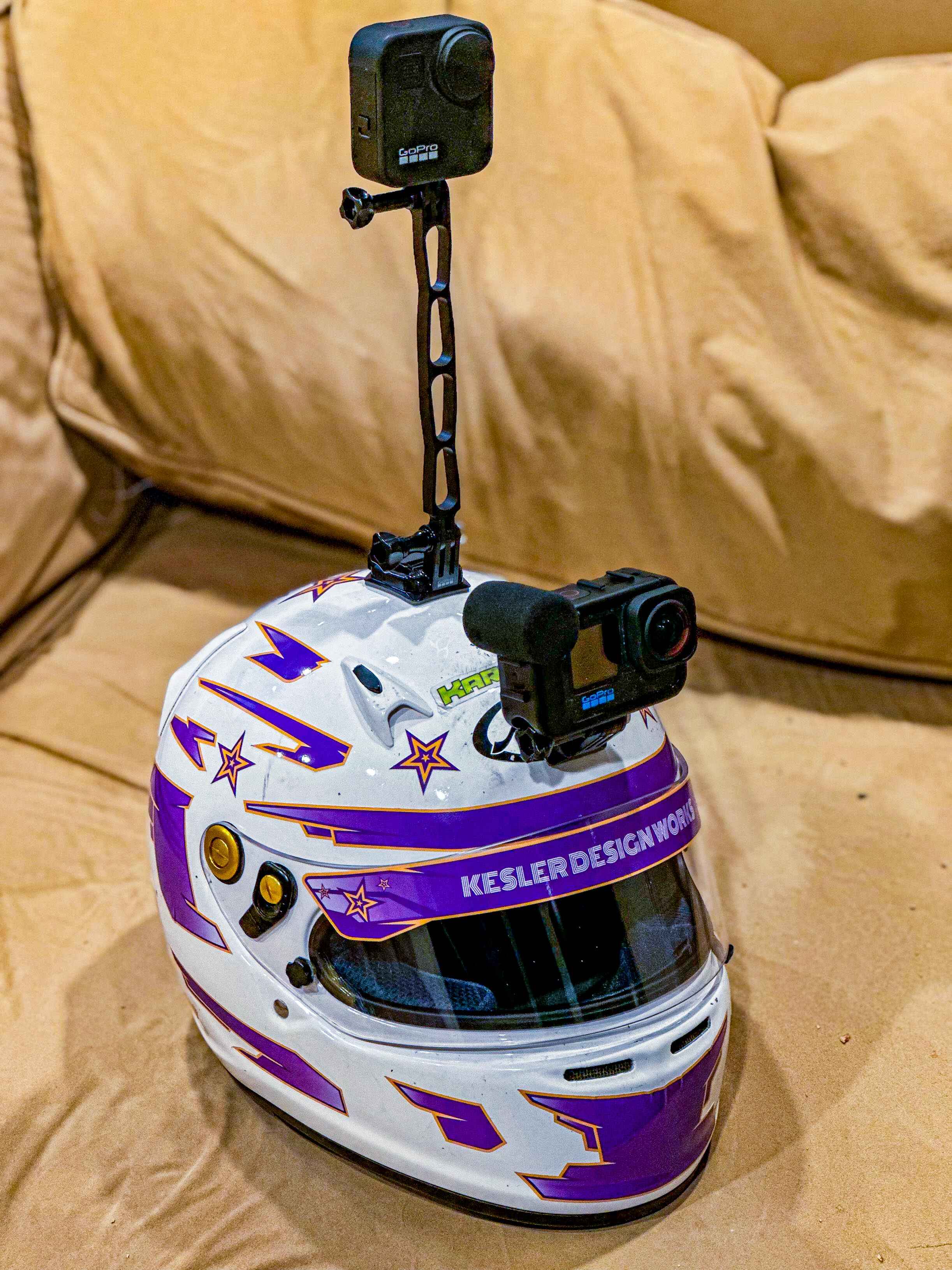

I mount my SJ-4000 Cam (Go Pro Clone) on chin of helmet, if I were to get a 360 Cam like insta 360 3x, where/how would u mount? I have no fears about loosing my current cam using a frame mount.
The problem with a 360 cam is that it needs to be on a unicorn/narwhal type mount. Because it’s 360, if it’s not raised off the surface, the bottom of the image is all helmet (or whatever).
You could attach to frame or radiator I suppose. But, it needs to be elevated with the post in the “blind spot” directly beneath it.
