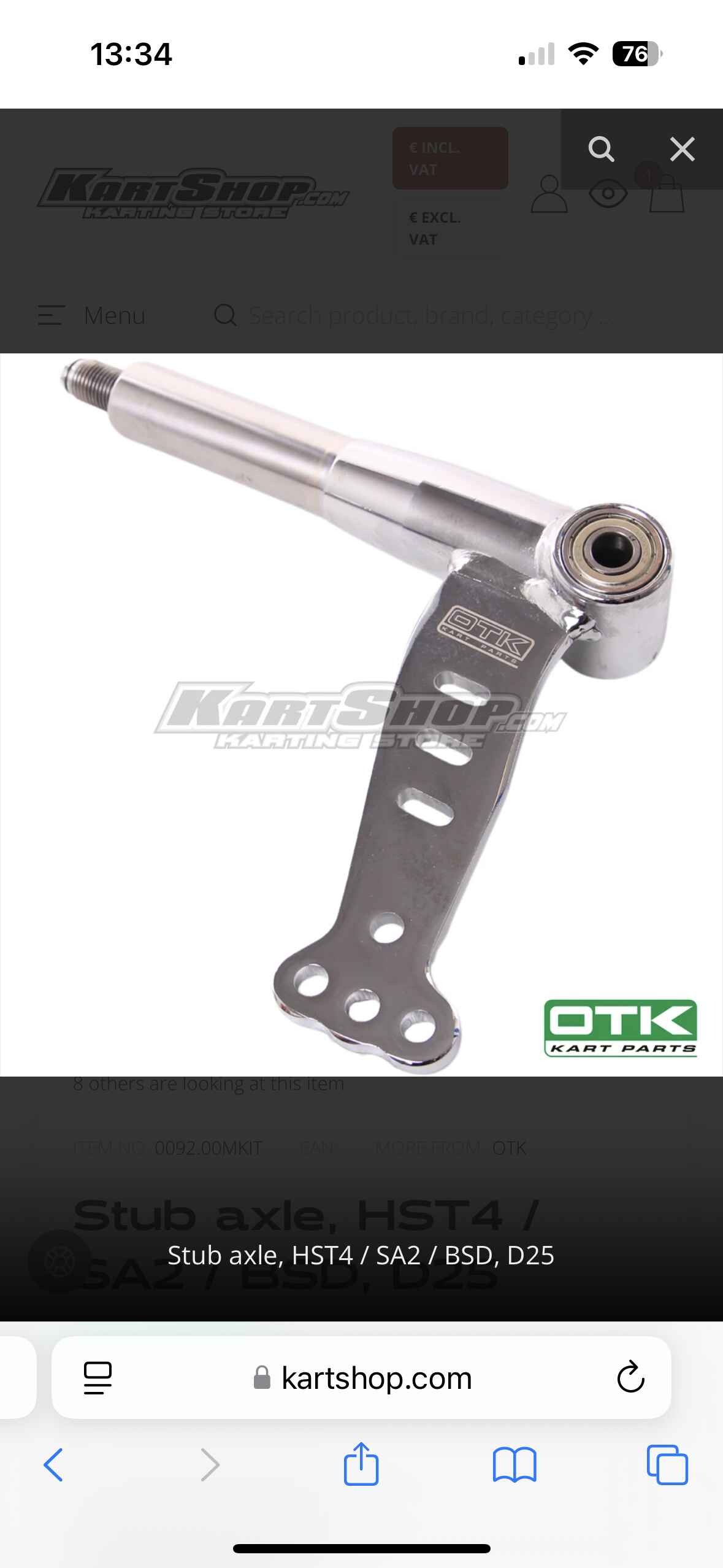

Looking at OTK pictures i have seen they are using some kind of extensión to change the ackerman, I think they are also trying in the ofificial team to reduce the responsiveness.
And just today, one of the most known OTK dealers in Europe, Kartshop, has announced a new stub axle with different ackerman settings. It seems they are working in the same direction:
Link: Stub axle, HST4 / SA2 / BSD, D25
What do you think?

Ah Ok! But the new stub axle from the shop is intended for senior OTK`s

Have you seen the new stubaxles i posted a few messages above? They should help making the steering less direct. Anyone knows on which hole the tie rods should be screwd to in order to have a less agressive steering?

It seems something quite official from OTK with the reference : 0092.00KIT
The description I found on a website is : “This bolt on kit extends the steering arm out to increase leverage and makes the front end easier to steer for high grip tracks and smaller drivers” ; I’m from the same opinion of Simone that commented, I don’t believe this is the real fix.
