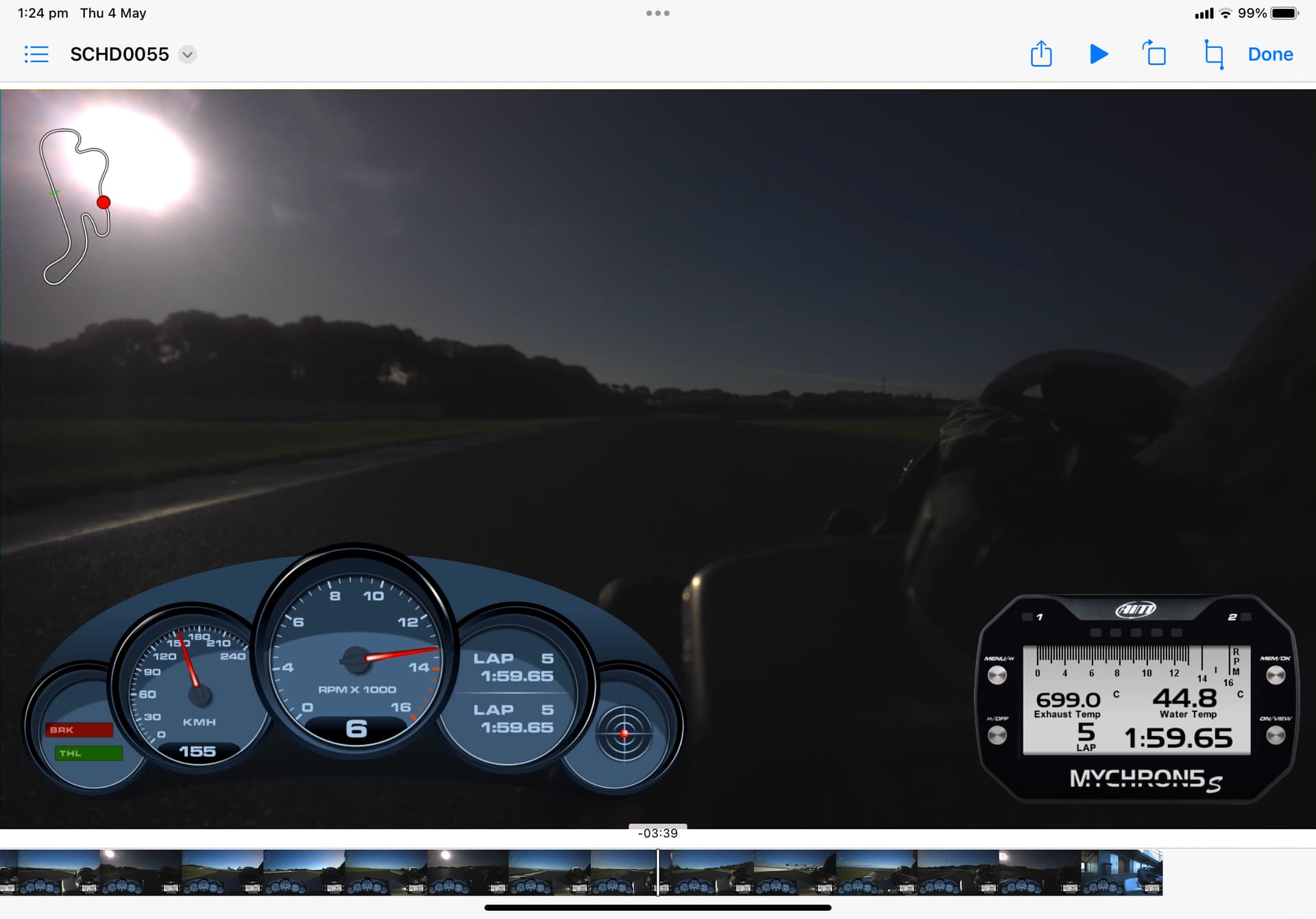

Image 1 below is me coming out of Siberia at Phillip Island heading north. It’s late in the afternoon, the sun’s in my eyes and thus the SmartyCam 3 lens (so the image is even worse than usual) and there was a brisk southerly, so my engine performance seems to be better with a northern run (goes to support Evan’s thinking on the air-box inlet orientation). Remember this is the Southern Hemisphere, hence the sun orientation. Ignore the indicated gear selection in the tacho - for some reason the MyChron has got itself confused. This image is me in G4 just shy of 14,000 rpm (and a ground speed that is close to James’ spreadsheet). The EGT is looking good. I’d say all happy at this point, no complaints. Yes, I know the water is colder than ideal, but I just couldn’t get the temperature up - a massive stock radiator which I may need to change

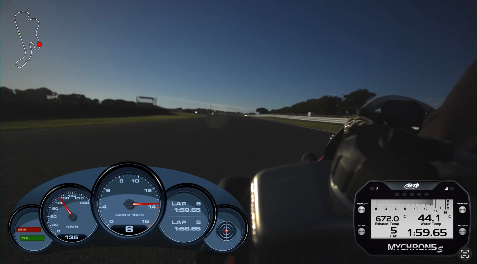

Image 2 below is in G5, starting to bog at just under 13,000 rpm and the EGT heading into an uncomfortable zone (assuming there was no fuel being burned off in the pipe and giving off a deceptive EGT reading - but thanks to Ricky’s suggestion, I reckon there’s a good chance that’s happening). Again my ground speed against the RPM for the 20/21T gear set is looking close to James’ spreadsheet.

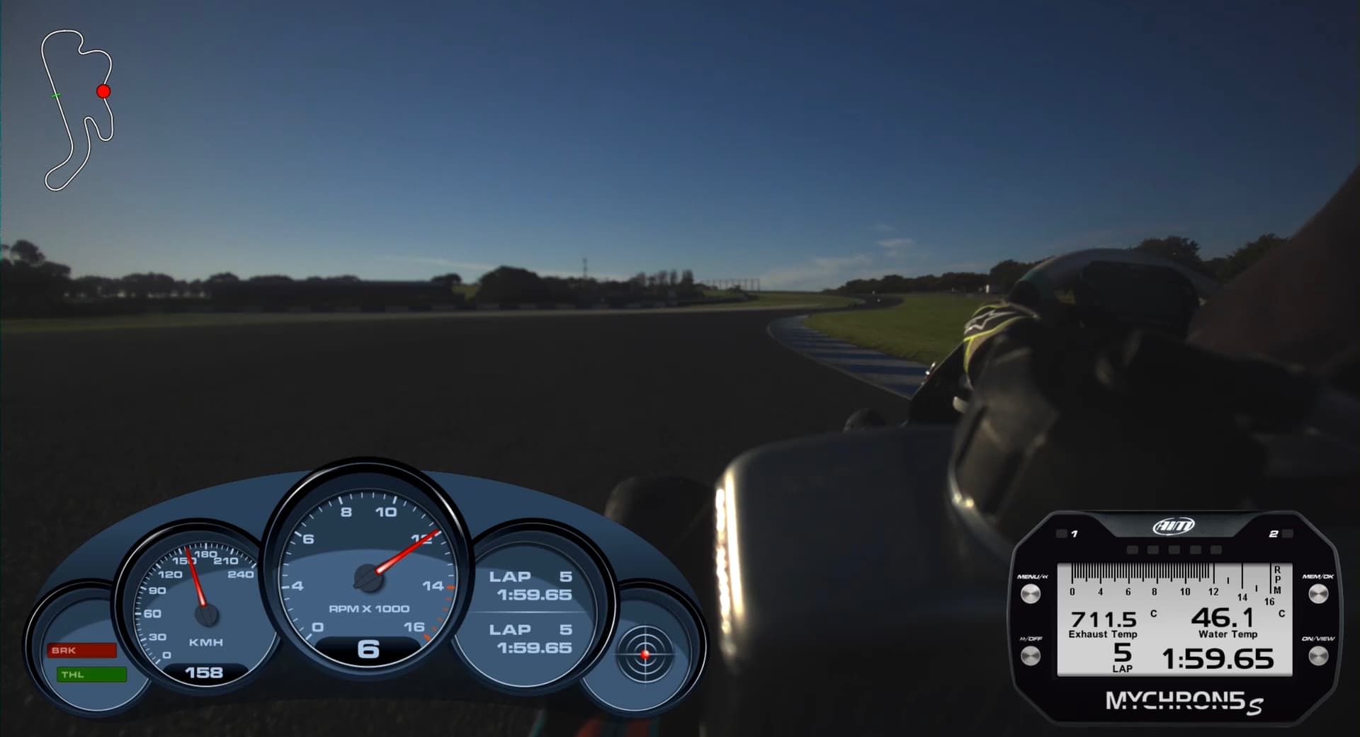

Now image 3 is being in G6 having short shifted from G5, hopelessly bogged and EGT worse (goes a bit higher then but immediately starts to fall despite my foot planted, and speed starts to fall). Not happy.

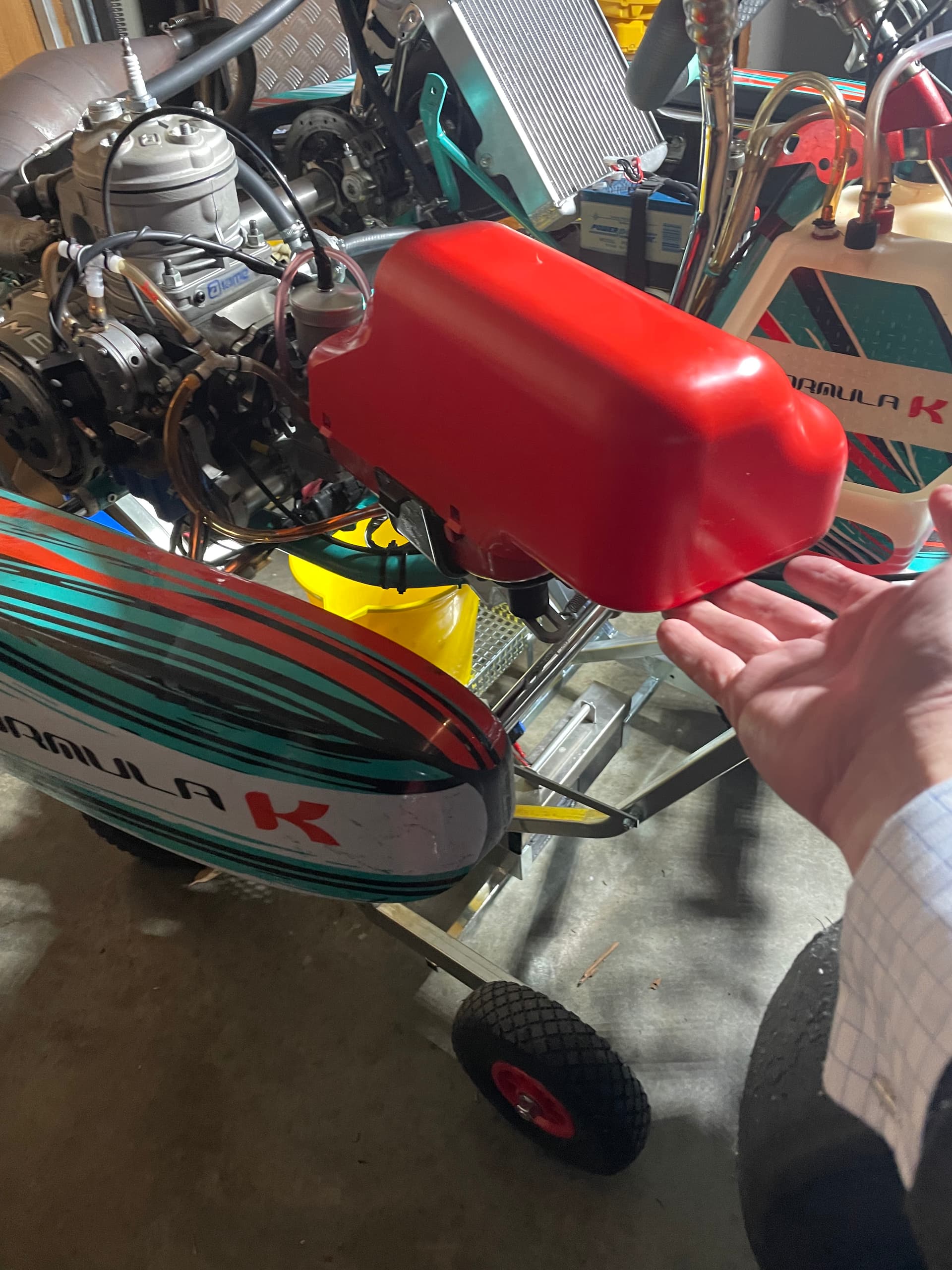

Evan, a very logical suggestion given my circumstances. However, I have now tried the top flip but unfortunately the inlets foul with my Dellorto (probably okay with the lower level Tillotson). As an alternative, I wonder if I could use my rain cover? I’ve never used it before and I’m not sure wherther it will do the opposite and restrict needed airflow too much at lower speeds. Any experience out there? I suppose just need to test and see what happens.
Images below
I’ve used the rain cover before, but only on a sprint track in wet conditions. I suppose it couldn’t hurt to try, but you may be better off buying a Righetti Active airbox, as it won’t interfere with the carb when flipped.
Have you tried covering one inlet when at speed and in 5th/6th gear? Another easy test to see if it helps/hurts the mixture.

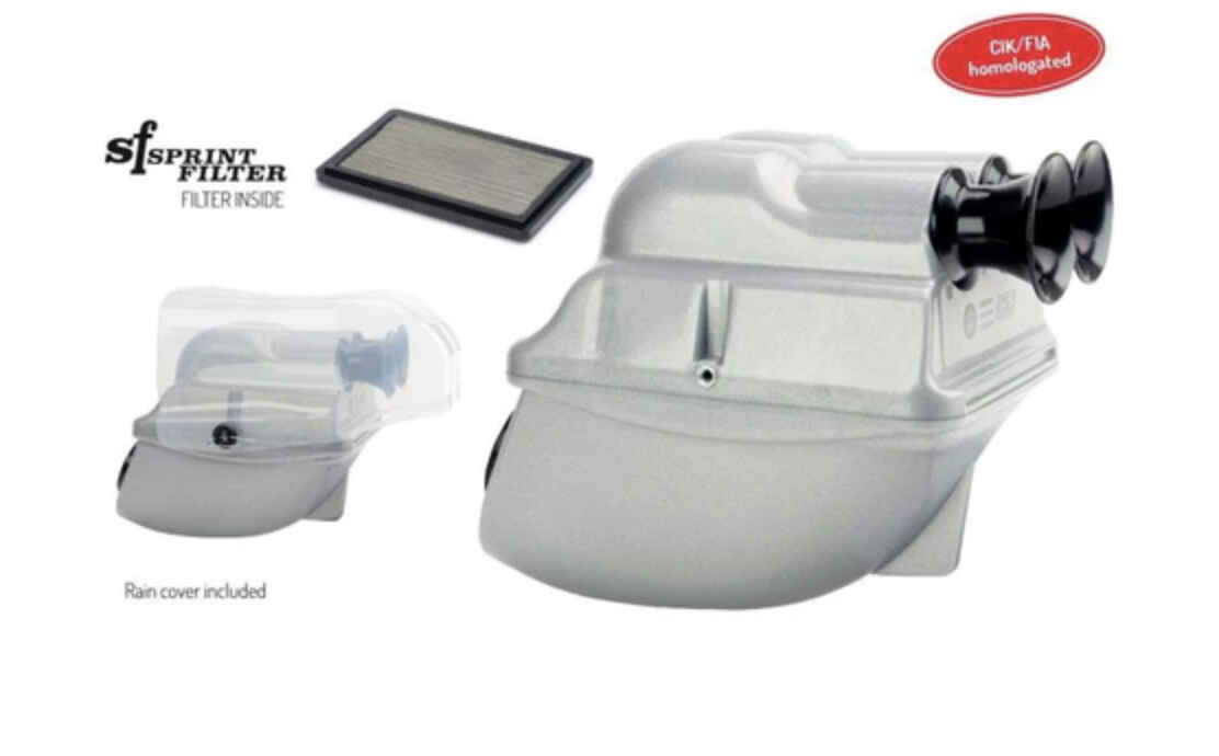

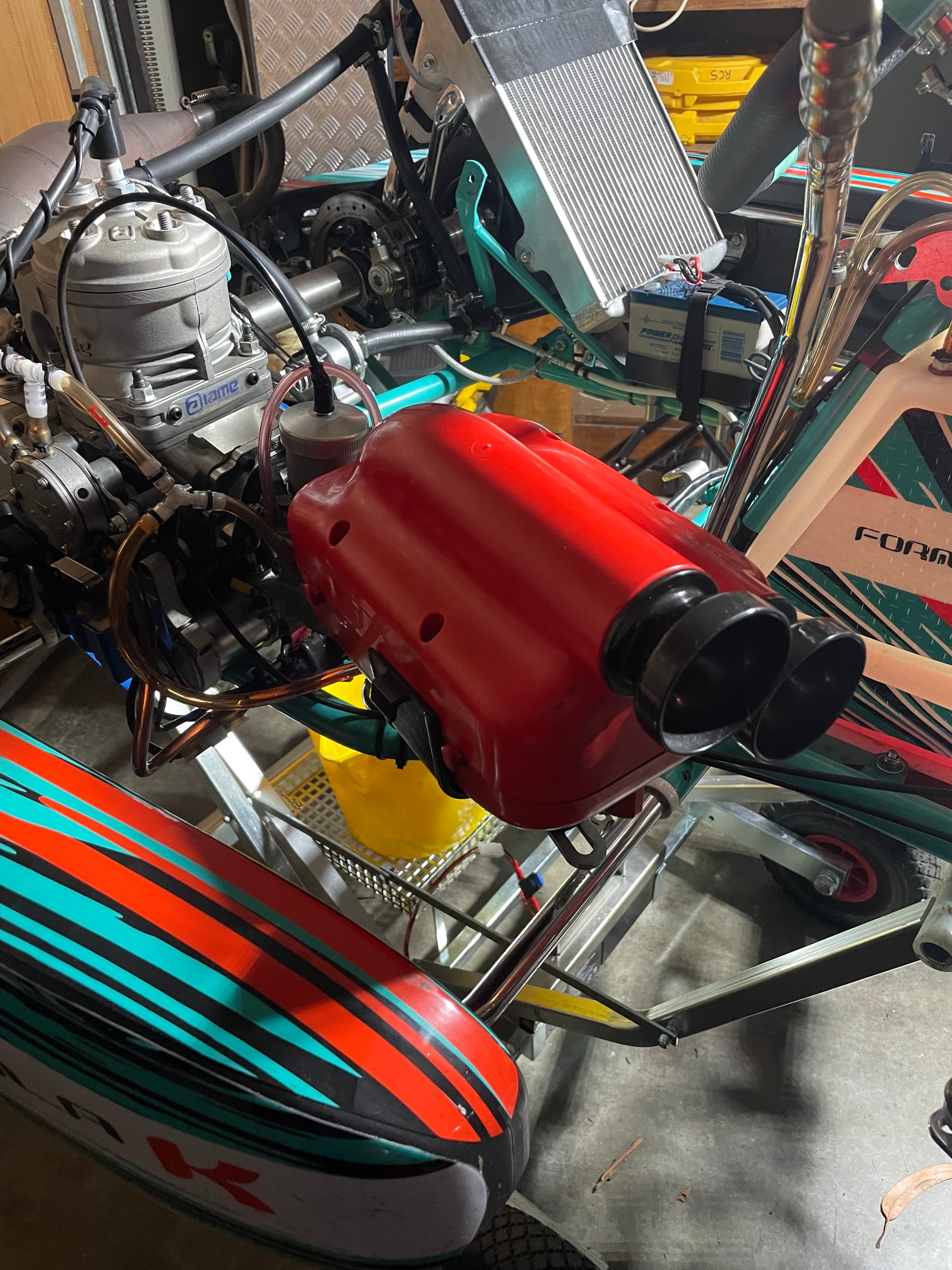

Anyway, I’m going to try out a different airbox as suggested. I have noticed that all of the KZ drivers at my local sprint track are now using the Righetti Active airbox. So that would seem like a good suggestion. However, our local homologation for the 175 SS does not provide for it and for the moment I really don’t want to move outside our “stock” framework. Instead, the KG Nitro Airbox (30 mm) is available in the homologation, which I know has been around for a while. The literature for the box talks to a static mode as well as dynamic, with images of the inlet half flipped. That’s positive. It also seems taller in design than my current airbox (being a NOX 30 mm) , so presumably won’t be fouled by the Dellorto.
Picture below.
So, unless there are any counter thoughts, I’ll try that and report back in.
That all sounds good. Technically the one you have pictured is the KG Power, which is an updated version of the Nitro, and is substantially more expensive.
