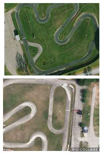

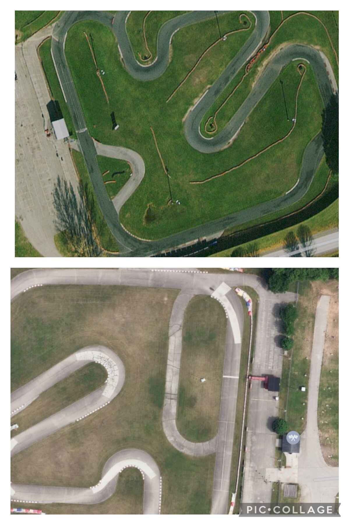

Start/finish is farther down the straight at Badger vs Goodwood. Pic gives you an idea.
If you are on it entering 1 you will hit it again between your 3-4 if you’re getting through 1 well.
