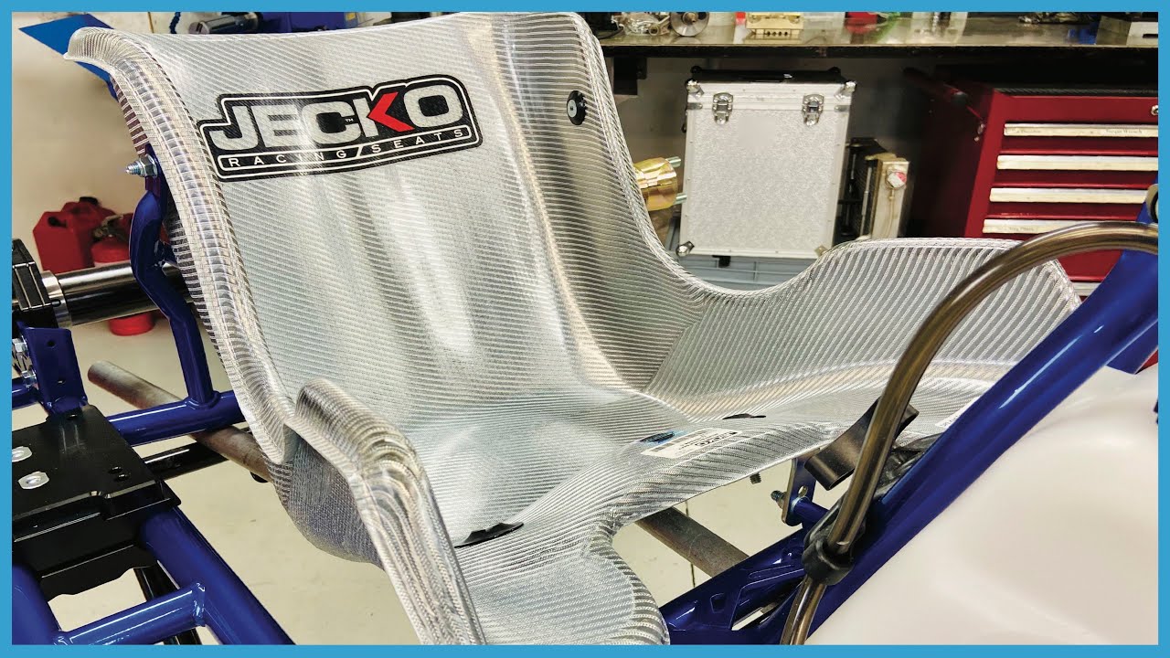

I’m going through all the seat positioning/installation gymnastics today, and I’m running into a lot of the issues mentioned in this thread. Using the “axle to drivers back” measurement does indeed seem like the magic bullet to cut through all the bs. IMHO, OTK should switch or at a minimum mention the seat size used in their measurements (and how to compensate if yours is different). Thanks to everyone who contributed here for saving me time and hassle.
Yea, I’m playing this game right now as well. Jecko calls for 11.5-12cm for Axle to drivers back for a shifter(Interesting that Tillett want’s at 13, I guess that’s because of seat back angle differences in between the two seats?)
In any case, I’m just going to go ahead and and send it at 12cm, 1060 from Left Kingpin to top of the seat back and parallel with rails on my IPK Jecko and hope for the best (IPK based chassis)
Tillett calls for a longer measurement because they suggest measuring to the “flat” part of the back of the seat due to variability in the ridge down the middle.
The dimensions you mention are a good starting point. The kingpin to seatback measurement can be a little tricky due to differences in seat back height. Some of the Jecko seats are quite short, so that dimension may measure ~1cm shorter than it would for a standard seat.
This may help a bit , it help me when i was installing jecko seats
I went to buy my first seat recently and upgrade from the one that came with the cart. I opted to have Tommy at Texas Carts do the seat swap for me so I could try to watch and learn. I am SO glad I went that route!
