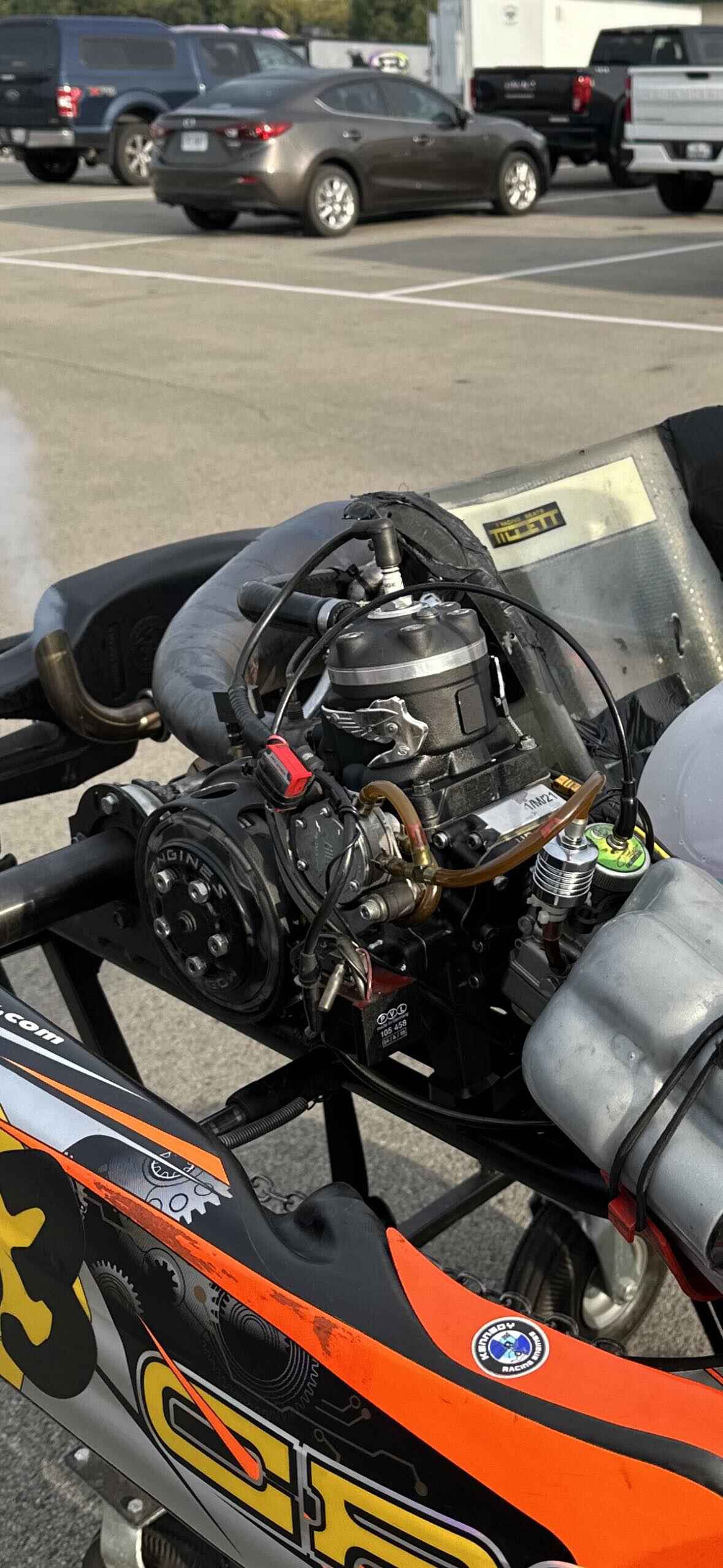

Carb settings typically change between manufacturers but theyre in general pretty similar. I can only speak for Modena since that is what I run. Ill run a 270 emulsion tube with a k28 needle, 55 slide, and main jet usually around 160. I can speak for pilot and inner pilot since I do not know them off the top of my head (most of the time I never touch them) and wont have access to it for another month or two since I am out of town. We also run a heavier float weight and dont run a flow back to the tank. Just the fuel pump to the carb and thats it. Heres a photo of the engine setup with fueling and a video of the modena kk1 at my local road course which is flat out majority of the lap. I was toying around with my gopro so the camera angle isnt so great…
