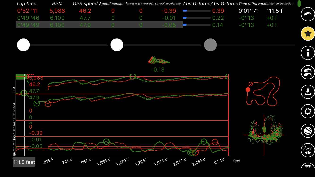

All good suggestions here. Do you have any data, speed traces to compare? May be some clues there too.
I have alfano data, not sure how to share though.

Throw up a screenshot of your alfano data overlapped with the two sessions

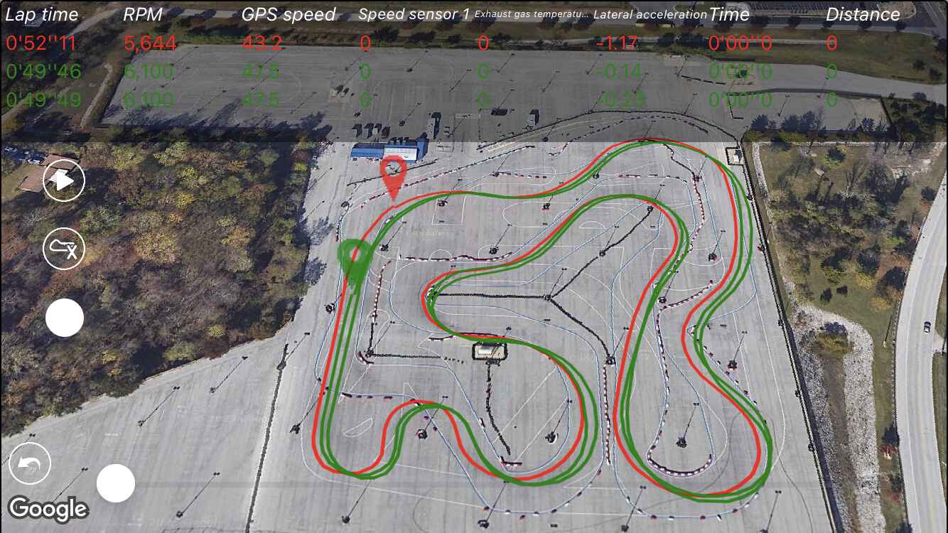

Track map - I guess 8/9 corners
You’re down 400 rpm (20)
The -400 is at a different spot on the track.
Ah I see now
20 char
Unfortunately my Alfano gets confused about starting line.
