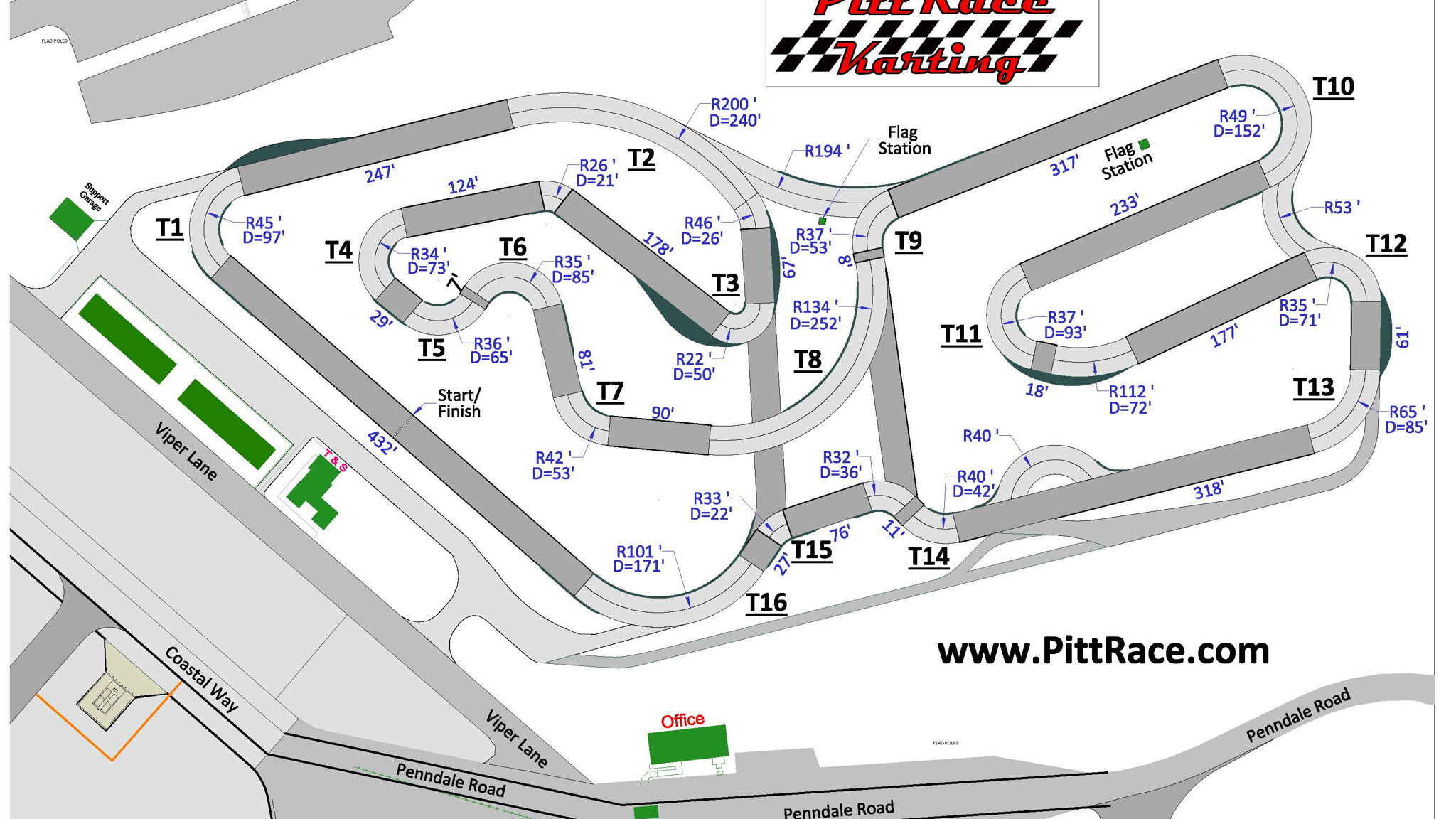

Tracks with a lot of curves?
My local one has long to medium straights and I doubt someone could make pole with used SH2 tyres.

Pretty technical track with off camber turns. And big run from the back all the way to Turn1.
