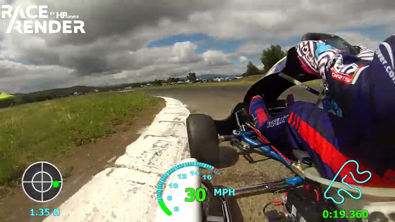

Last week, a KP member & top-level driver: Nik Goodfellow (@NikG) posted a P1 qualification lap video in the (Weekly) KartPulse Racer Videos Thread, that pretty well demonstrates expert rotation control. I encourage you to watch it multiple time (in slow motion too), and pay attention to how he manages the orientation of the kart on the line he is driving, throughout the whole lap… but especially pay attention to the exits of the slower turns.
