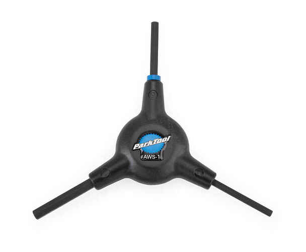

Park tools tri wrenches, the bigger one is 4, 5, 6mm, the smaller one is 2, 2.5, 3mm.
As a former bike mechanic, these are never far from my hand.
