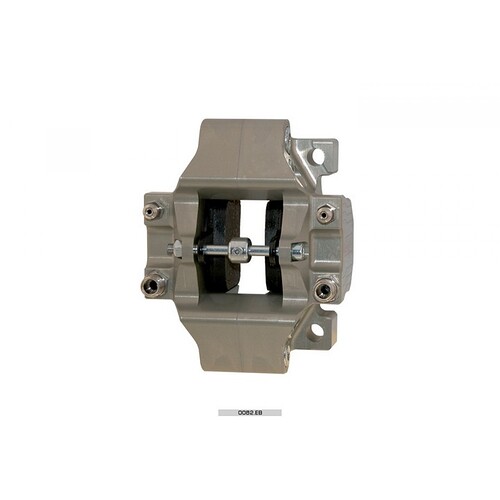

Okay. Got back to working on the kart only to discover I’d lost pressure in one line. I opened up the caliper after some bleeding (which yielded no results) only to find one of the seals had perished. Bits of seal all throughout the piston chamber.
Having had enough, I decided I would just rebuild the whole system to leave no margin for error.
(For reference, I’ve been having braking problems a lot longer than this post has been up.)
Rebuilt the master cylinder and caliper completely, managed to get pressure back and regained enough braking to take my kart to the circuit!
I ended my first stint after 10 minutes only to find fluid had leaked through the caliper seals all over my pads and rotor.
Seals I’m using are suitable for ‘‘BS6’’ systems. I can’t find any information on what connotates a BS6 system over a BSD and SA-2 system but other websites selling the same seals assure they are fine for all three.
In which case am I using the wrong fluid? I ask this because I know that DOT 5.1 is standard for BSD systems, and by that logic, the BS6 + BSD + SA-2 seals I’m finding should all work fine with that fluid?

Caliper seals were both incredibly rounded off on one side which would explain the leaking. This was after 7ish minutes of track time.
I’ve rebuilt the system with new seals yet again along with some DOT 5 fluid as opposed to DOT 5.1 after cleaning everything out.

My rotor was off center in the end causing the pad on one side to bind. The rotor carrier seems stuck to the axle as I’m really struggling to move it over. I did manage to get it centered after a bunch of convincing but the pad is still binding!
After closer inspection it looks like the piston isn’t retracting on its own like the other one is despite the rebuild. Swapped both pads round, bled some of the fluid out and kept resetting the piston but it would always push itself out straight back into the rotor again.

Bruuuuuuh :neutral_face::neutral_face::neutral_face::neutral_face:. See if the springs in the brake caliper are still there holding the pads. In motocross bikes you don’t have this springs, and one day I removed them from my kart just to see if they are useless or not, and I had the same issue than you.
OTK calipers are springless. :pensive:
You lock the pads in with the bolt and locking bush as seen below:

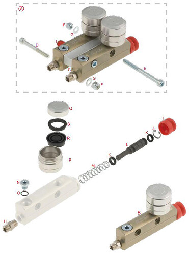

The springs is located inside the master cylinder. When you let off the brake pedal, the spring pushes the piston back to rest. Check that both master cylinder springs are the same length.

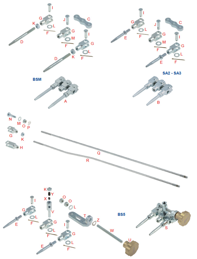

An easy visual examination of the T bar at the end of the brake rod should tell you if both pistons are returning the same amount.
Looking at parts A/B, the two push rods should stick out equally from the master cylinder when at rest. If they don’t, open up the master cylinder and start checking things.
His caliper has springs which are connected to his brake pads, that’s what he was referring to.
But I will check this regardless so thank you for the suggestion!
I know. I was pointing out that the OTK system is not technically springless. The caliper is, but the Master Cylinder is not. If the pistons in the master do not return equally, then one pad will not return equally either.
