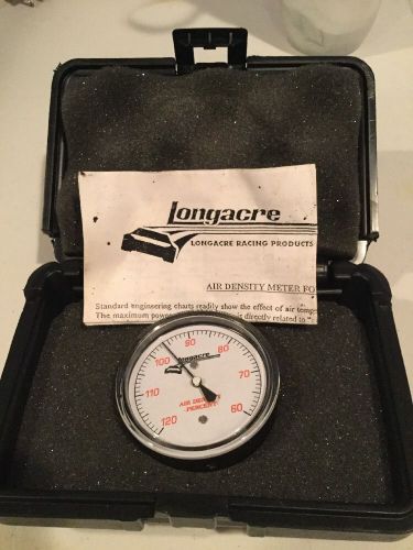

A RAD (Relative Air Density) gauge is a one way to go. It won’t show humidity, but the affect of that varies wildly. RAD will get you in ballpark and give you a good reference point.
I have something like this…

All of these methods require you to have a baseline to go from for your motor package… nowadays these baselines are common across the same engine modes and brands in spec series. In the past that was not the case… you’d really need to baseline your own equipment.
Hypothetical baseline example… Say you find the best jet for your kart on the day was a 100 (0.1”) and the RAD was 100% that day.
Next day you arrive at the track and the RAD drops to 96%, well now you need to drop your jet AREA by 4% to have the same jetting. Area emphasized because many (not all) jets are sized by diameter.
At the end of the season in morning practice you see the RAD at 105%, you better jet up or kaboom (at least with the high performance two strokes) :joy:

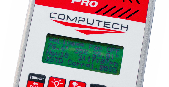

These are the kinds of calculations that the race air pro can do for you. You enter your baseline jet and ADR (Air density Ratio), it takes an air sample and spits out a suggested jet size based on the information you gave it.
This is a little harder with screw based pumper carbs of course, but knowing the air density can be a valuable tool to guide decisions… Weather it’s from a race air pro, a local weather station via your phone or your trusty analog RAD gauge.

I’ve never seen a app either. Longacre has some instructions for the use of their air density gauge online. Basically it says to compare jet settings to performance. On that day when you’re running your best, write down your jet settings and the air density, use that as your base and adjust accordingly. You a 1% change in air density calls for a 1% change in fuel delivery. I have Excel spreadsheets for calculating changes in jet sizes. Email; [email protected] for your free copy.Good morning thank you
