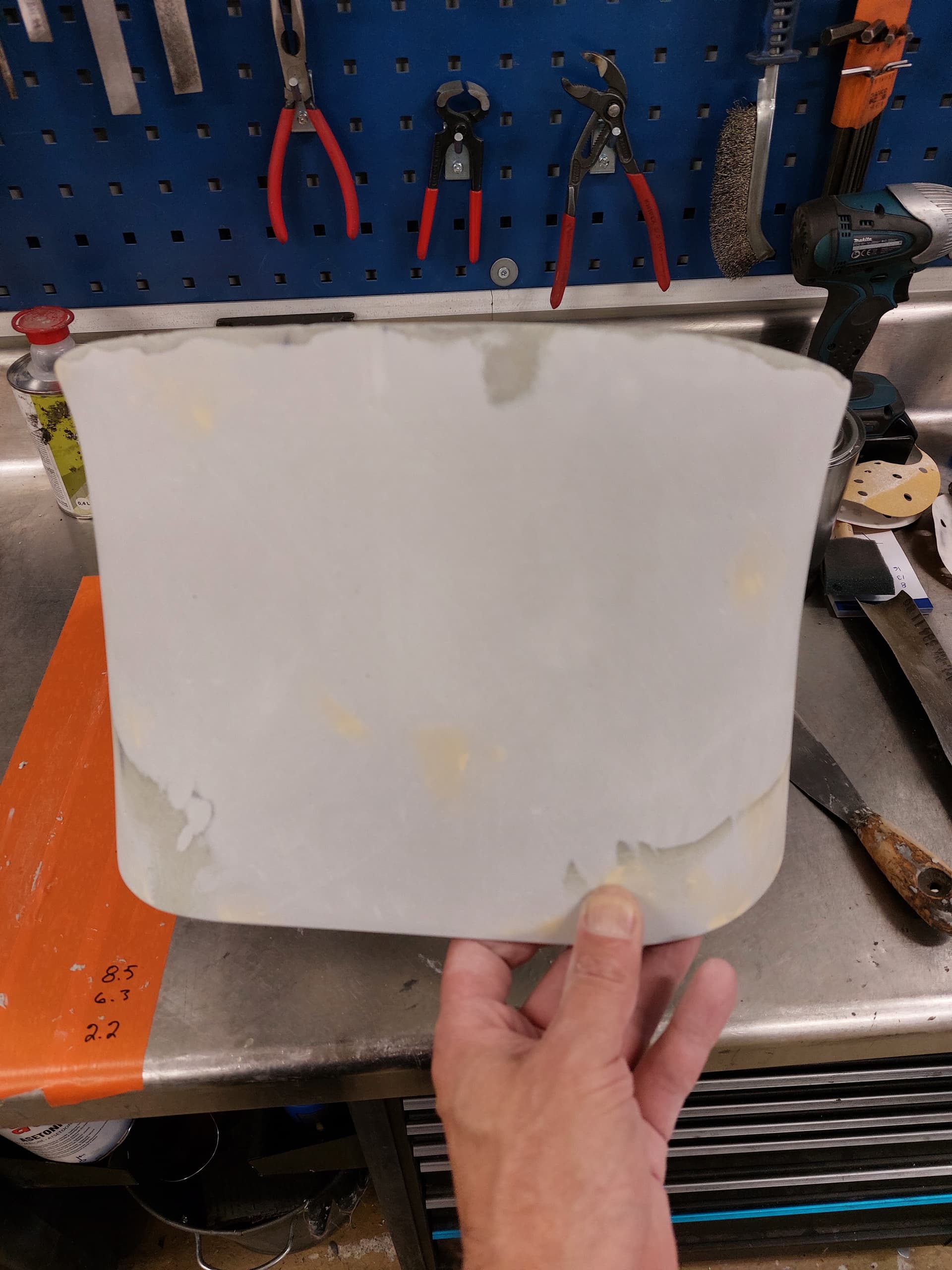

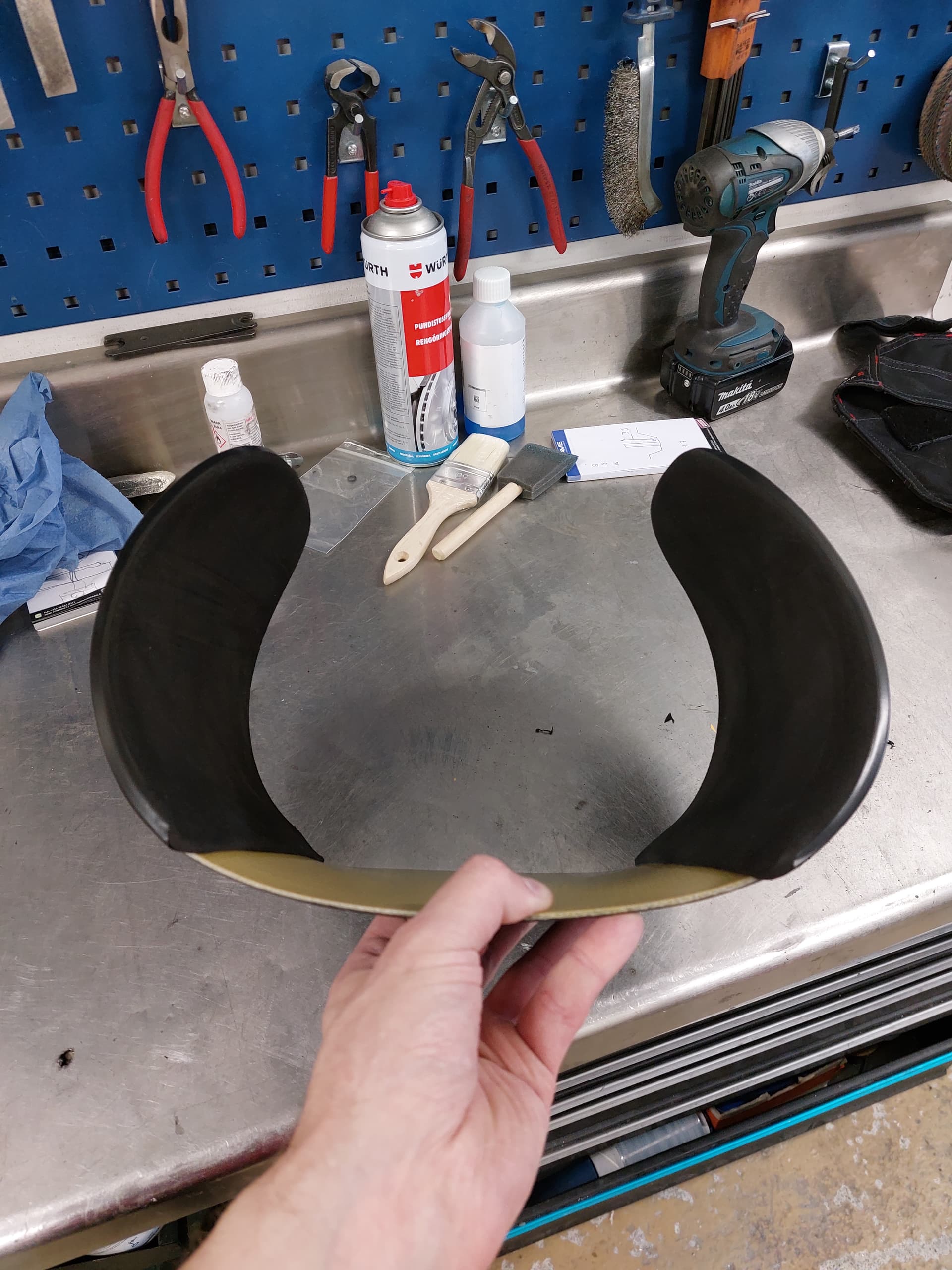

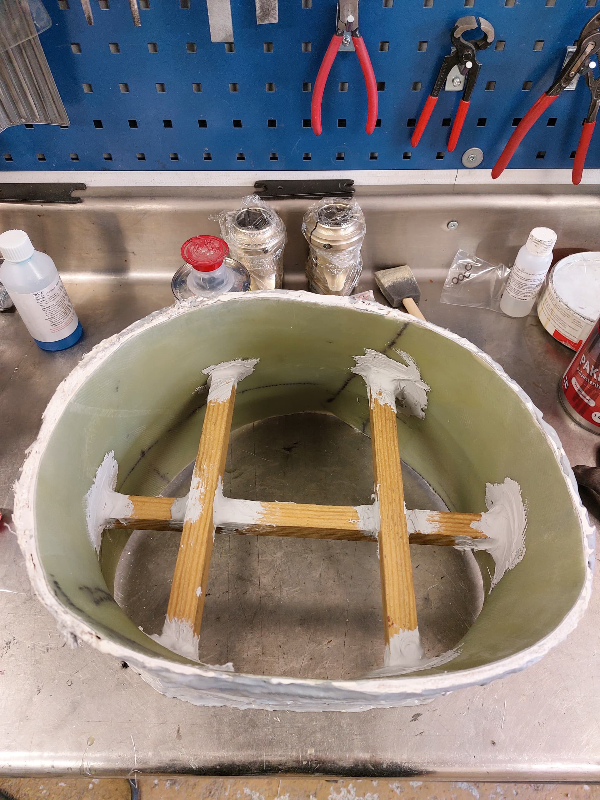

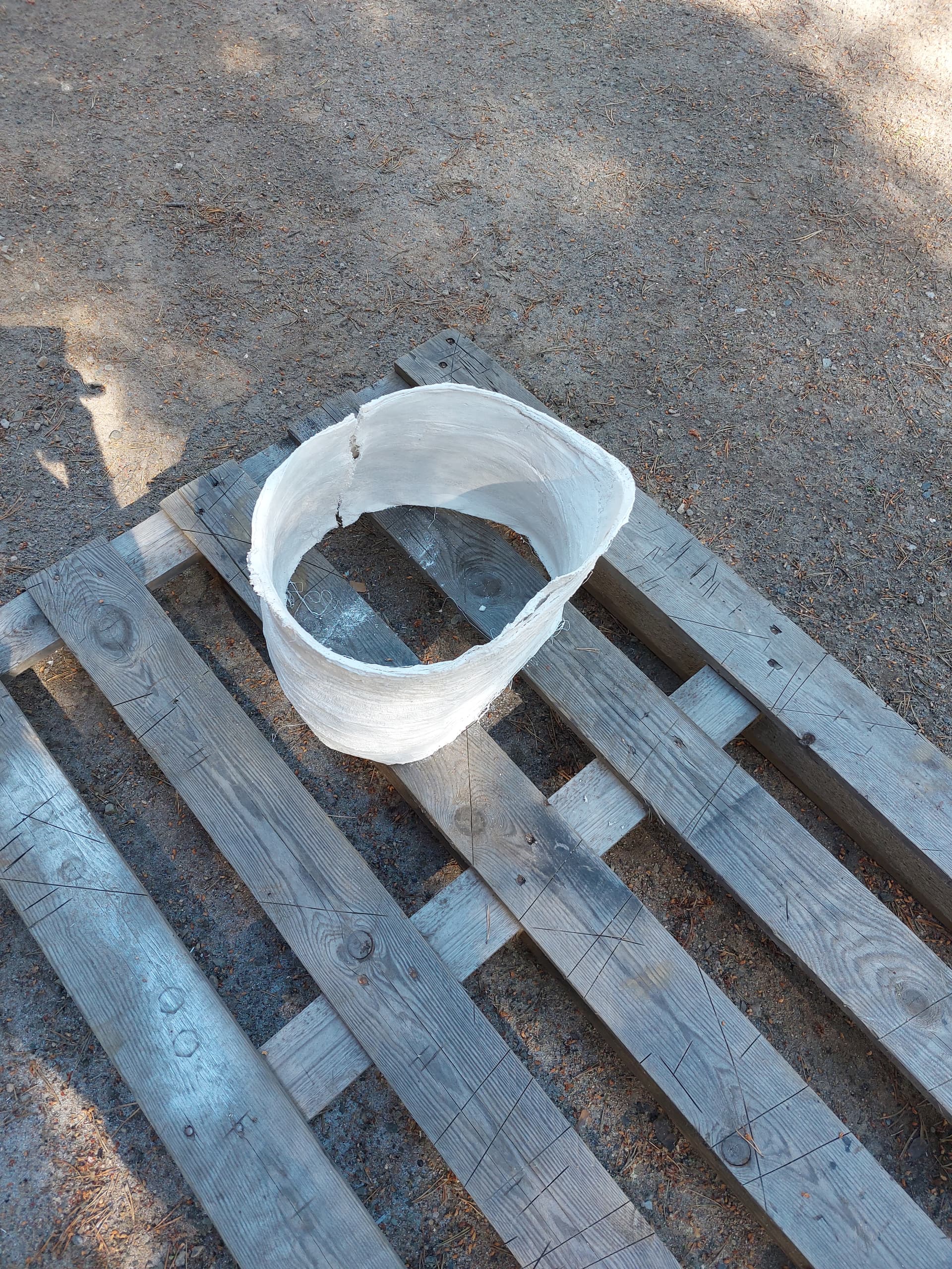

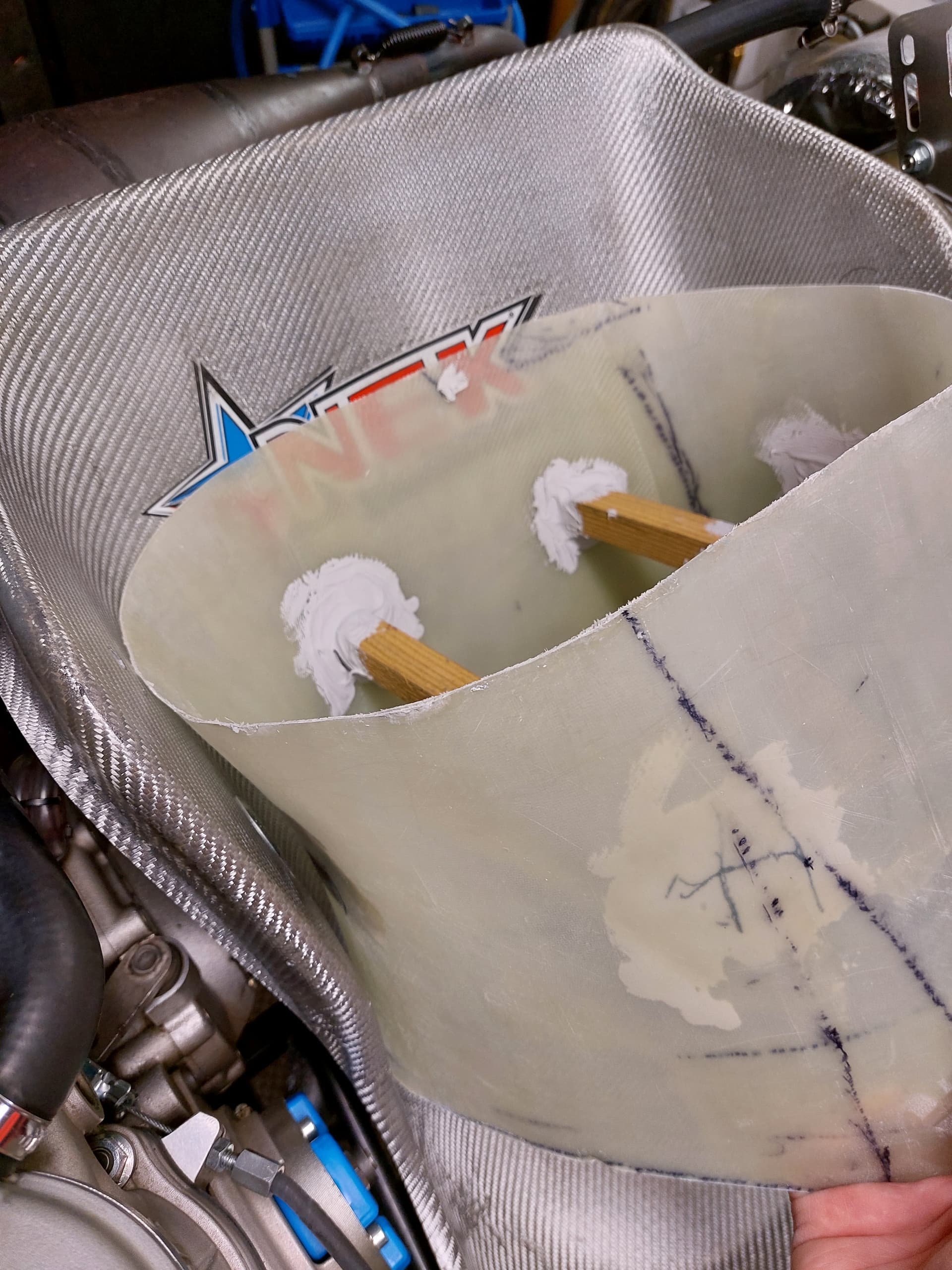

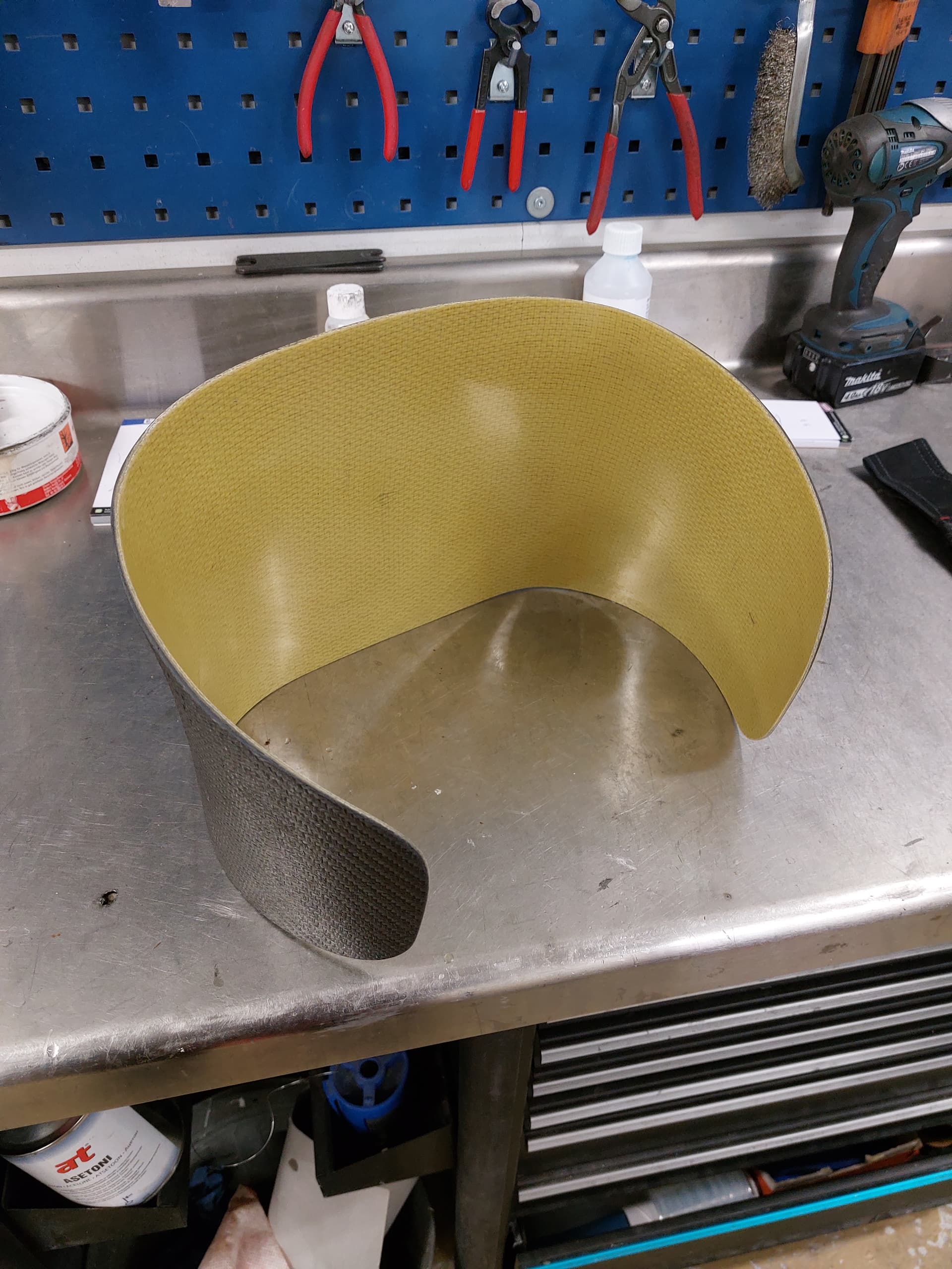

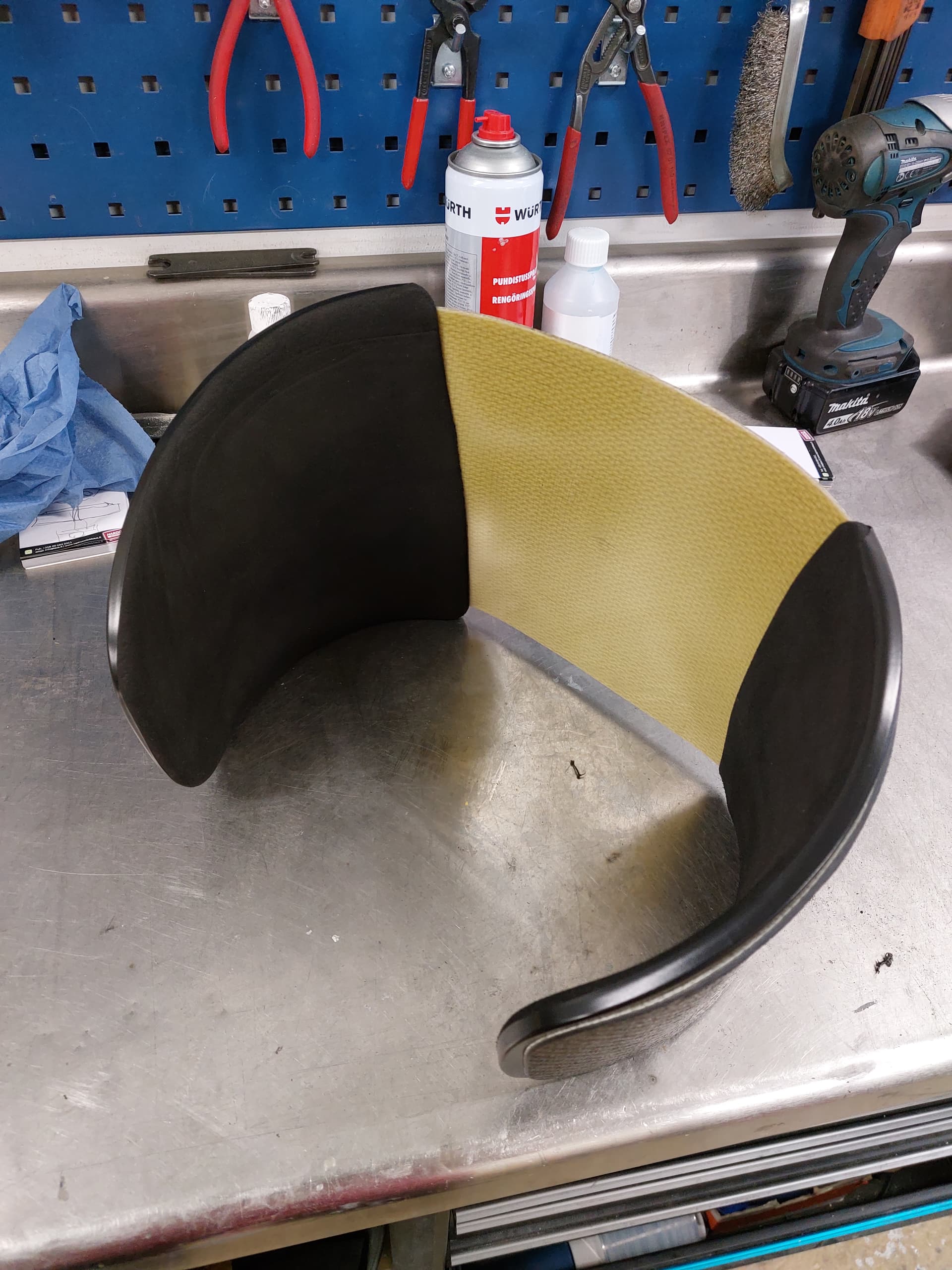

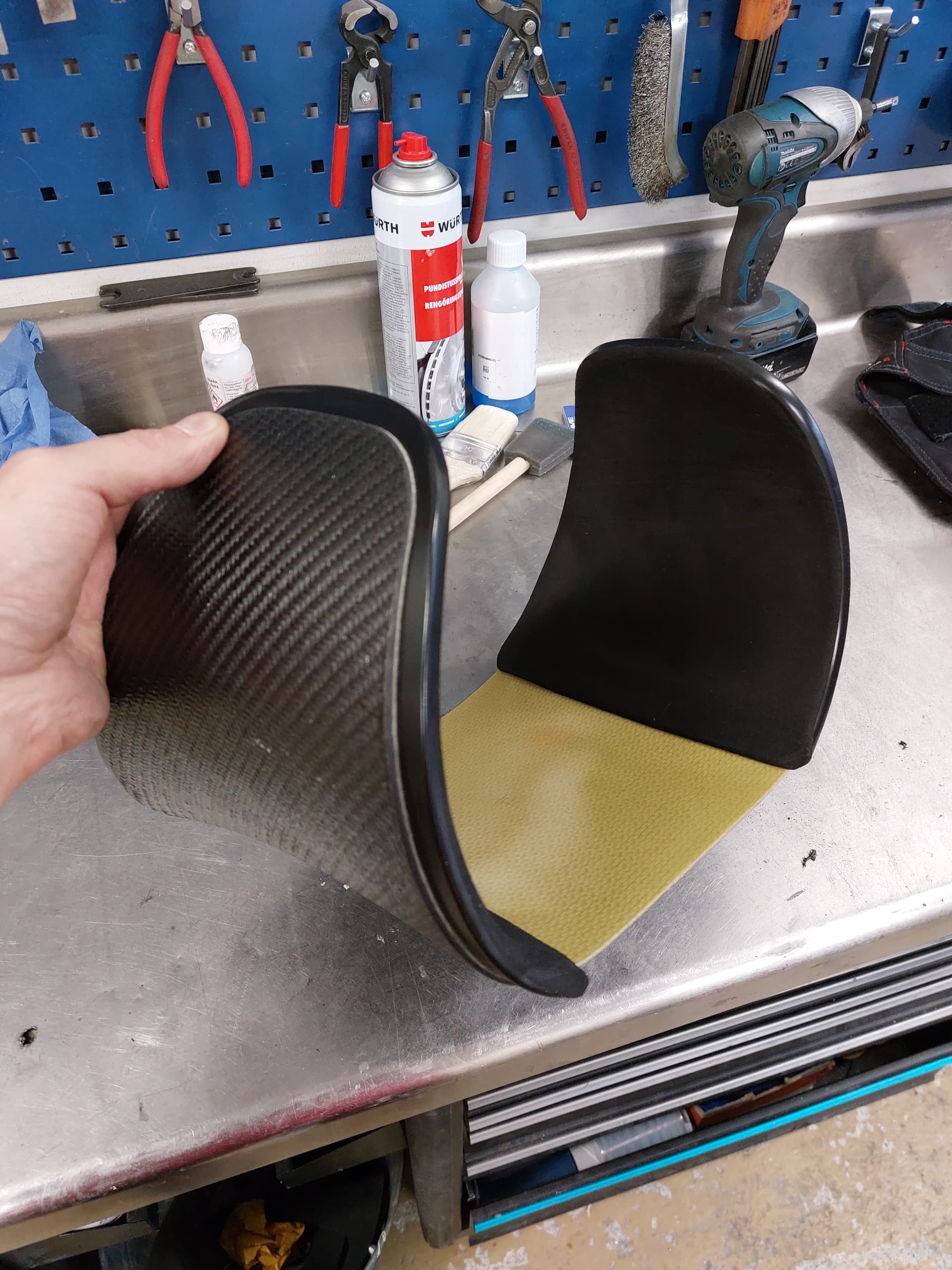

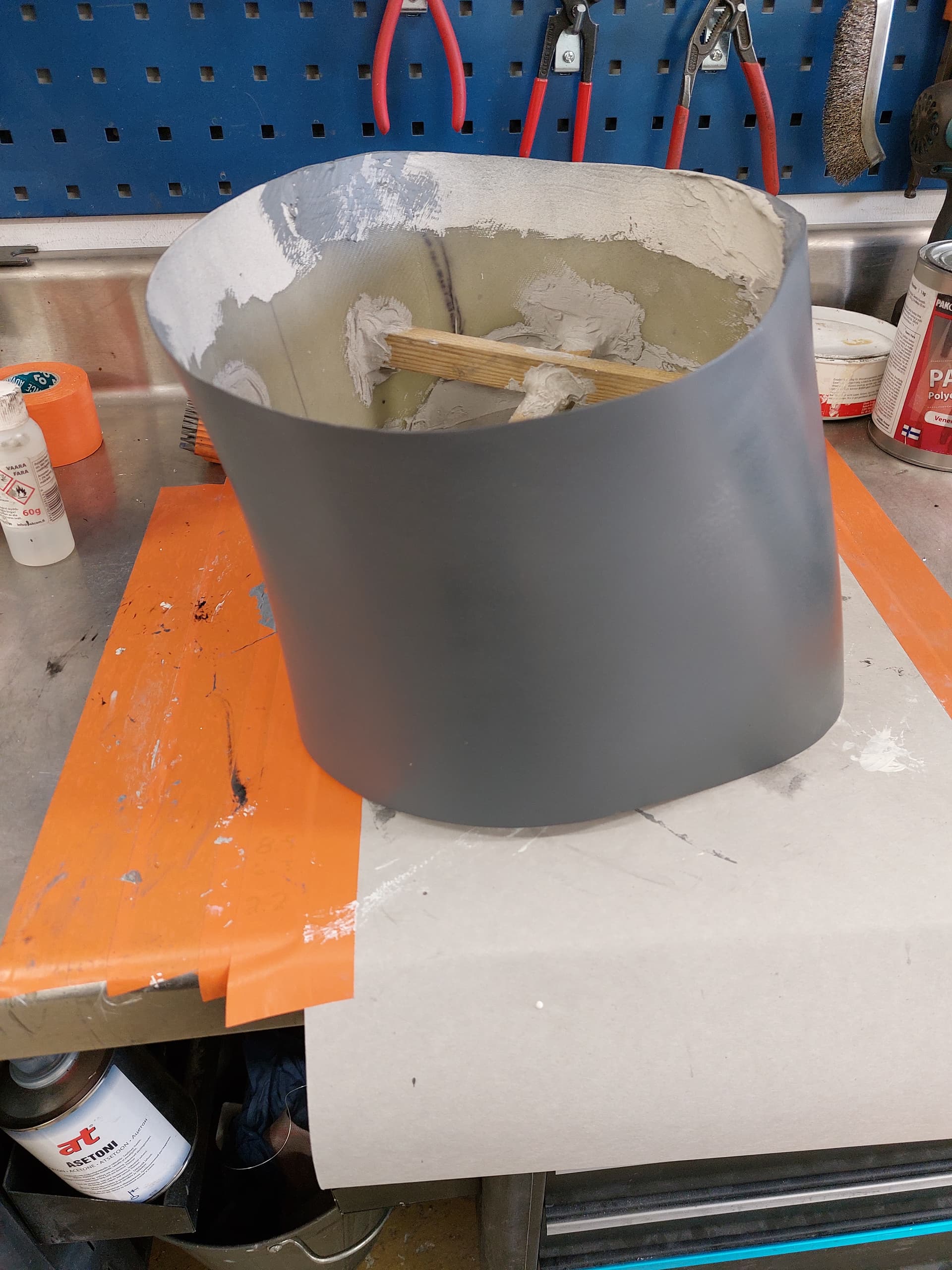

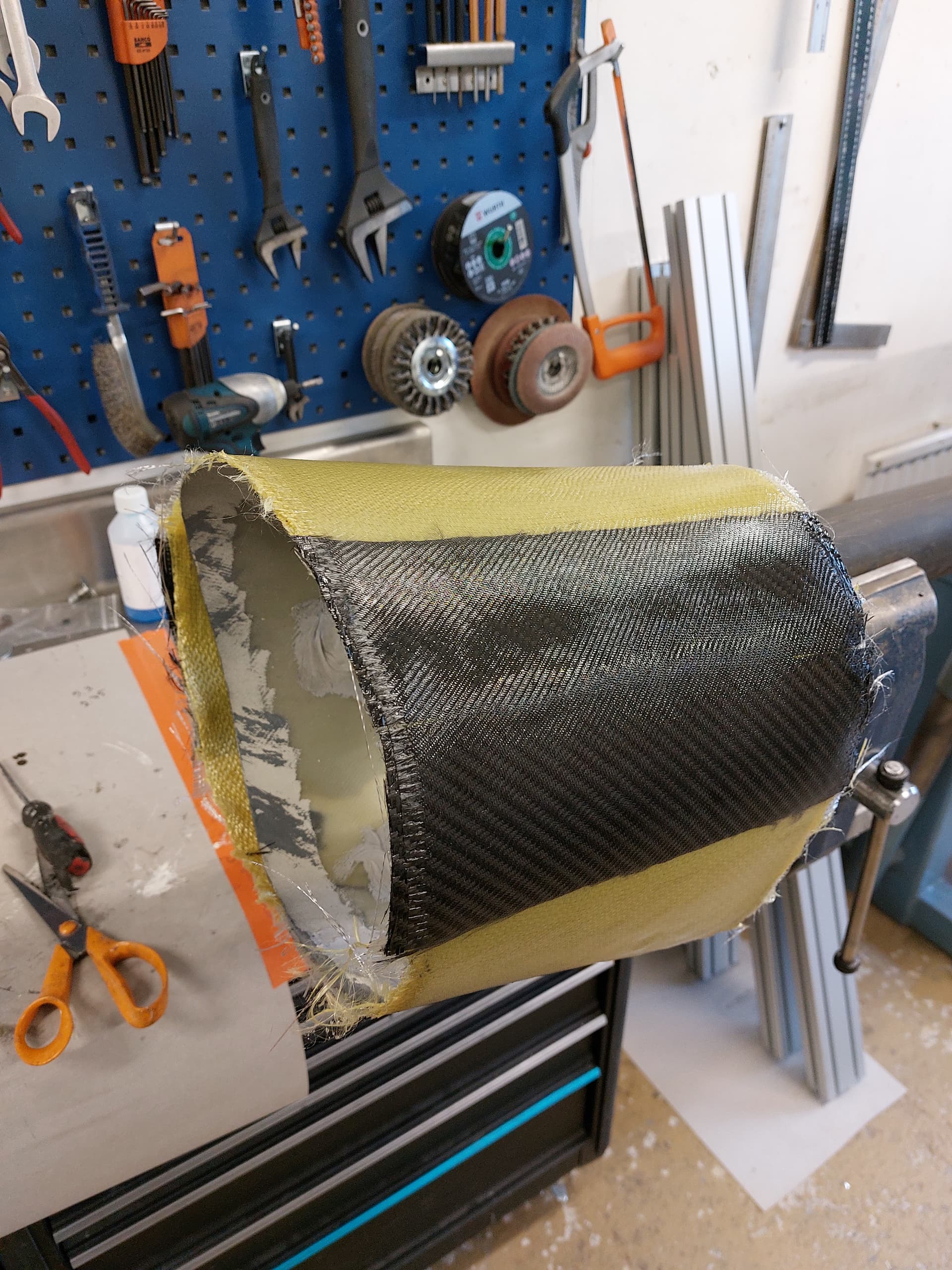

So made this - took couple molds of me and laminated it from kevlar and carbon. The kevlar was a bit too much but as I had some lying around decided to use it
The vest has no straps. It stays on as it is made to my bodyshape. It even stays on If Im driving around in a T shirt

That’s incredible, nice work.
Amazing! Bespoke fit!
So the answer is not always Bengio, it turns out!
I really would like to do this as I’ve taken this year off due to rib injury and would like to not repeat this again. What did you use for the initial mold?
Nice work. Thanks for sharing those pics.

Hmmmmm a novel submission!
Have not seen this before and it looks good.
Very happy with it, I’m around 6ft 135-140lbs for reference. (skin and bones) :rofl:
They even offer customization for some uniqueness
Awesome work! Inspiring even…
I am kinda oddly shapen, so I struggle to find gear that fits me. I’ve considered going this route, but always got hung up on how to pull the pattern/mold off of me. I’d really like to hear more about your process if you’d share.
Curious too, is that rubber edging material bonded to the edges of your foam? Looks really clean and I bet it will keep it from chunking out.
