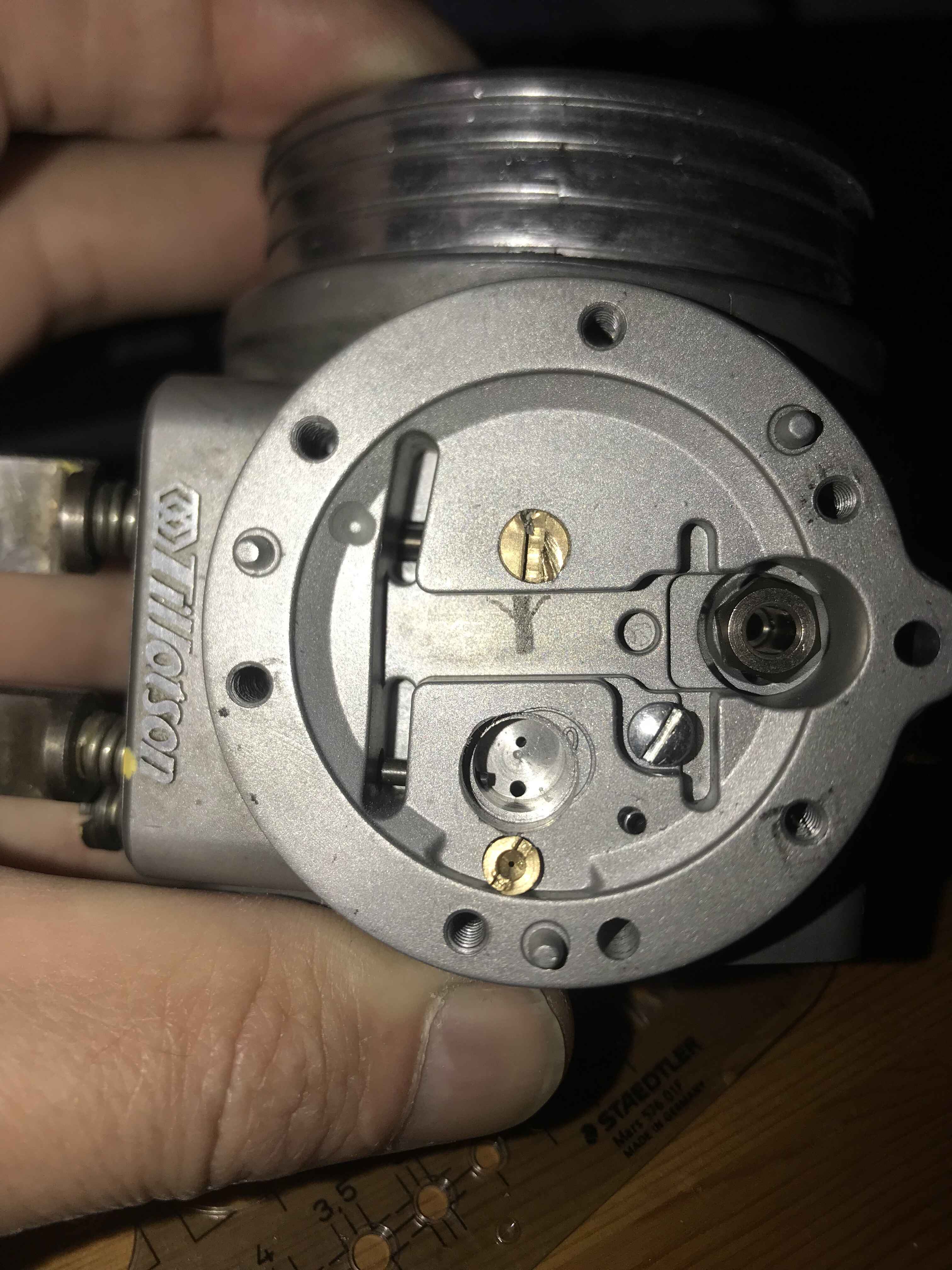

Never knew that Tillotson might have issues with cornering :open_mouth: I have thought that because theres no float flapping around its impossible to have problems. Good you brought up your experiences :+1:

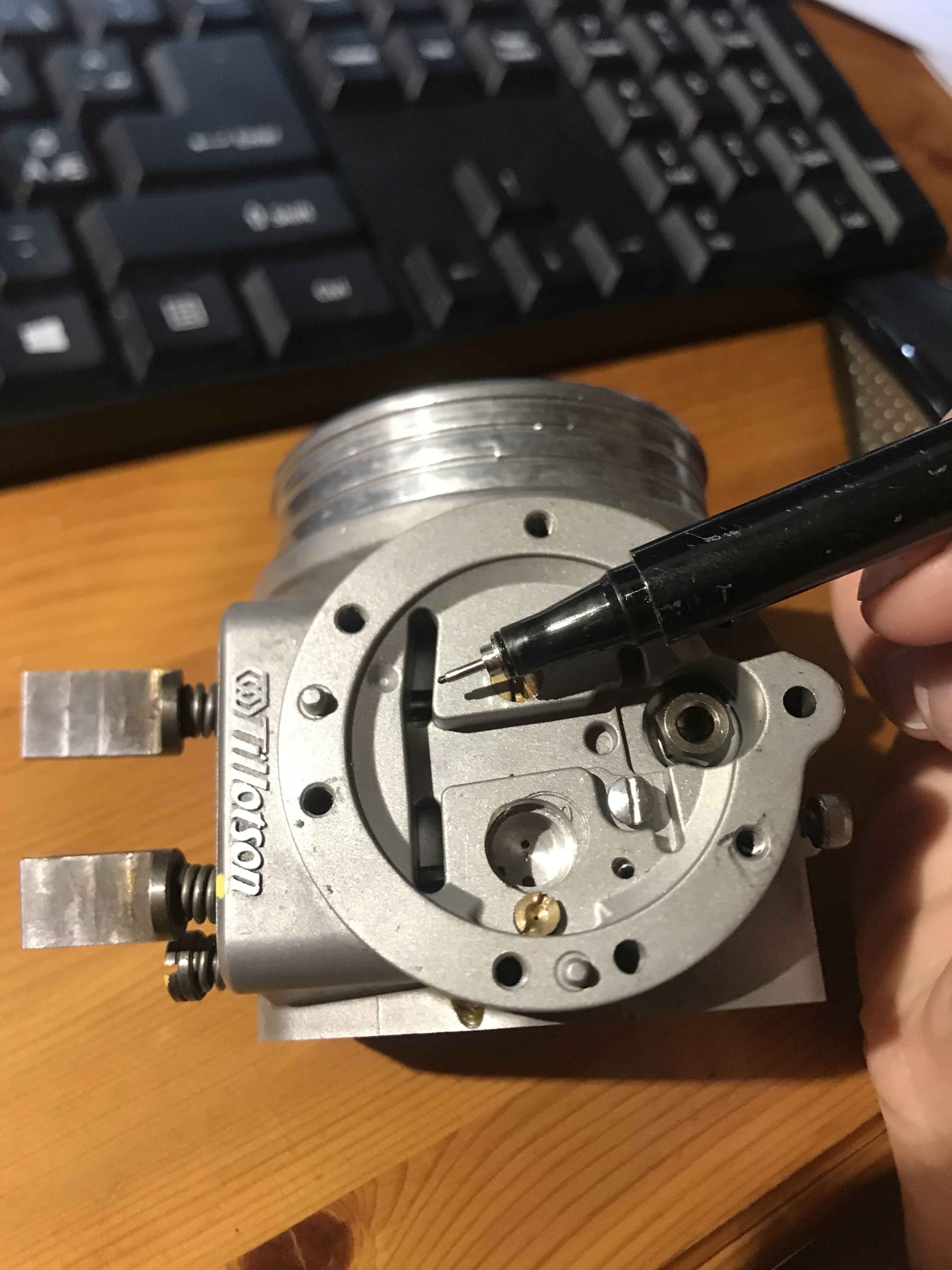

Since you mentioned its happening while cornering to the left - I suspect the fuel gets pulled out of the slot thats on needle side. That slot feeds both high and low jets. By quickly shifting to 4th the rpms drop - the motor doesnt need as much fuel as on lower gears so it is able to run with what ever is left on the slot :man_shrugging:
Im not sure is it the reason but I would test it by doing something that limits fuel getting out of the slot. I would try by gluing a piece of metal sheet with epoxy - a fence to the wide channel. Tillotson has secured some planking plugs with epoxy so that should work just fine. I drew an example to the channel with a marker. Like a baffle thats used, for example, in oil pickups in race and rallycars
I would leave a 1-1.5mm gap between fence and the channel so fuel gets in and out but not so quickly. Just to see does it help - does it cure the problem on left hand corners. The gap shouldnt need to be larger as tightest point in fuel delivery is the needle valve hole. And its already supplying fuel to the aux fuel bore via throttle shaft. If the baffle doesnt work just pry the piece off. Having a lambda would tell right away is the engine running lean or what

Thanks a lot for taking the time to explain as well as the photo. I’m thinking about what you’ve explained and it’s definitely worth trying, just to see what happens, if it works I owe you a beer or two :beers: for sure making the Low richer doesn’t work, I’ve tried a billion times and the engine just has no power on all corners, even a tiny bit richer is noticeable, it wasn’t so sensitive with the X30 engines, I’ve had a few of those, this 175cc is more challenging.

I think in most tracks the Tillotson works fine, but sometimes it doesn’t. The track I go to goes uphill and downhill, and that’s when I get that issue, I have to shift very quickly from 2nd to 3rd and on to 4th, as I previously said, once I’m on 4th it’s perfect, and it’s always turning left :man_shrugging: Turning right it’s no problem, I can rev 2nd and 3rd as long as I want to, plenty of power there :man_shrugging: We’ll see what happens with the Dellorto.

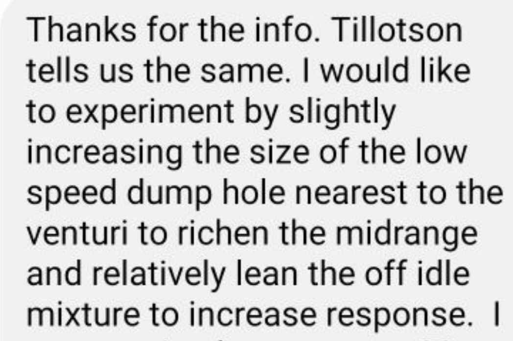

A while ago I exchanged a few messages with a guy that I believe is quite familiar with the 175, SRS Engines, I believe he’s in Texas, let me find the message he sent me and I will upload it in a few minutes. Let me know what you think please.
Yeah that’s John Sefcik I think? Very well known tuner. There’s actually some 175cc (SKUSA Spec) dyno charts from him on the forums here.
Yeah, that the guy, John! Very helpful, here is the message he sent me
