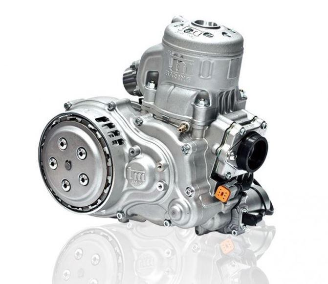

I looked hard at the SSE, but I went with the KZ10ES instead. A critical aspect concerning engines local support, & since I’m in the land of Italian Motors USA, which is all about TM engines in their service & track club class structure. This thing has an equivalent rebuild schedule to the CR moto engines or the SSE, primarily due to the ignition rev limiter.
Since I already have its ancestor, the K9ES, there was a familiarity aspect, & the ES version of the TM KZ engines kind of sold themselves to me back when I saw a prototype in 2006. I really like the battery + starter over push/stand spin starting, & the higher durability/lower maintenance schedule was just the ticket. The Euro SS has that, but sticks with the float carb. The SSE is still old school push/spin start, which is part of what kept me leaning towards the TM. But the SS/SSE do have the lower maintenance demands.
So, IMHumbleO, reliability is important. Just be sure to factor in local engine support.

TM KZ10 series has a 22mm bottom end bearing. They originally started putting it in K9ES as part of the goal to up durability, then carried it to the rest of the line with the KZ10.
Honestly, the ES is a great engine. Slightly less output than a full on KZ, though it’s plenty sufficient for the club & maybe even regional level events. I doubt it would be a noticeable disadvantage vs full KZ, especially on more technical circuits. The return is a rebuild schedule on par with CR moto engines. Based on consumed fuel volume, top ends get a refresh at 100-140 L (26-37 gal), & bottom ends at 400-440 L (105-116 gal).
