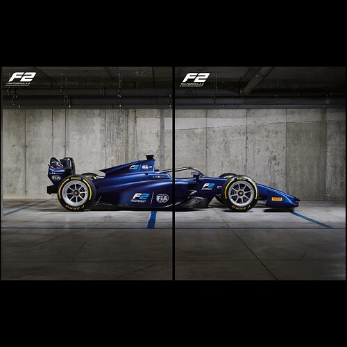

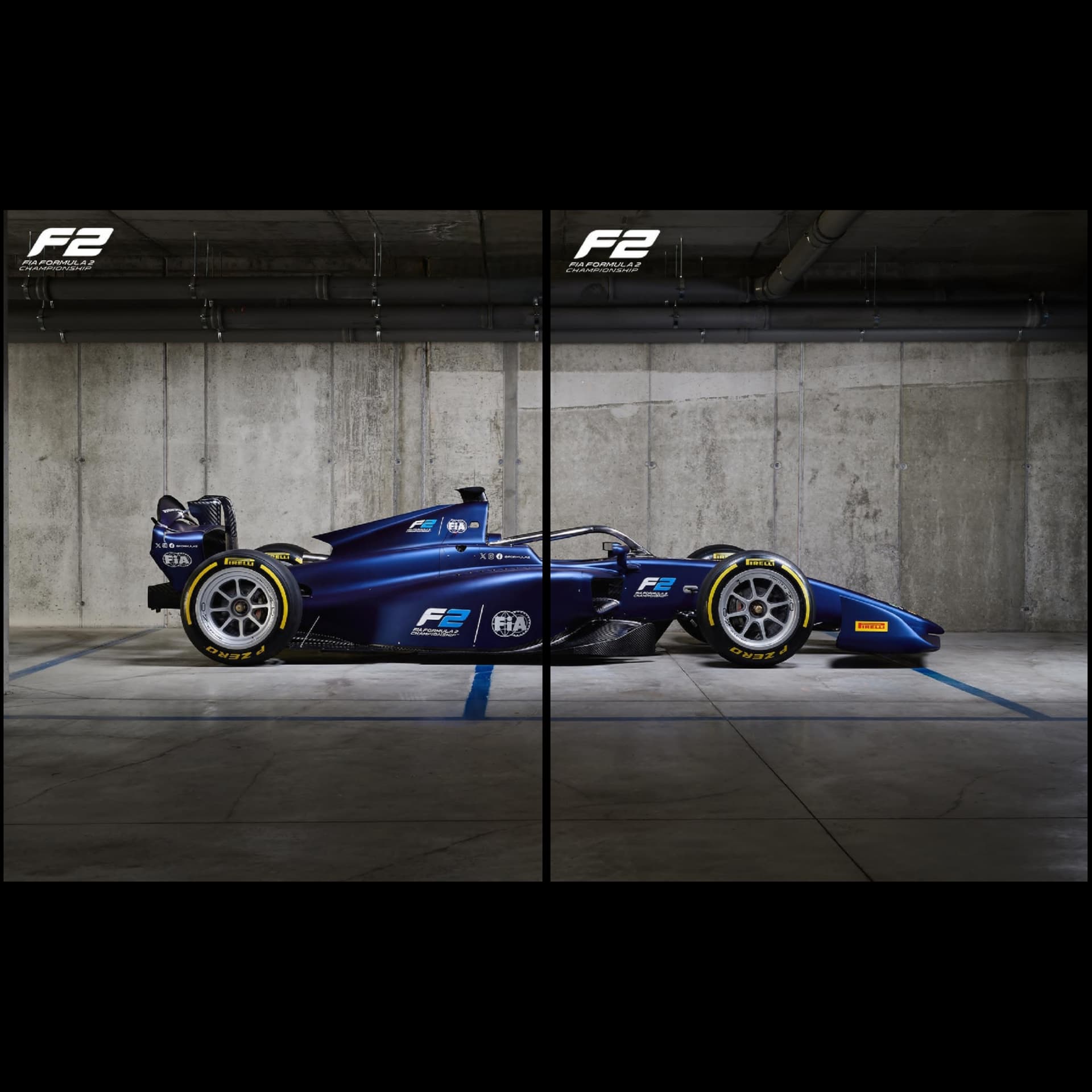

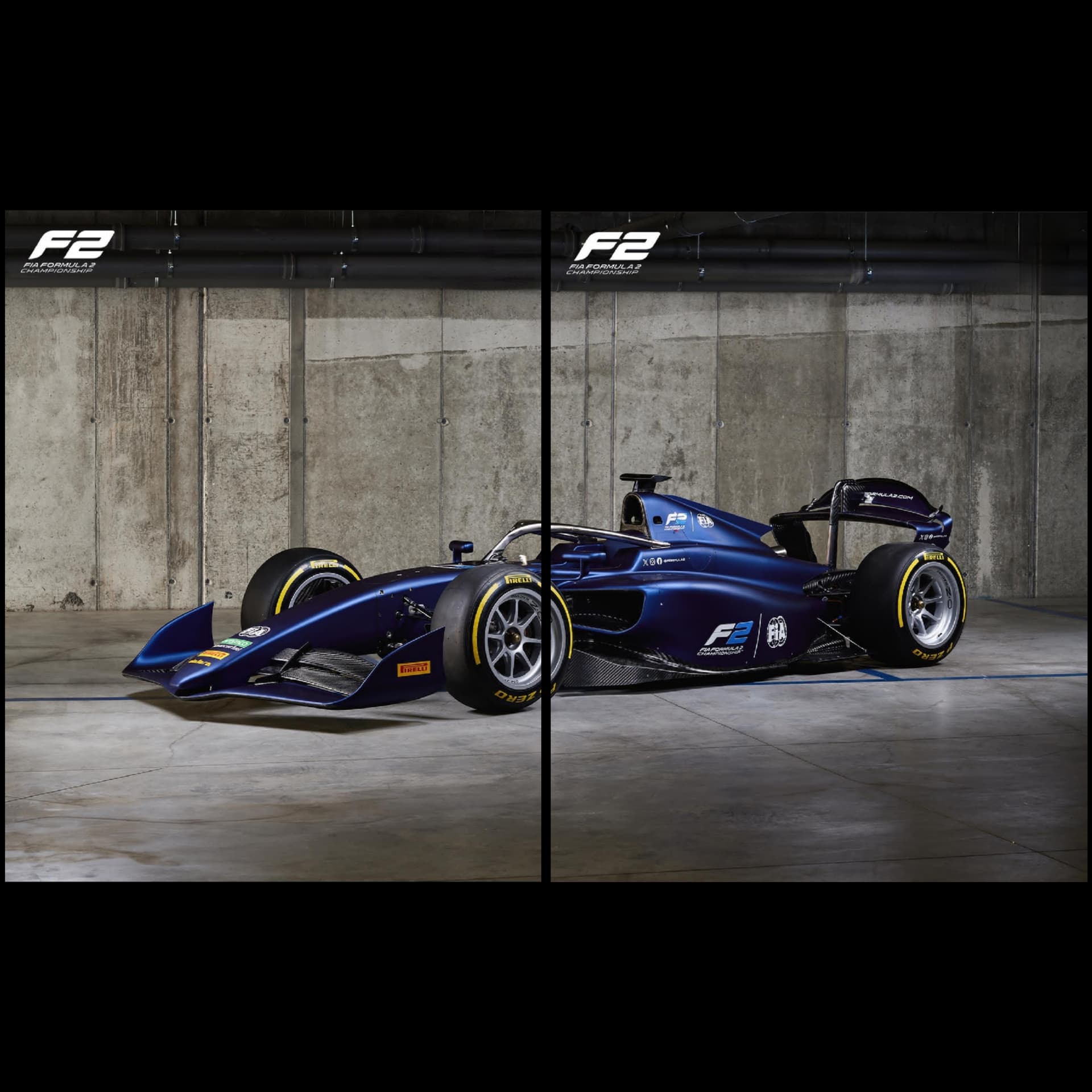

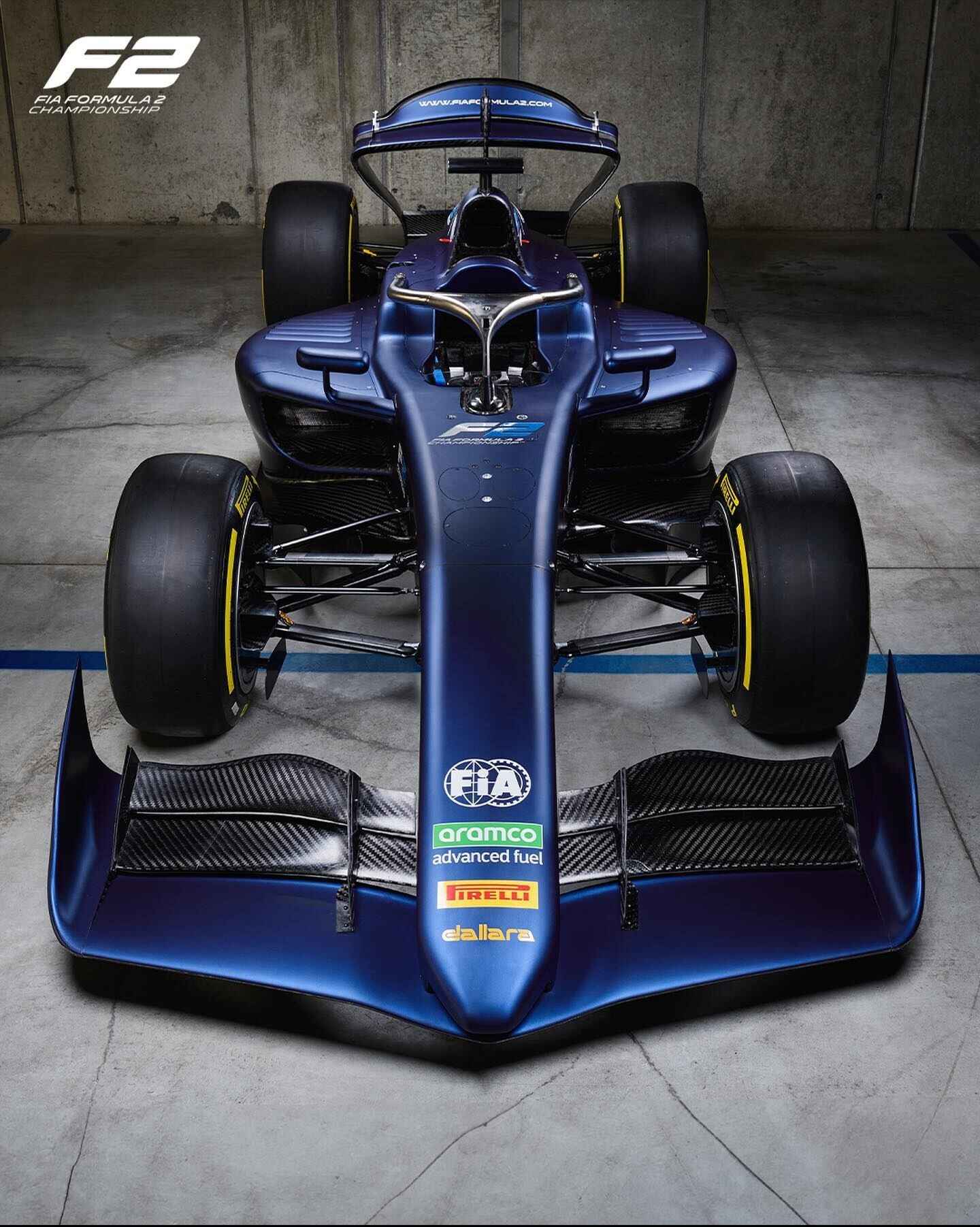

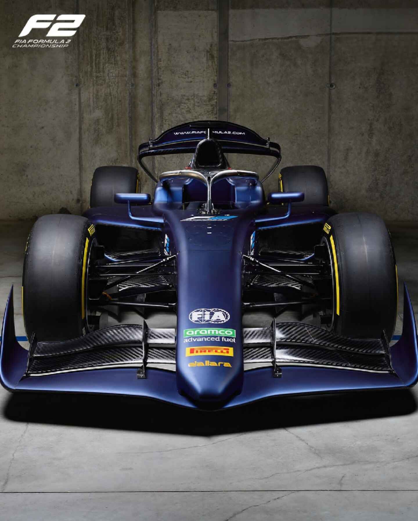

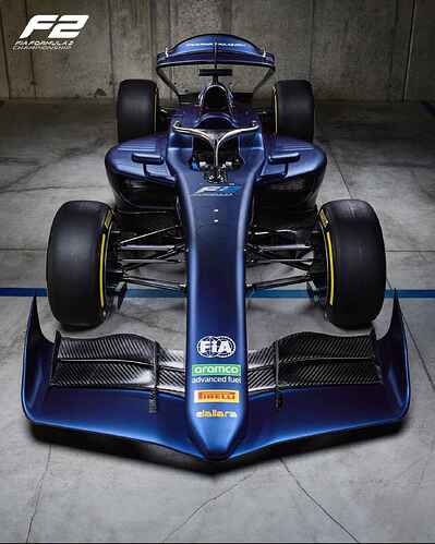

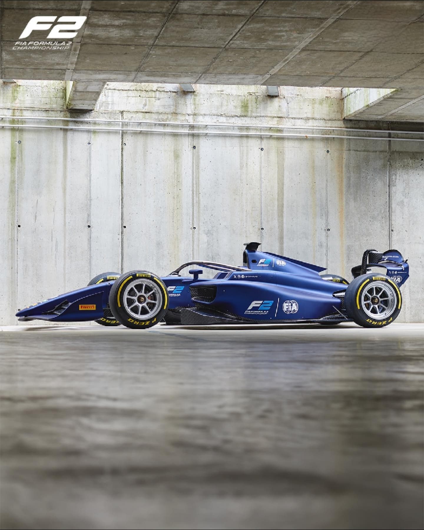

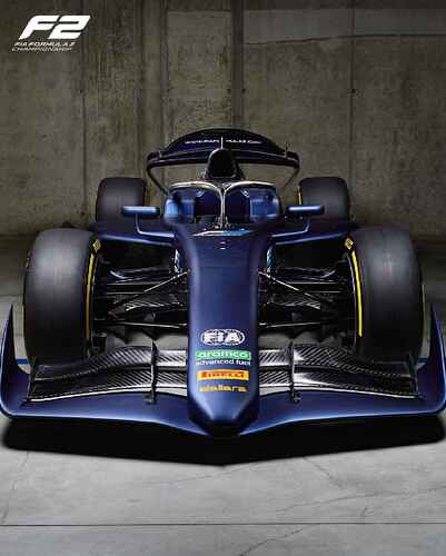

Just saw the f2 got the new chassis for 2024. Looks like the super formula or formula nippon. Wing looks gorgeous to me.
That F2 car looks pretty rad!
We could maybe irace this soon.
Yeah I love it, looks awesome.
