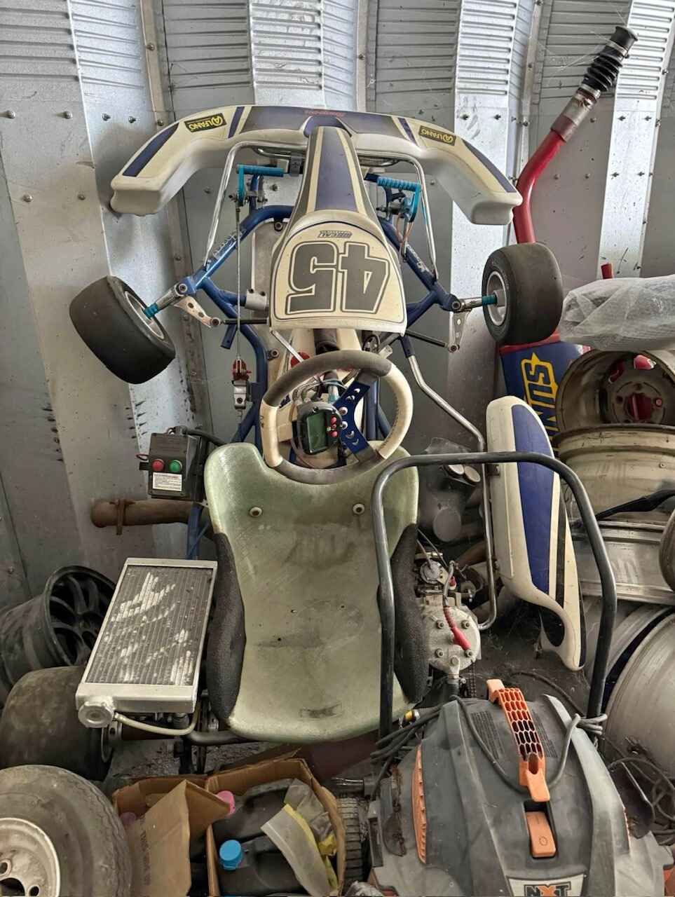

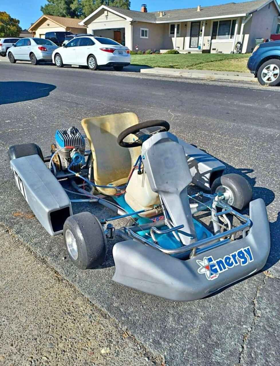

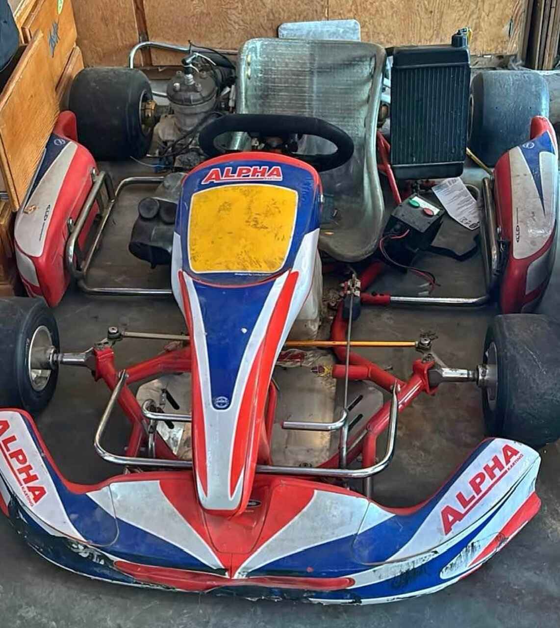

In my mind (which often leads me astray) finding a decent chassis that is reasonably straight with good welds and brakes and then a brand new L0206 for $2,200 or so seems to be the best route? Here are some examples I am seeing, all of these are in the $1,000-1,200 range.
I would agree that option 3 is your best route. However, you might want to spend a bit more for something newer. The three options you have pictured might be okay but they are old and all have older motors that don’t have much resale. Chassis parts might become scarce and it might cost you more in the long run. You may want to visit your track and ask around if anyone is selling. If you live where racing ends for the winter, you may find more karts at the end of the season if you can wait.
Just be aware that it can be a huge pain in the ass to mount a Briggs (or any 4-stroke) on many older 2-stroke chassis. The rear cross bar location on many older 2-stroke chassis doesn’t leave room to mount the 4-stroke motors with the inside rear sprocket location.
Of the karts you pictured, I’d guess that might be the case with the Energy kart and that #45 kart, where the front sidepod bars come out at an angle (around 20 years ago that changed).

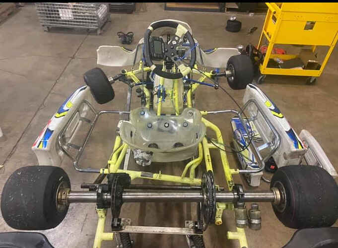

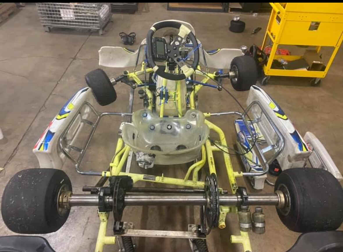

Well…I guess I need to eat my socks. A 2014 Birel with an L0206 just popped up for $1,200. It is “track ready” and while I don’t know that I’ll be able to get to it first (it’s a 2 hour drive and I can’t go until the weekend) it seems to basically be exactly what I’m after.
I personally prefer a 2 cycle chassis for 206. You may have to invest in some mini gears depending on the kart.
The guy just sent me a few more photos including the model stamped on the chassis. It is an RY31. https://michianaracewaypark.com/wp-content/uploads/2020/06/howto-gobirel-RY31-Baseline.pdf
