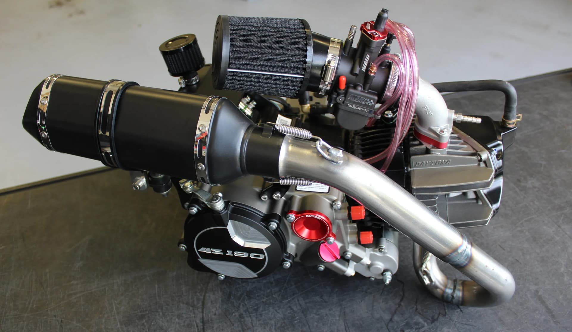

4Z190 Four Stroke Daytona Based Shifter for Karting
I’ve been following the project for a while, but it was hard to get actual pricing on it. The page is a bit confusing to me in terms of spec at given dollar point, but I’m easily confusted.
Just today I noticed a package on a website that gives an idea of the cost. At 22HP (Karting spec might be higher?) it’s somewhere in the order of 80cc two stroke performance with a five speed gearbox.
Maintenance intervals, on the Ohvale equivalent it’s around 50hrs between top end service (Valves, springs, Piston) depending who you ask. Bottom end about 100Hrs.
https://4z190.com/ols/products/daytona-4z190-racing-engine-package/v/4Z190-COMPLETE
Base Engine. $2,299.00 (I don’t think this includes exhaust or engine mount).
4-Stroke, Single Cylinder, Air Cooled, 4-Valve SOHC
- 62mm Bore x 62mm Stroke
  • 5-Speed Transmission
  • Electric Start
  • Auto-Decompression
  • Base Engine Spec (before 4Z190 upgrades): 12.1:1 Compression / 22hp
  • Comes with CDI, Ignition Coil, Relay
Full Karting Package: $3,799.00 USD: Odenthal Motor Mount, 33mm Carburetor, 10mm Intake Manifold Spacer and Pulse Fitting, Trackmagic Magic Can, Air Filter, Exhaust System, Oil Cooler System, Oil Catch Tank with Breather Line and Air Filter, Wire Harness with Start/Stop Panel, Ignition Coil Ground Wire, Custom Clutch Cable, Throttle Cable, and Shifter Arm.

I’ve followed along quite a bit and they’ve made upgrades to the engine along the way to get it to where it is. Comes with a slipper clutch now for one. They’ve been testing a new billet shift drum to change the direction in which the shifts happen as it was backwards if you hooked it straight up. Lots of little tweaks to get it better for a kart.
Take my money and 20 character$
It looks like it is air-cooled like a 911 used be. Basically with a large oil cooler. Does look like fun.
It is definitely air cooled. They added the oil cooler at some point to help with reliability.
“It is definitely air cooled. They added the oil cooler at some point to help with reliability.”
Sounds like 911 to me.
Yeah actual “air” cooling capacity is pretty low on these engines, an oil cooler is essential
