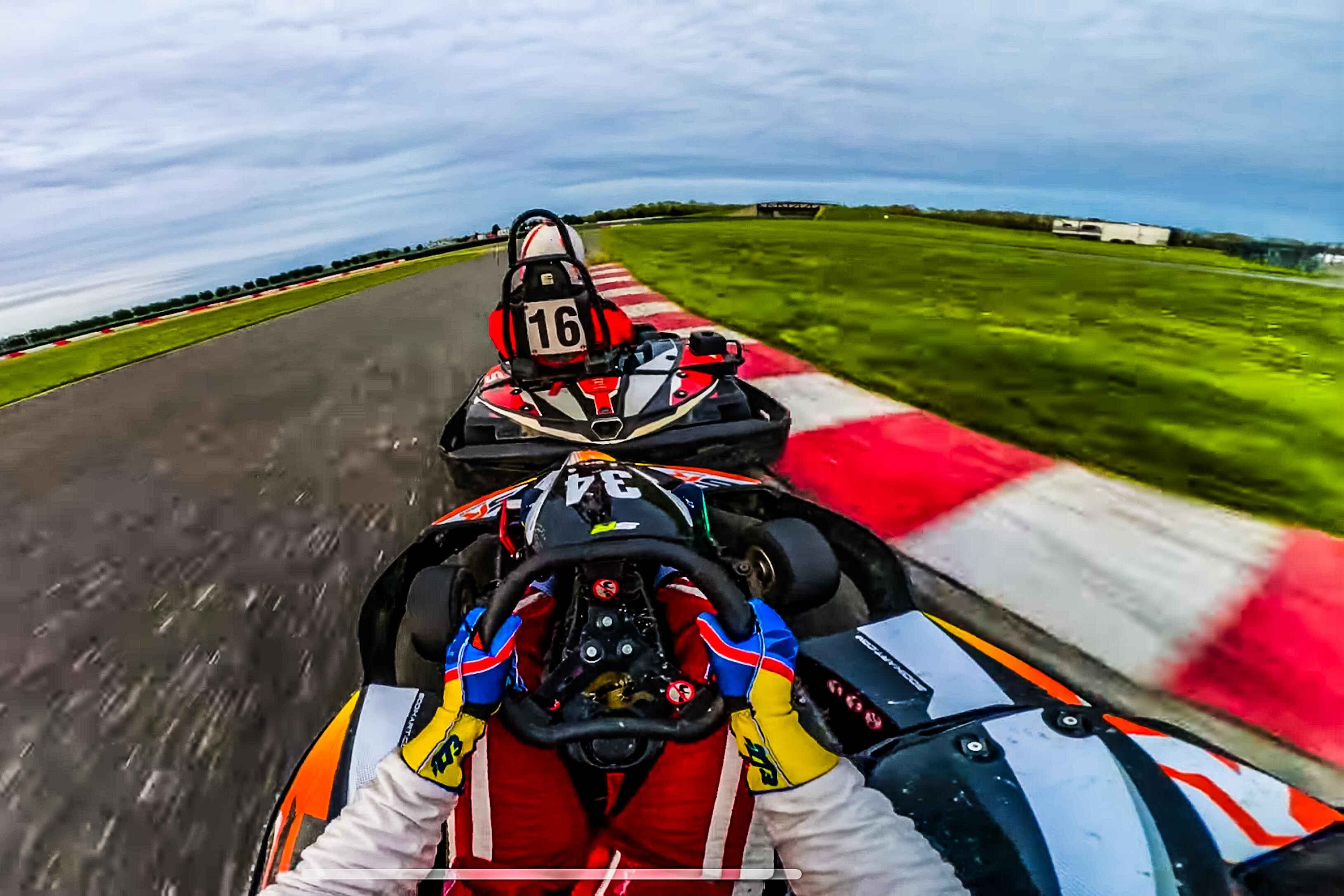

1: probably the big kahuna of these turns. It’s a fast corner, at the end of the S/F straight. It also has an unusual little bend right before the turn,that messes with your perception of the approach.
The turn requires you to do a direction change at the end of straight to access the braking zone. This is flat. You do not lift, you just turn at full tilt. Be reasonably gentle since you are hauling butt, prolly 45+. In draft maybe 50.
The approach is as wide again as you can make it. Hug track left edge. The asphalt gets a bit wonky as you get to the direction change, a little gravelly on the surface, on the outside edges of the track.
Here I work with a guy and we get through a pack. He makes a hole for me as I give him extra juice. Alas, the train jumps the track a bit and he falls victim while I drive on. That’s sort of the point of being behind a guy… if you ride their butt they will eventually make a mistake or get caught up in someone else’s problem. Profit!
You are gonna now hug the right edge, since you navigated the turn from straight onto braking area if t1. To your kart right is the red and white kerbing. The very end of this is your braking zone. You’ll notice the dirt is ground up around it towards the end. Initially you will brake too early. Push it deeper, towards end of the red/white kerbing, holding right side….. then turn for the apex. The hard part is the entry, the rest I’ll let you experience first.

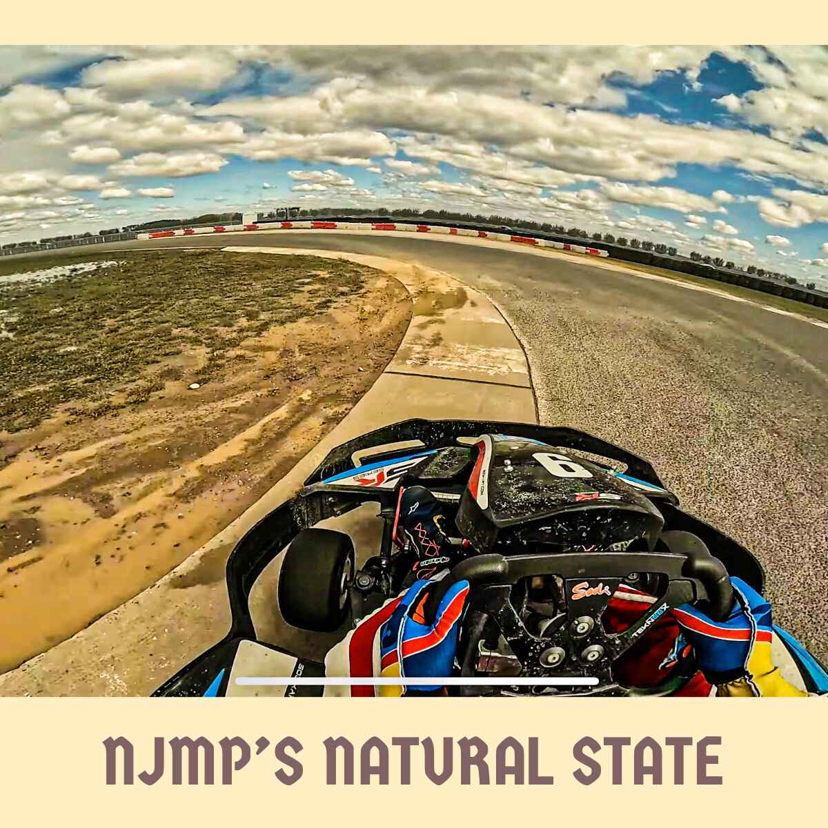

South Jersey is coastal and features sandy soil. It gets swampy when wet and drains slowly
T1 and T3 apexes collect water. The water creates mud which gets splashed on the racing surface. Zoiks! Apologies to the guy I punted trying to make up lost ground.
Common newbie mistake is to let the track fool you into taking 1 too much from the middle track since the track tricked you with the zig on entry. Hold left edge down straight to give you a nice wide fast arc to sweep across to the right edge of t1 braking zone.
