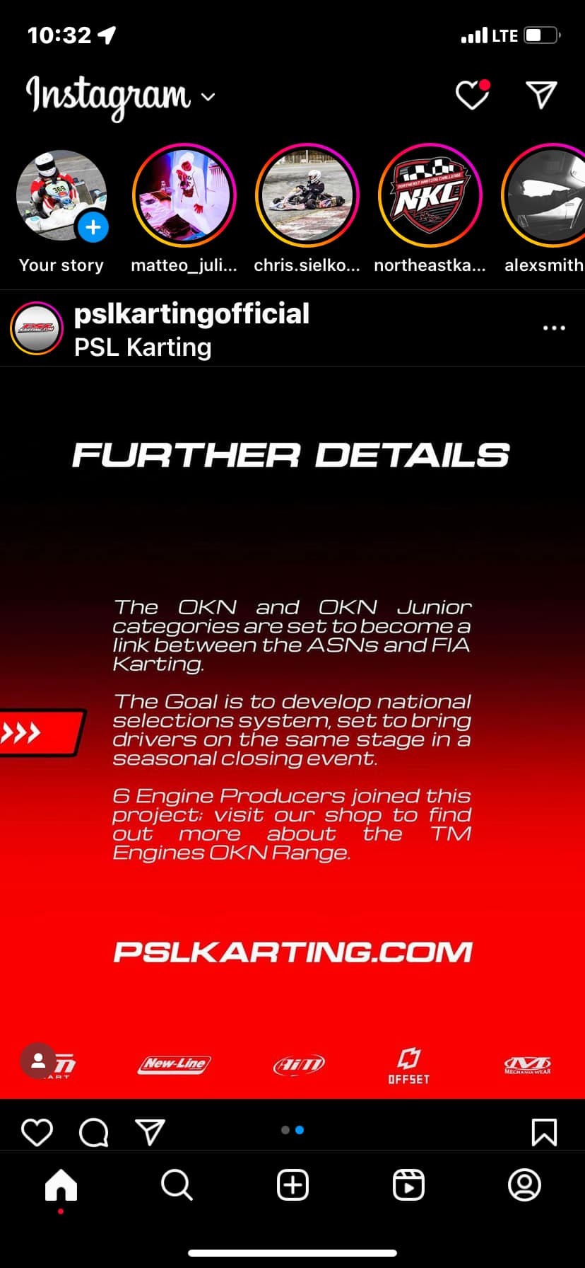

What is an ā€œASNā€?
AutoritƩ Sportive Nationale (National Sporting Authority).
Interesting to see that they are trying to bring back those engine to the national level.
