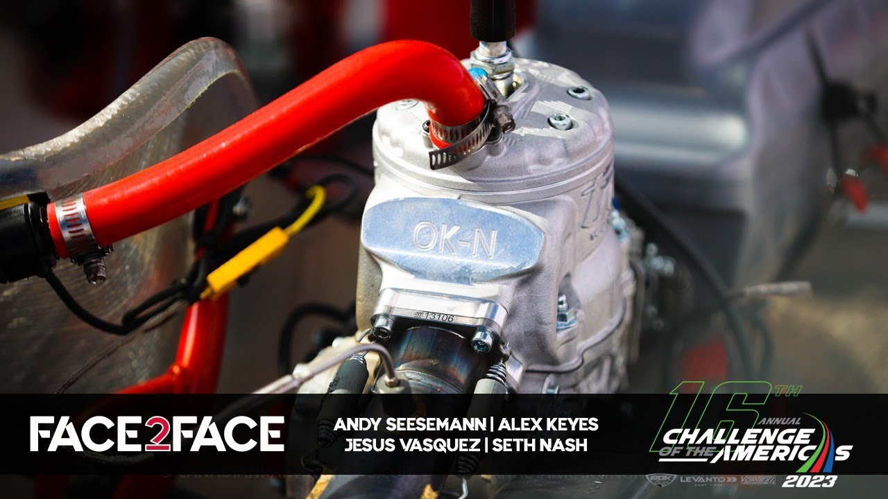

Good discussion with all actors involved in the first OK-N race stateside.
I would lie if all the nice things said donāt make me a little emotional. Even if its a tiny step, hearing the platform is being so initially well received fills me with joy.

I got a general 2 stroke question though⦠not OK-N specific.
Jesus is saying that they run VLRs up to 18k in Vegas⦠(From 26:30)
My question is⦠how can the engine make power in that RPM range if they are up to 16k without shortening the exhaust length and/or modifying the cylinder⦠Voodoo magic? ![]()
I donāt know specifically on the VLR, but the KAs spin about the same at the Rio track. You arenāt making any power up top at those RPMs, but the benefit you get rocketing off the tight corners outweighs how much you lose down the straight by screaming the engine.
The Rio layouts usually have a mix of really tight and windy hairpins with no rubber down, and one giant straight. So you sacrifice the top-end power for a bunch of low-end power by throwing a bunch of gear on and letting it basically just make a ton of noise on the straight.
Another way to view it, is to always keep in mind the hp formula, which is dependent on torque and rpm. With a reed engine you can manipulate things to get some advantage in one area without killing the other. So as long as the drop in torque is not as steep as the the increase in rpm (and above 16k rpm peak torque is long gone anyways), comparatively speaking revving higher actually gives you more power. That translates into advantage if you know how to get there without completely killing the torque curve in lower rpm ranges.
To be honest, I didnāt know VLRs were capable of those many RPMs
They donāt have to. Itās down to the track and the stopwatch. It often makes sense to give up power at one part of the track (end of longest straight) to gain time everywhere else (pulling out of turns).
That said, donāt chase peak RPM values for the sake of it either.
/edit TJ said it better.
