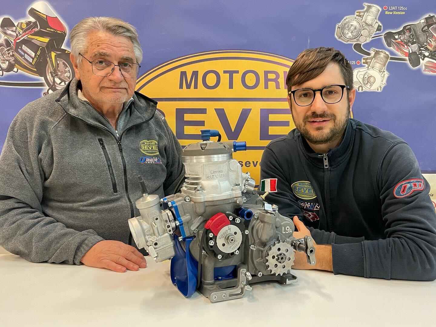

Strafing away from the main topic buuuut super clean design, compact gearbox and i love the integrated 3D printed air ram to cool the crankcase. Note how the crankcase itself has specifically designed cutouts to support it, right under the reed box. Front of engine also significantly raised by design to allow for the part to fit.
Engine in picture has their proprietary paddle shift module’s adapted shift arm mounted, along with what looks to be uniballs fixed as guides for the cables that actuate it.

Interestingly enough, Vortex tried the air ram cooled crankcase on the previous generation of their KZ engines but has gone back to a water cooled crankcase on the newest model. Guessing it didn’t work out how they expected.
Very true, although Motori Seven’s iteration has quite a wider throat opening for the air ram and it seems (i have to look at the homol fiche) that it is also water cooled, as the water inlet is bellow the cylinder itself. May be twin cooling.
Also sweet little fins at the front of the cylinder to increase surface area and cooling, much like a TM front crankcase design.
The water inlet on the previous generation vortex was in a similar location. The vortex also had an add on duct piece that bolted to the front of the engine but I never saw a picture with it installed.
I saw it during our races, many times. It was definitely less open at the throat and a little more discrete than this solution.
