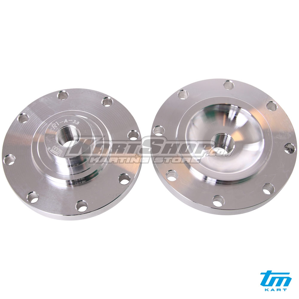

1.65 and 0.9 squish. Do you know which head and piston you have ?
I just assumed it was the stock R1 head and piston. It came rebuild from PSL
There are multiple versions/combinations. The head insert code is stamped on the upper side, you can see it by looking around the spark plug. They have different volumes and shapes and require pairing with the correct piston
Hey the # on the head is R1- A- 3.5
And the # on the top of the piston is 53-93
ok, with R1-A-3,5 you can follow 1.65 and 0.9 squish.
