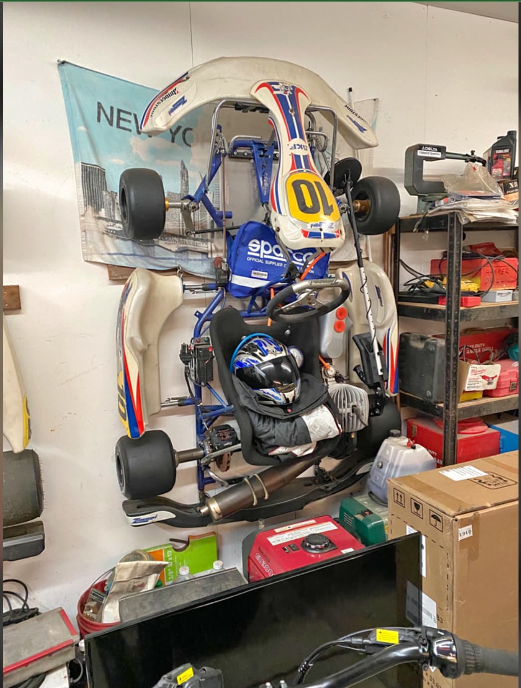

I’ve been searching for used karts and I’m mostly seeing Tag 125cc karts that look pretty beat and a few LO206 karts within reasonable driving distance. I did find a kart that is close to my parents house, but the seller is pretty uninformed. He says that he is selling it for his father in-law. The kart was advertised as having a never raced VLR on it. He told me it is a Zinardi chassis but he doesn’t know the age. Can anybody give me a ballpark age from the picture? Obviously, it is hard to tell condition from the single picture I have, but if it isn’t ancient I may take a drive to see it.
Looks pretty tidy to me and we’ll kept
Hard to tell without seeing the chassis plate on the rail behind the seat, but those graphics and Zanardi’s popularity in the early 2010s suggest to me it’s probably from that era. Could be a decent kart for getting back into it as long as it’s well-kept.
It being 10+ years old would need to be priced accordingly. What’s something around this era worth in good working condition?

From what I can tell in that photo, that chassis is probably 2010-2012 era. Those were great karts, but I would hope to get a deal on it with how old it is.

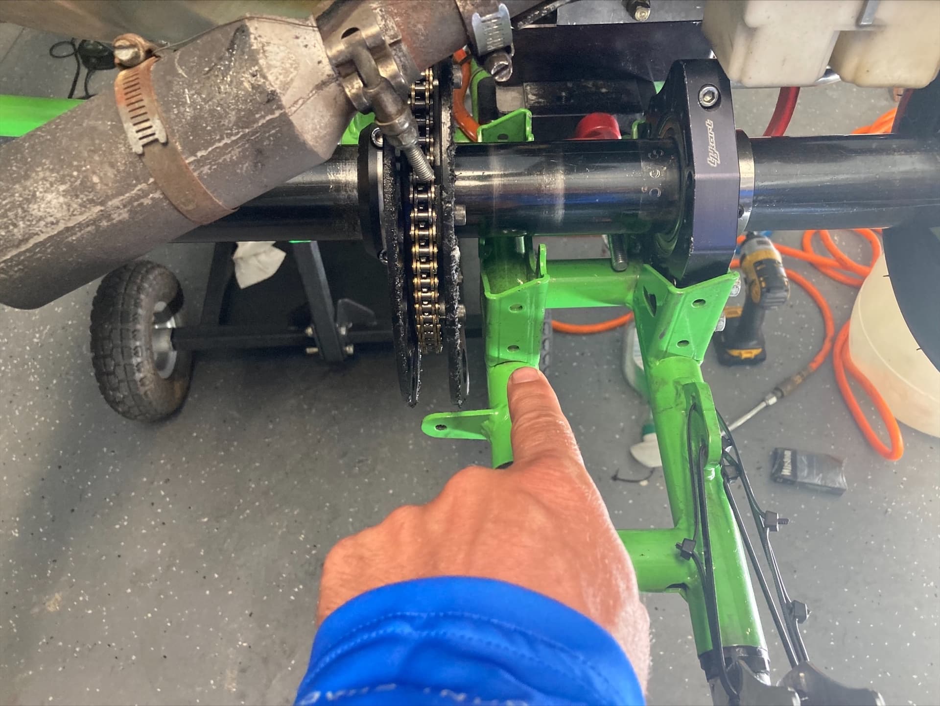

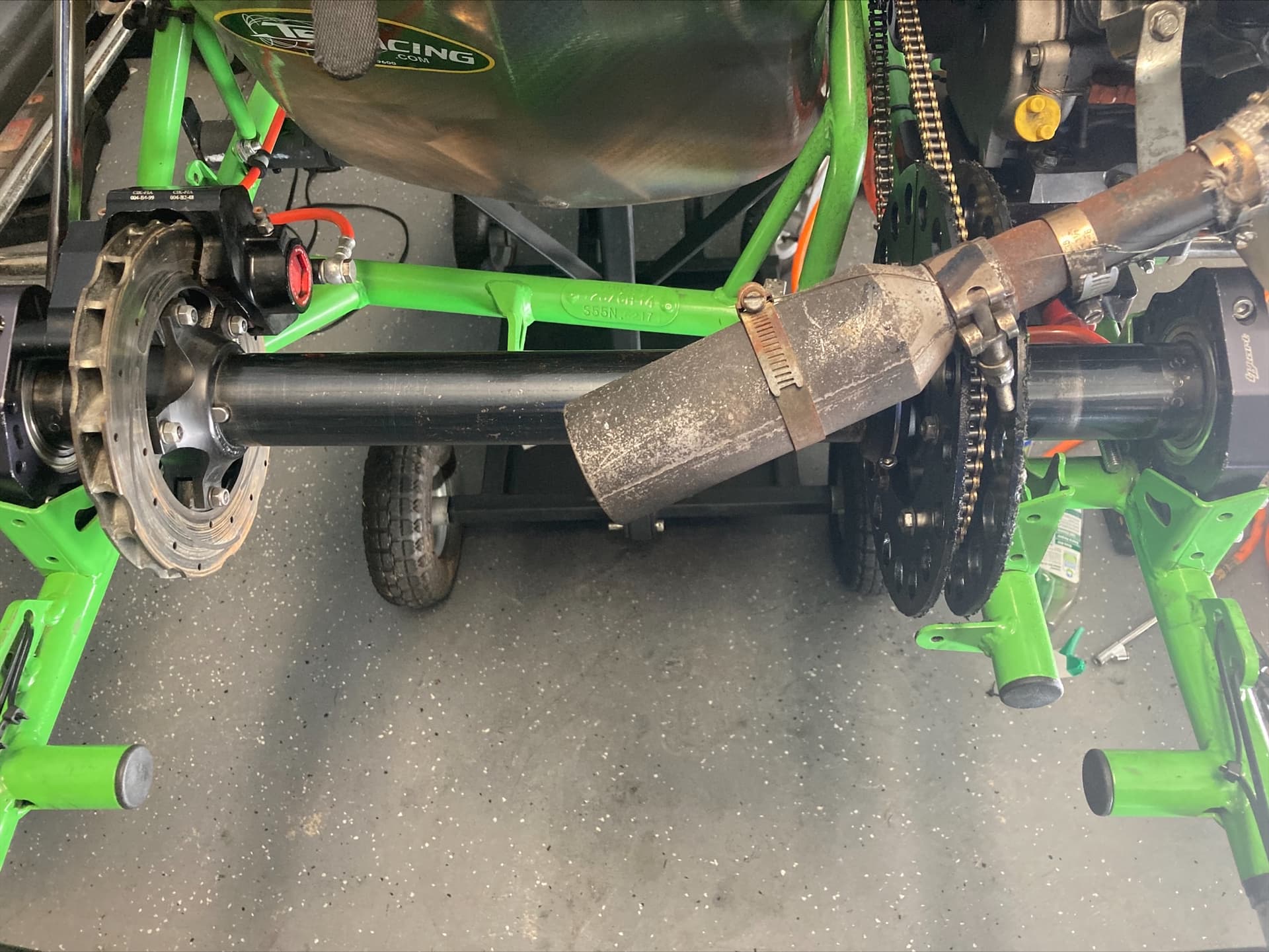

If you don’t go with this particular kart. Moving forward be sure if your looking at a “206 karts” just make sure it has a 3rd axle barring cassette, as many of the newer stuff does not. Alot of 4 stroke (206 specific) karts are not equipped with the 3rd barring cassette, and therefore can’t be used in 2 stroke.
My kart is a good example. Its a 2 stroke chassis mated to an 206. So it can be used in either if I pop my 3rd cassette back in. One of the reasons I choose it, cause it gave me the flexibility to run either.
You can use a kart without a third bearing in 100cc stuff. You could even use it in 125cc stuff if you wanted, but if it doesn’t have a third bearing, it probably is designed for lower hp.
The CompKart 4-stroke kart they built didn’t have a third bearing and it worked great in KA.
I can attest to the Compkart 4R being competitive as the leader in our KA points has one and is tough to beat.

As for the Zanardi Kart it looks very similar to CRG, can anyone verify if that is who made those karts?
Zanardi was made by CRG, that was pretty much Dino’s program for a long time as far as I understand.

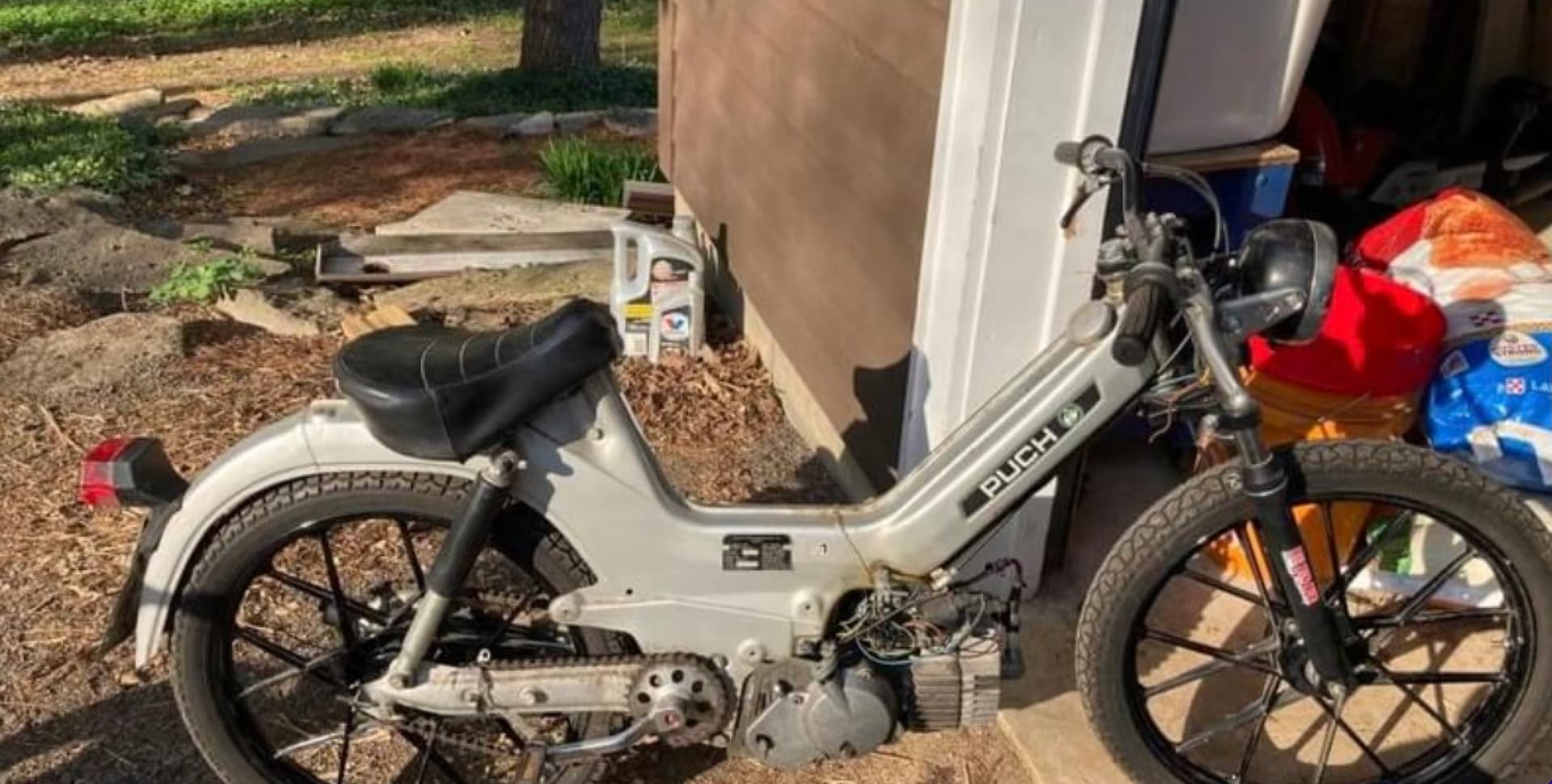

I was a broke college kid so I ran 50cc. I raced a 1977 Puch maxi with a motor I built in my now wife’s basement. It was a great time!

IN looking closer at the picture I will mention that while the motor may not have been raced, it has clearly been run. The pipe has temperature patina and there is some excess oil runoff on the end cap, both indicating it has some time on it. I would want to know how much it has been run, but more than likely they won’t know. Depending on what is included would determine the final price. Assuming the chassis looks good on the underside I would think about $2500 for the kart with a motor. If it includes the suit and helmet and that is usable maybe another $100-200. If there is an hour meter with less than 3 or 4 hours maybe a little more, but not much. Also just be aware that if this has the CRG front hubs they have a different bolt pattern than other karts.
